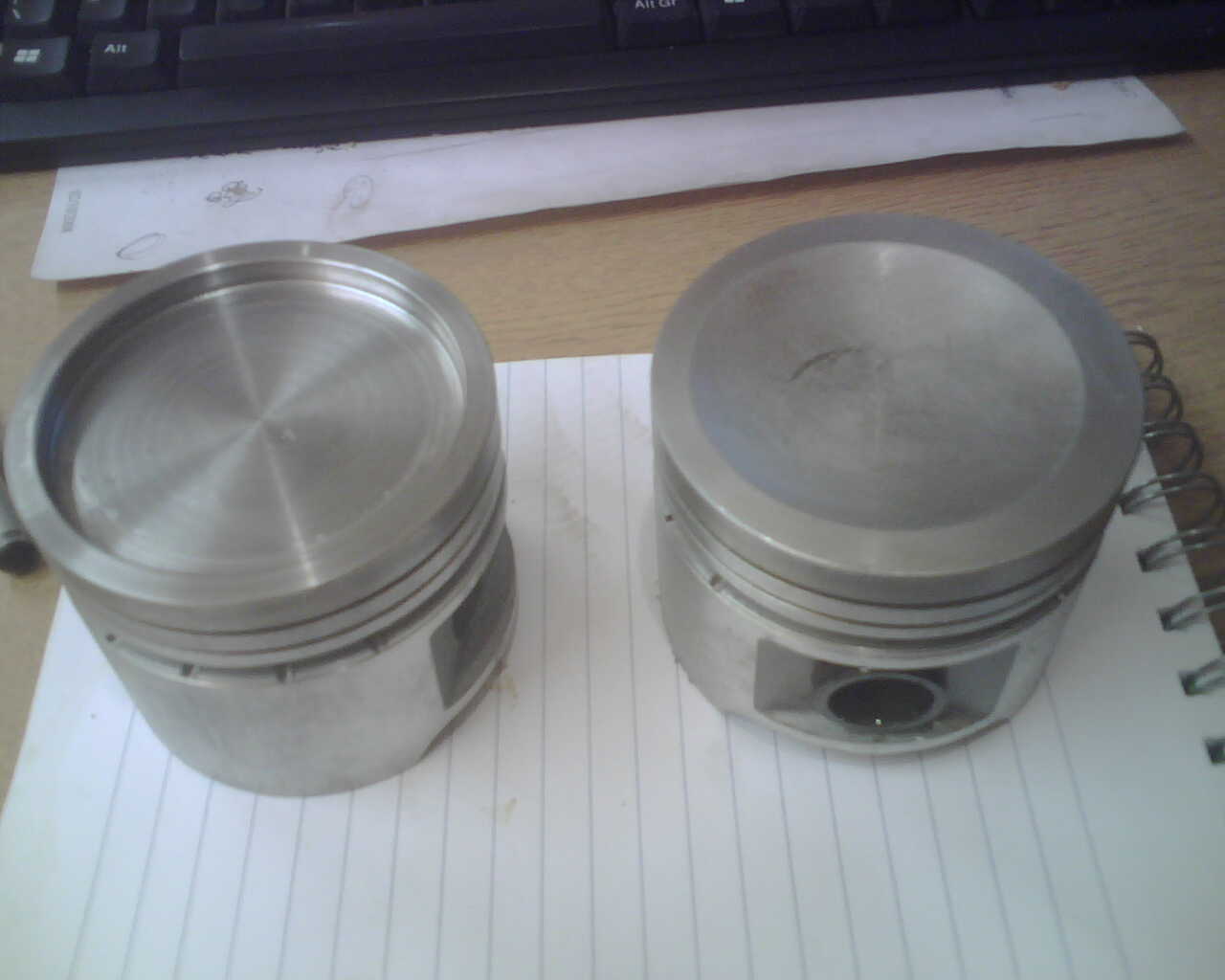

here is today’s work some nice new 1330 Omega pistons with a bit more space :)

that should be great sir, I would be a little worried about the sharp angle on the pistons where it has been machined out, I'm not sure this is a good idea as things get very hot and there isn't much meat arounf them edges, just wanted to share my thought with you.

thanks mat I had the same wories I have opened up a new topic with this very wore I have a tec drawin showing a possible solution to this problam
