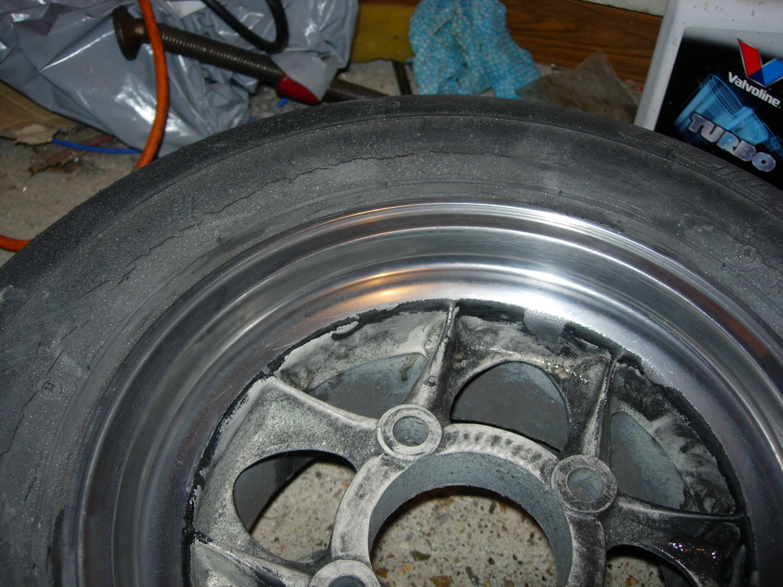

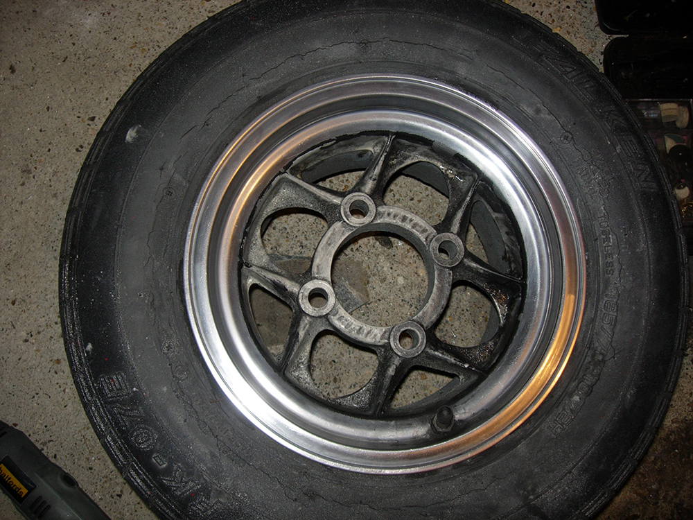

Ive spent the last 2 hours polishing my wheels and I can't get the finish any better than this....

i wouldn;t think smooth hammerite would finish nice enough for a set of wheels, best off spraying them.

screwfix do a kit for a drill...about £20.

personally i like a duller finish, dont like it too chromey, 1200 withe water is about as fine as i'd go, maybe a bit of steel wool (brillo pad), when its laquered it will look shineyer. On 28th Aug, 2011 Kean said:

T.Cut is a nightmare on alloy! I tried this many years ago and got nowhere. It jst seems to get you a greasy kind of finnish. Then I found Autosol! Give it a try. I know a few guys that have refurbed wheels and only spray the centres leaving the alloy bare. If the car doesnt see much winter use it is not a big deal. A wee wipe over every few weeks with autosol keeps them gleeming and now worries about corrosion under the laquer. I did a rocker cover on my other car this way and left it ovr a year before I had to polish it again. |

as has been said above ,you need an abrasive aluminium polishing set,

http://www.tooled-up.com/Product.asp?PID=12751

http://www.tooled-up.com/Product.asp?PID=12751 something like that carl? yes that'll do the job, carl. |

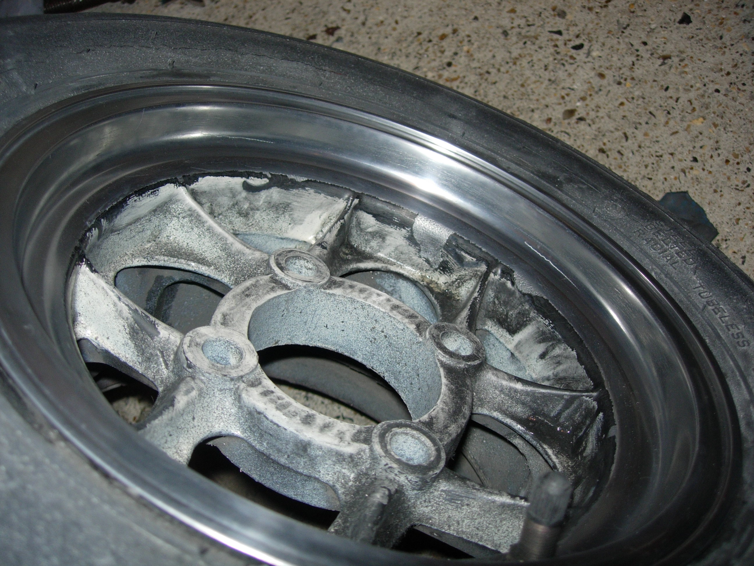

Well I bought myself a polishing kit and it seems to be working really well with the coarse compound (brown) and hard mop but I can't seem to get the fine (blue) compund t take to the soft mop....any tips on how to apply the fine compound onto the mop? It seems to be alot harder than the coarse compound? Edited by matty on 29th Apr, 2009. https://www.facebook.com/pages/Fusion-Fabri..._homepage_panel

Oh yeah, whats the best way to remove a tyre? Its fucked so doesn't matter if it gets ruined. just force the bar into the mop whilst its running at high speed,eventually it'll take |

On 29th Apr, 2009 matty said: Can you not rub it onto the wheel then polish it off?

As si says, heat into mop,

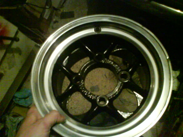

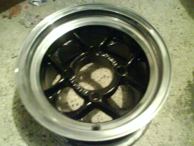

14th May, 2009 at 12:39:32am
Well after LOTS of pissing around polishing...re-polishing, painting then stripping the paint off and spraying, ive finished 2 of the wheels...20 hours later https://www.facebook.com/pages/Fusion-Fabri..._homepage_panel

14th May, 2009 at 09:23:10am
Mmmmmmm matty ! Those look the business mate ! "So wat we gonna do tonight Brain?"
14th May, 2009 at 03:07:57pm
well worth the effort!
14th May, 2009 at 04:13:33pm
bloody good job that matty

It sounds like you've got the hang of it. The polishes, if they are similar to what I've used here in the States, are wax blocks. Since they are wax, you pretty much need the friction of the the mop wheel to melt the wax before it will take.

14th May, 2009 at 11:33:33pm
Cheers for the comments, the photo's are shite I know!
On 14th May, 2009 Nic said:
Arrrrrrrrrrrrrrr Hurry up and get it out so you can cause offence to sarah Haha, Paul is picking the wheels up for me tomorrow (they were out of stock of the tyres..typical). Anyways should have it all back together tomorrow and hopefully get to try out my new clutch and see if the new wheels help reduce the torque steer!
