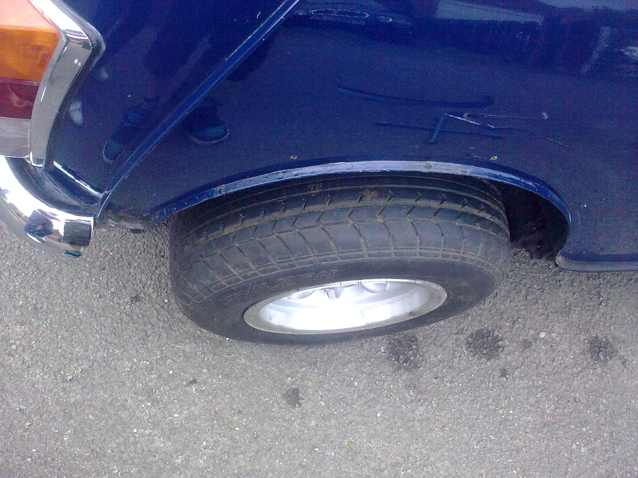

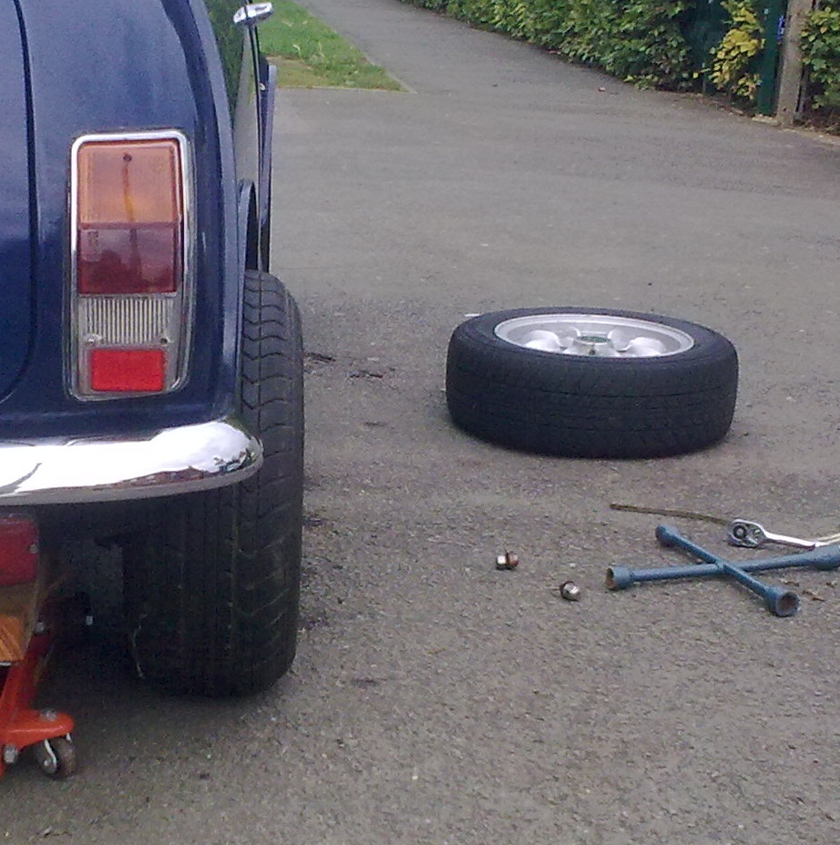

Hey guys I'm touring through google and having no luck at all :(
Is the legal on a car? (This car is not driving round like this it was just a test)
Yes No maybe whats the teapot on this?
Thanks

no. arch has to cover tread, i got a dig off the traffics when i was running 215 wide tyres for a while as they were a good inch of tread outside the arch.
Denis O'Brien.
no the arches have to cover at the minimum all the tread on the tire looking down on it
pah 5 secs too slow *happy*
Edited by Brett on 25th Jul, 2012.
You'll need some arches on those.
EDIT: even slower!!
Edited by theoneeyedlizard on 25th Jul, 2012.
actually the arch has to cover all the wheel, not just the tread,
hold a straight edgevertically against the wheel and it should touch the arch before the wheel/ tyre at the top.

I think I read on a copper forum there is about a 20mm leeway between legal and illegal. To be fair most of the cops were unaware of the law or could not agree either. I think yours is beyond doubt though

Itll pass an MOT. Im sure theirs nothing in the manual about that. Like everyone above has said its a transport legilation thing. I think its due to kicking up spray / stones etc..

i got pulled for this some years back and have posted details on this before but i wanted to double check so i have been searching online and from what i can find we are all correct, but joe is the most correct
For an mot test, it SHOULD pass there is no reason listed to fail it on this.... but it is still at the testers discretion if he deems it un safe or not
even though it is not a fail on an mot it is still not legal what Joe posted is the legal requirement ( or there abouts) it falls in the construction and use section
http://www.legislation.gov.uk/uksi/1986/1078/contents/made
scroll down to point 63..
even then it is open to interpretation

On my car the wheel just! Protub 10mm, by law they should not, never got a tug.
Fit the arches
The place to look is the type approval manual/SVA manual, its quite clearly stated in there,
theres a bit more to it than what I said, as the wheel need to be covered for x degree's...
essentialy the reasoing behind the rule is, if you drive into a pedestrian at low speed the arch should protect them from the rotating wheel.
that said, if you have a little sticking out your likly to get away with it as only vosa/trafic cops will know the details, certainly its not part of the MOT,
Personnally I say fuck the law - if it looks good drive it. My wheels stick out about an inch
