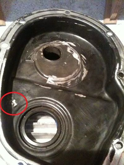

![]() 1425 Posts Member #: 9199 Post Whore Lancashire |
4th Jun, 2013 at 06:56:40am
did you knock the lump out of the cover as the chain catches on it. What the mind can conceive the mini can achieve
5th Jun, 2013 at 06:56:42am
there's a small lump "circled in red" that needs knocking out as per the attachment.

5th Jun, 2013 at 07:10:40am
You DO NOT need to remove the metal retainer type bit in the top of Lee's picture.
5th Jun, 2013 at 07:16:14am
thought the ring had to be removed to allow clearance for the duplex chain On 5th Jun, 2013 apbellamy said:
You DO NOT need to remove the metal retainer type bit in the top of Lee's picture. Eyup BTW. What the mind can conceive the mini can achieve
5th Jun, 2013 at 07:34:06am
I've never removed it and not had any problems. You just have to bash the dimple out. On 11th Feb, 2015 robert said:

5th Jun, 2013 at 11:16:16pm
andy you DO have to remove the ring if its fitted with a rotorslide adjustable duplex,
24 Posts Member #: 10459 Member |
5th Jun, 2013 at 11:44:13pm
Just lightend duplex Benross but I am learning every second with these posts cheers guys also thanks lee that picture really will help :) |
6th Jun, 2013 at 08:41:22am
mines just a ligtend duplex but removed anyway.
On 5th Jun, 2013 BENROSS said:
andy you DO have to remove the ring if its fitted with a rotorslide adjustable duplex, a standard or lightend steel or cast duplex you you can leave it on What the mind can conceive the mini can achieve
