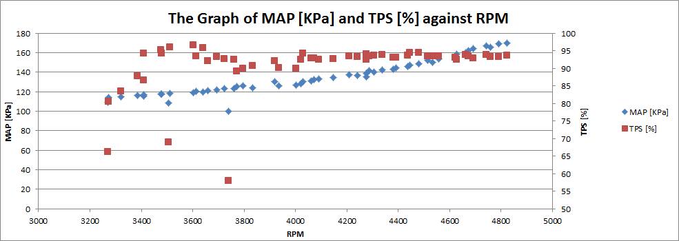

The problem Wil is that the turbo is not boosting more than 50KPa. Even to go up to 50KPa I need to be at around 5000RPM WOT.
My plan was to convert the turbo setup to the 1380cc.
However I do like your idea of continuing the 998cc development instead, but what should I do to raise the boost ? I am assuming that the turbo is too big for the 998cc, what do you think ?

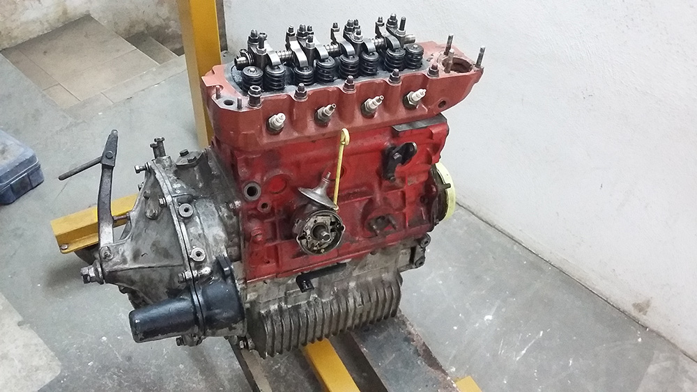

By the way, this is the 1275cc I have sitting in my garage. What about its cylinder head ? Is it a good one ? From the little research I've done its a 12G940.
slater
1030 Posts
Member #: 1291
Suffolk / Birmingham
A 12g940 is the standard 1275cc head. Its a good Base for a modified head if that's what you mean. Nothing special as standard tho.

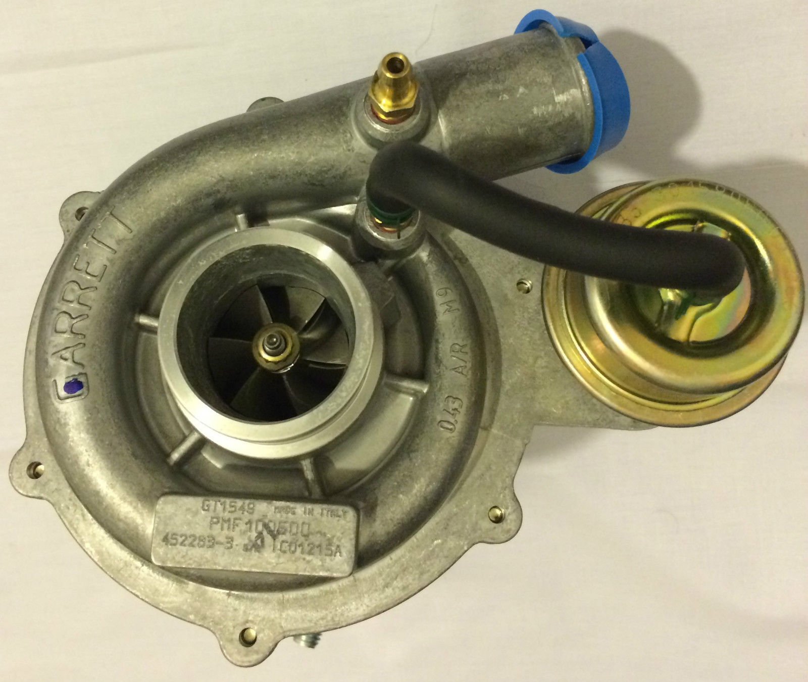

There are lots of choices for a decent turbo for a 998. A GT1548 worked well on mine. I don't know what a GT1549 is from, but it sounds too big.
I'd be tempted to try the IHI3 (I think it's a 3) from a Fiat 500 abarth. it worked fantastically on the abarth my wife had.

The GT1549 is from the Rover 25 SDI, 45SDI, 75SDI and MG ZR 2.0Turbo Diesel
Have you adjusted the actuator pre-load to increase the boost?
20l turbo diesel turbos usually work ok on 998s (as a rough guide). But full boost at 5k at WOT and not earlier would suggest either the wastegate or manifols is leaking or it's too big.
www.twin-turbo.co.uk

One of the apparent problems was actually a small leak in the inlet and solved that. Now I am reaching aaproximately 150KPa and occasionally 160KPa but definitely not more.

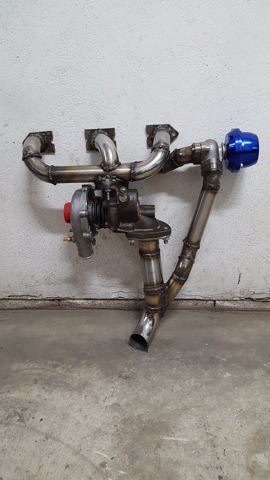

What have you done about the internal wastegate?
Barrieri
307 Posts
Member #: 11231
I fabricated a rod to keep it closed.
That chart suggests a huge leak.
Just double-check that the rod is holding it closed and not open.

How did you notice the leak Paul ? Actually that graph was plot before I solved the intake leak. Now that I solved it, it is reaching around 150KPa, occasionally rising to 160KPa.
Obviously the internal wastegate rod has not yet been fitted.....looking at the picture it looks to be in the wrong position?.......
On a side note, the 2.0L SDI was a 134hp deisel on a standard boost of 15psi, so should boost better than it is on a 1.0L engine
Barrieri
307 Posts
Member #: 11231
actually Sprocket, to fit perfectly in front of the cross member I had to cut the lever arm of the internal wastegate and weld it on the opposite side.
Barrieri
307 Posts
Member #: 11231
To understand, the rod I've fitted is pushing the lever away from the compressor, which is equivalent to pulling it towards the compressor in the original configuration

An issue might be a.misinterpretation. I am reading the MAP downstream of the throttle body. Now I know that usually the boost is tapped from the compressor housing, but my reasoning is that at WOT the throttle body shouldn't be much of a restriction so theoretically the MAP at the inlwet manifold should be almost equal.to the MAP at the compressor housing. Isn't it ?
Barrieri
307 Posts
Member #: 11231
If I have to read the boost from the compressor housing I need to install another gauge, as I am using the inlet manifold MAP tapping as a load parameter for the MS3x
