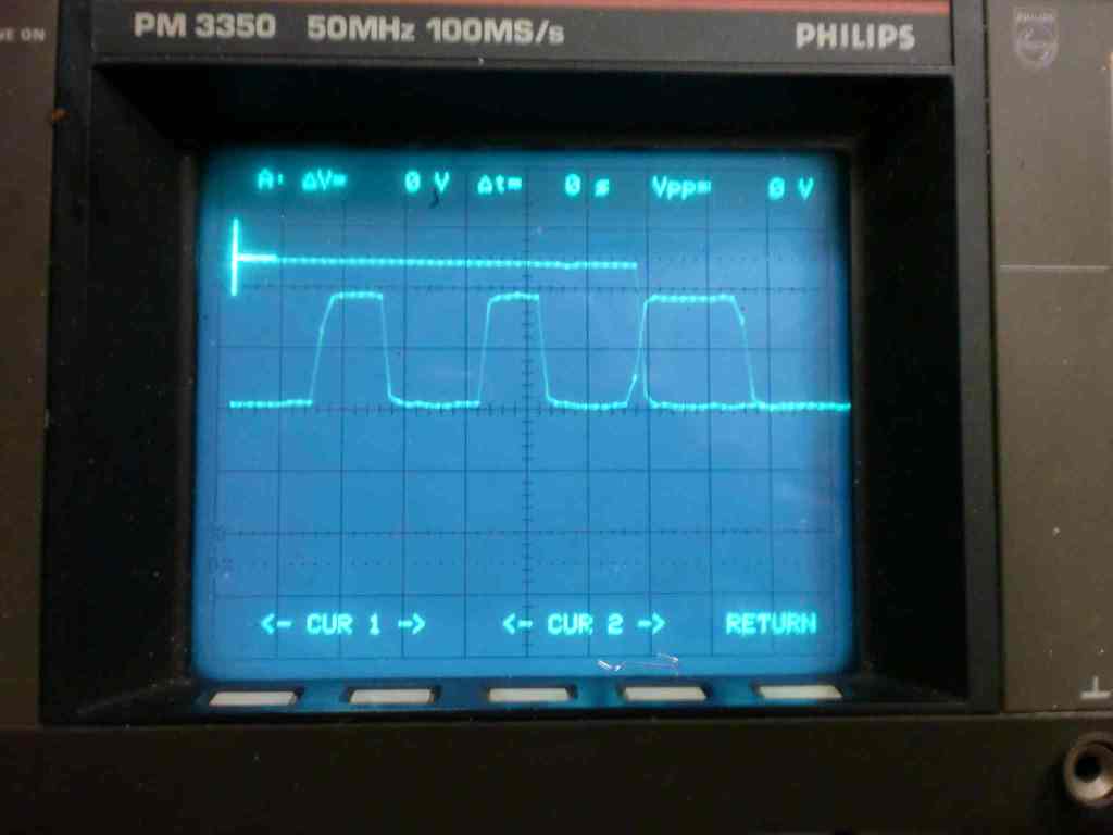

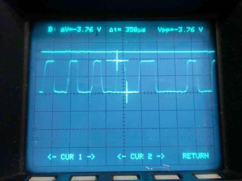

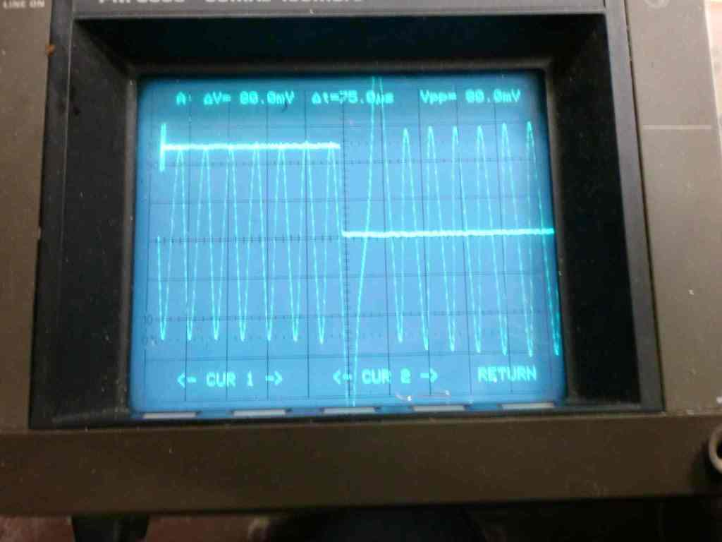

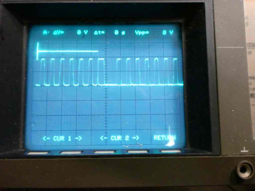

Hi, I just did some more tests.
As also the fuel pump cuts out I decided to use that signal at R16 to trigger from.
I added a few plots looking at the fuel pump signal I conclude that the 5V is all right because this signal is very clean at exactly 5V. Also battery voltage is oke its 13.1V.
First plot is the VR signal at the moment the problem occurs which, as can be seen, is exactly at the negative slope of the last tooth before the missing tooth.
Second and third plot are the vr out signal Both plots confirm that the problem occurs exactly at the last tooth before the missing tooth. Last plot is the VR out signal exactly 360 degrees before the problem occurred. (Vrout1 vrout2 and vrout3 are all from one and the same trigger event the vrsignal plot is a different event what confirms that the problem always comes at exactly the same moment in the engine cycle). Could the problem perhaps be that the VRout signal is to low? As can be seen from the plots it is around 3.8V
(Engine RPM was 2000 at the trigger moment)

Will,
Don't know if this will help or just confuse matters further....
I initially wondered about the 3.8V you are getting at VROUT - but U7 is an OpAmp, not a logic device so probably unfair to expect near to 5V - so I put the scope on mine...
Just running on the JimStim (fuel pump still not yet in car due to weather....)
a - as soon as I clipped the scope probe on, I got random resets - visible on the JimStim as fuel pump light flashes and IACV LEDs running to reset the idle valve, and visible in TS as RPM dropping to zero for a fraction of a second and ASE switching back on. I'm not sure how you know if it's a CPU reset or just that it's processing bad data....
However, when I connected the scope through a buffered HV probe (10:1 ratio) the resets went away (although I had to increase the scope scale by a factor of 10 to still see the output).
b - my voltage at VROUT was only 3.6V
Actually -1.7 to +1.9
That surprised me, I was expecting a zero to plus something signal (obviously I don't understand how that port works on the CPU !!!!)
But anyway, voltage swing comparable to yours.
So obviously the VR circuit is sensitive enough to be de-stabilised just by a scope probe in my case. I can't find what the input impedance of my USB one is but would assume it is quite high and although the problem went away with the buffered probe (which would be higher still) I would not have expected the plain probe to have that effect.
It was not the probe dragging the voltage down as it was still 3.6V with the buffered probe (once the correction factor of 10 had been applied).
So, having seen how sensitive the VR circuitry is, maybe your problem is something simple like a dry soldered joint or a bit of flux still on the PCB in that area ???

Ron,
Connecting the probes did not make my problem worse or less I tried the probes on both 10:1 and 1:1 setting (mine both have a little switch for this) both worked fine.
Did you perhaps have your scope on AC?? While measuring VRout? When I look at the circuit it can not get negative whatever the input is.
But as you said its pp level are comparable so that’s good.
I have gone minutely thru 20 complete engine cycles for both VR and VR out signal and both signals are so clean that these can not be the problem like you I also used high quality shielded cable for the VR sensor (used for measuring EEG signals).

Dennis of which signal would you like me to post a screenshot?
With noise filtering turned on for the primary tach signal the problem disappears so this does seem to narrow the problem down to noise although all signals look very ‘clean’! Perhaps noise is induced thru the open casing? I have not run with the casing closed yet. Wil do some further testing to see if I can find out where the noise is coming from.
Will
Will,
First thanks to Denis about the tooth logger, I've never even seen it......:):):)
If the noise killer in the software removed the problem, at least we can assume it is noise...
I was really surprised when I created the problem just by attaching a scope probe - never seen it yet in all the testing I've done so far - so if the filtering works, at least you know you are looking for "noise" although the VR circuitry is obviously very sensitive.
Maybe just run with the software filtering enabled for the moment and get the other bits, ie mapping, sorted then come back to the noise problem ???
