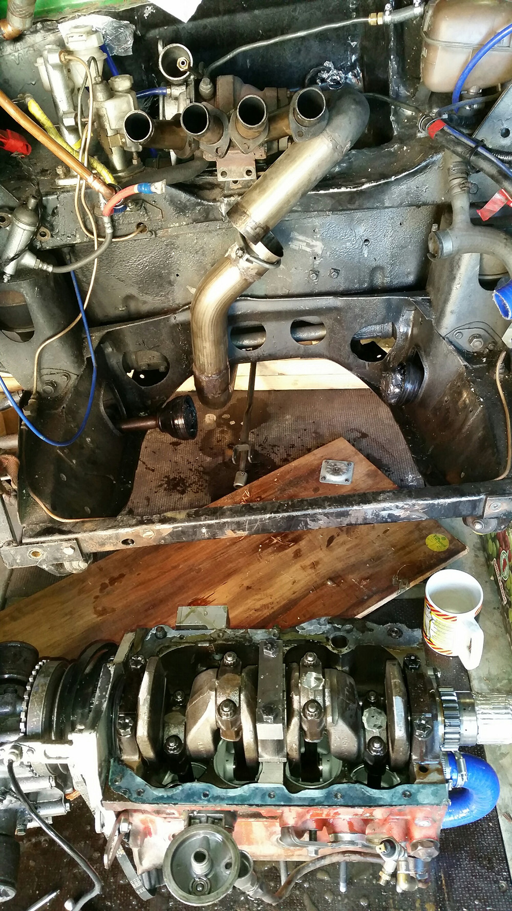

Today's 'progress'

Pistons removed and bores inspected. Nothing obvious so think I'll have to take it to a machine shop for advice/proper inspection.
4310 Posts
Well I'd have put money on a set of ring lands missing with those compression figures. Hope you get it sorted soon.
