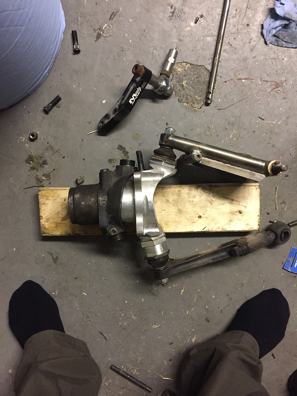

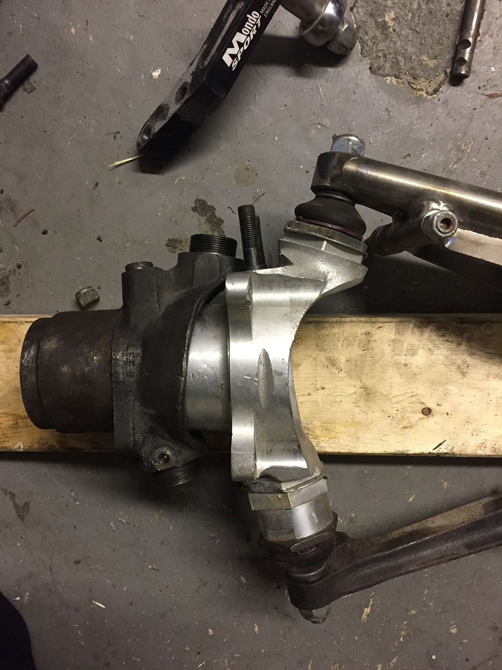

miniminor63
1849 Posts
Member #: 672
The oversills police
Oslo, Norway
Std hub and kad hub for comparison. Sorry the arms are on the KaD one, did not want to disassemble
Aubrey_Boy
690 Posts
Member #: 9962
Thanks very much for taking the time to photograph them together, very interesting more difference than I expected, I see you have the lower ball joint 'extension' - is that a KAD part? Looks like ally? Have you done a test with and without the LBJ extension? Feel any difference?
The KAD knuckle looks better for clearance for CV boot and retaining clip than the Minisport part, I have tried a HD CV from one of the 16V Mini vendors which I probably won't use, one (of a few) reason/s being the lack of clearance for the CV boot to knuckle with the Minisport knuckle
Thanks again
Edited by Aubrey_Boy on 18th Dec, 2016.
