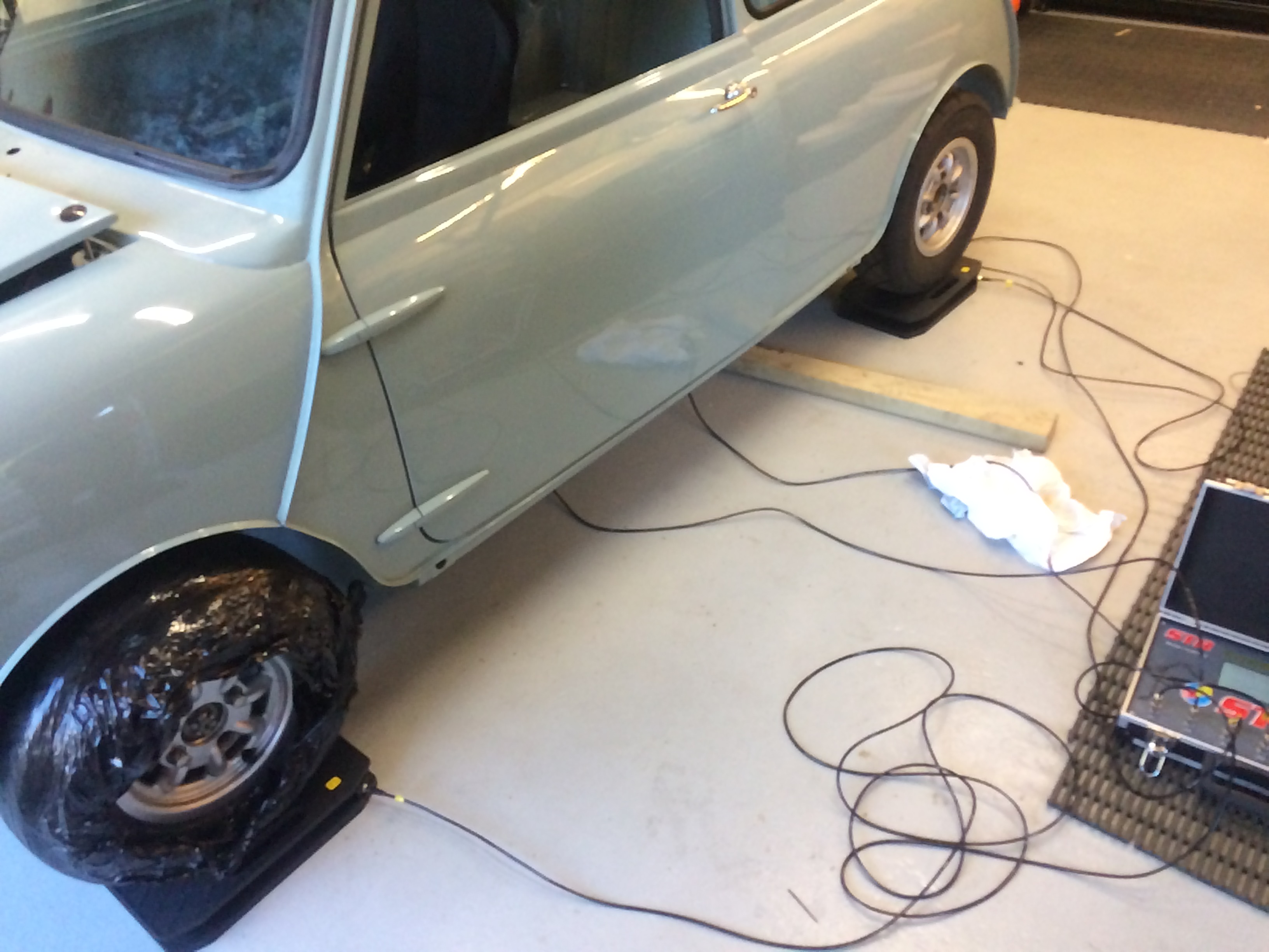

I'll swap it for a piccy of your cornerweight scales readout with your car on it *wink*
lol Bare weight is fine mate 👍
How you know it's been on the scales? You got a spy camera up in my workshop? Lol 😆
Here you go mate 😂😂

So it has been on them....
I was very careful with my wording....
I'll swap it for a piccy of your cornerweight scales READOUT with your car on it
I see your car...
I see scales....
I don't see READOUT *wink*
C'mon tell us then!
Lol, well I will let everyone know when all the bits are bolted on, and it's fully built as at the min it's not finished. And there is still little bits and bobs to bolt on.

How bout a 'for now' weight n we can all guess the end figure
