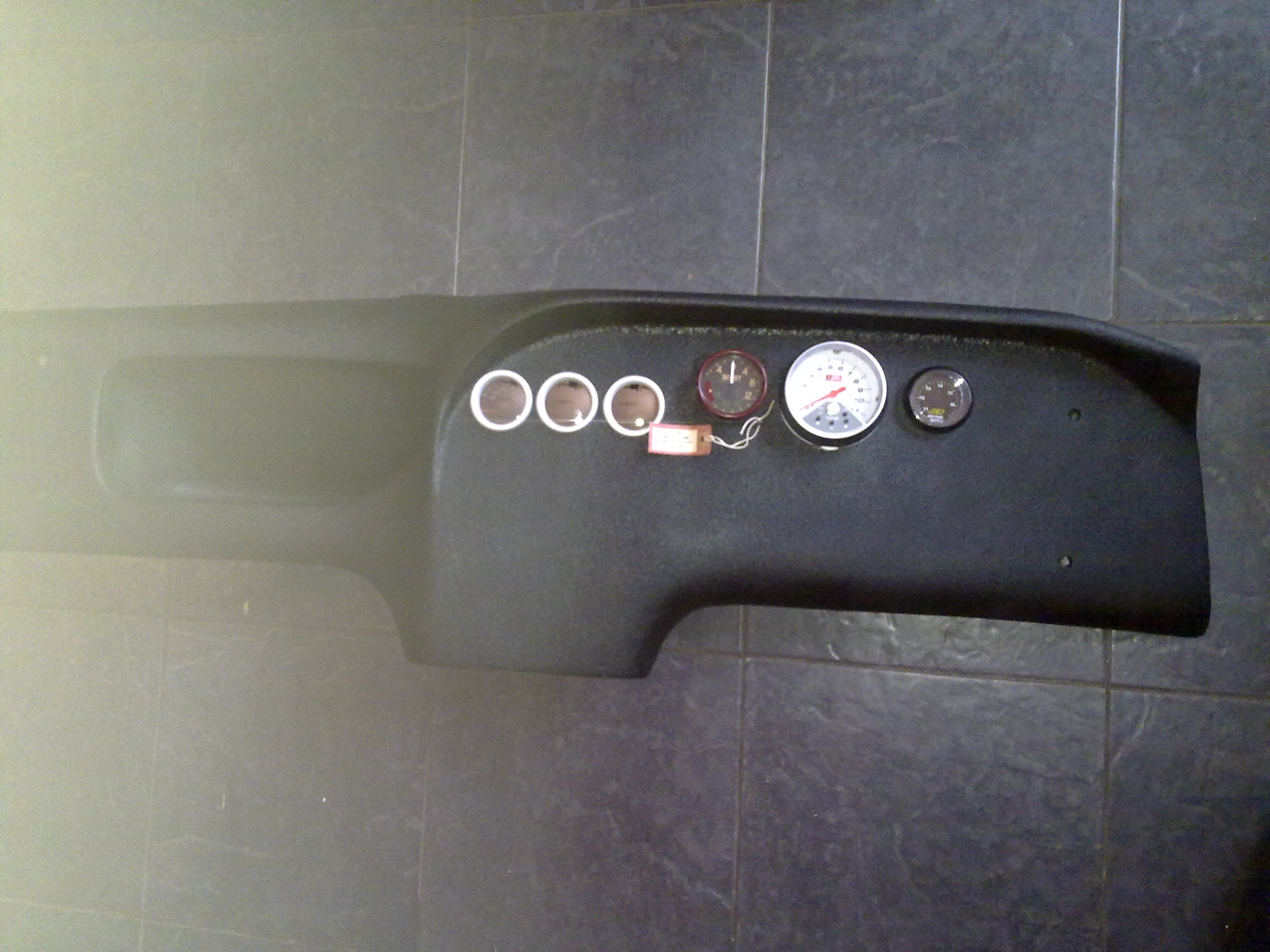

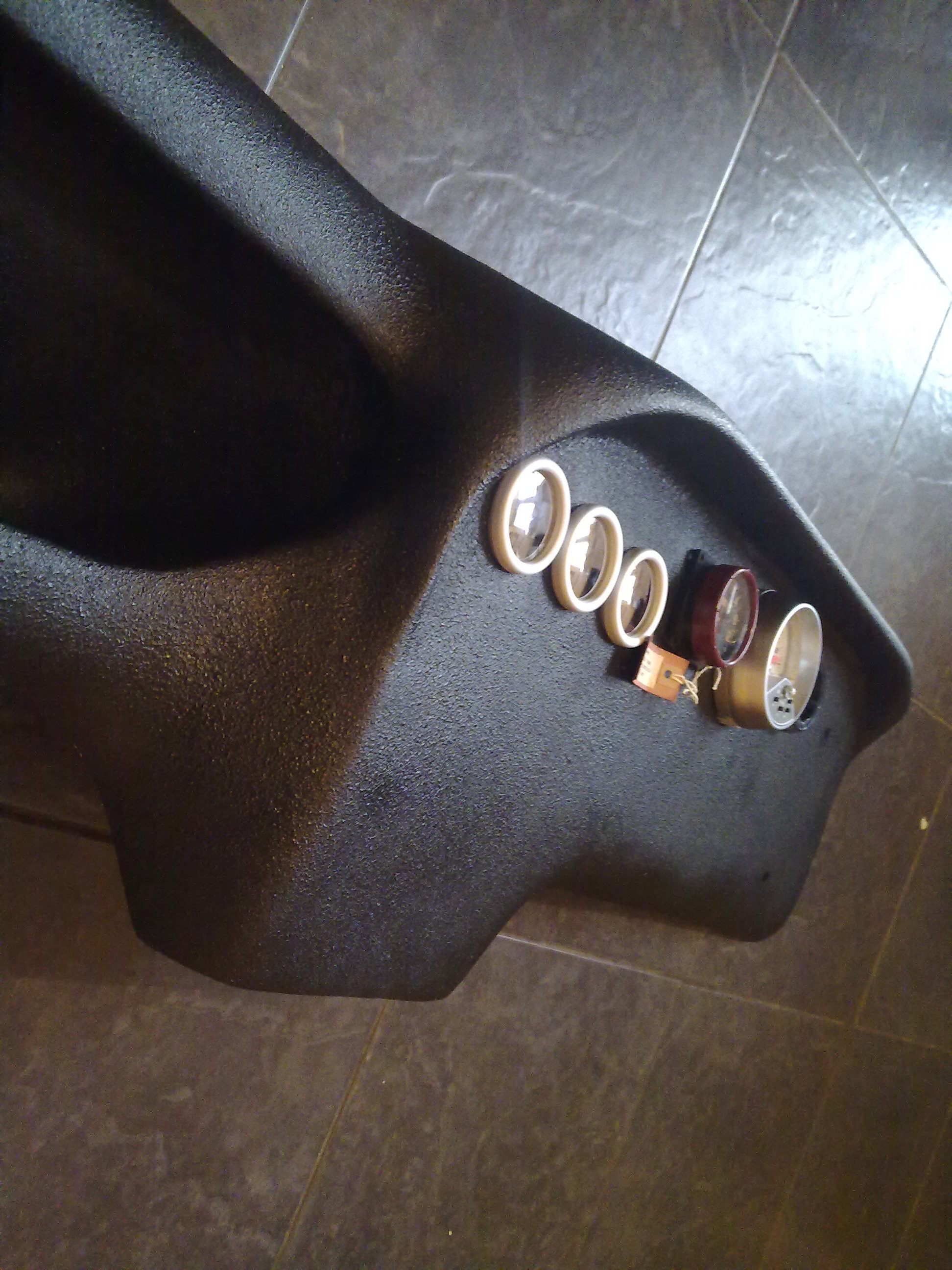

The dash looks incredible Brett!
On 30th Apr, 2010 Rod S said:
Gary's description is best
1380rich
484 Posts
Member #: 4755
warwickshire
good work on the dash, looks real good
cheers guys :)

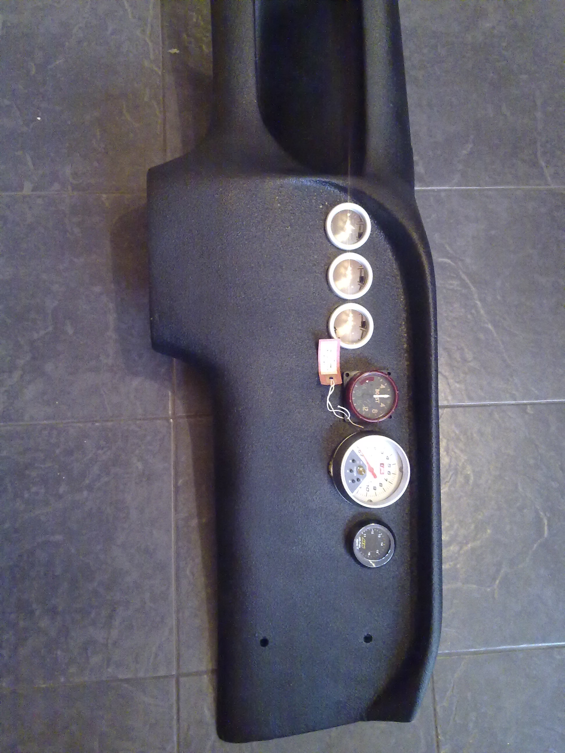

a couple more pics with gauges

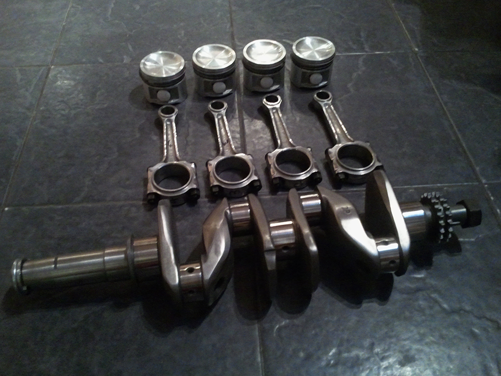

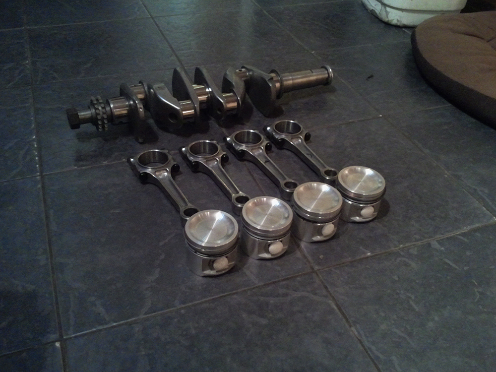

crank and rods are back from fastcarl,
crank- wedged, backdrilled, x drilled, grind 10/10, balanced and hardened

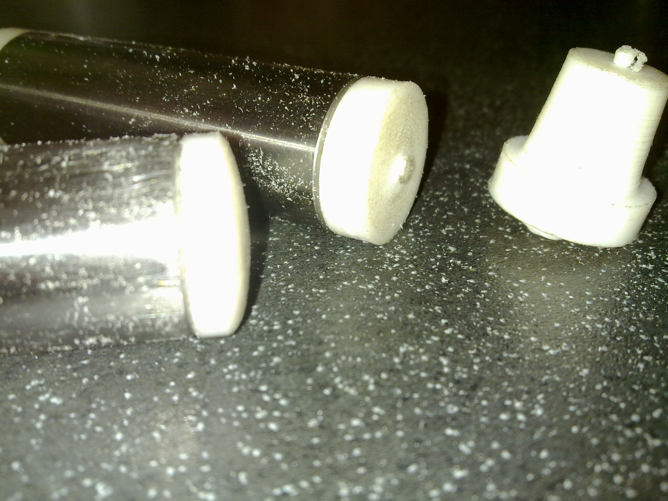

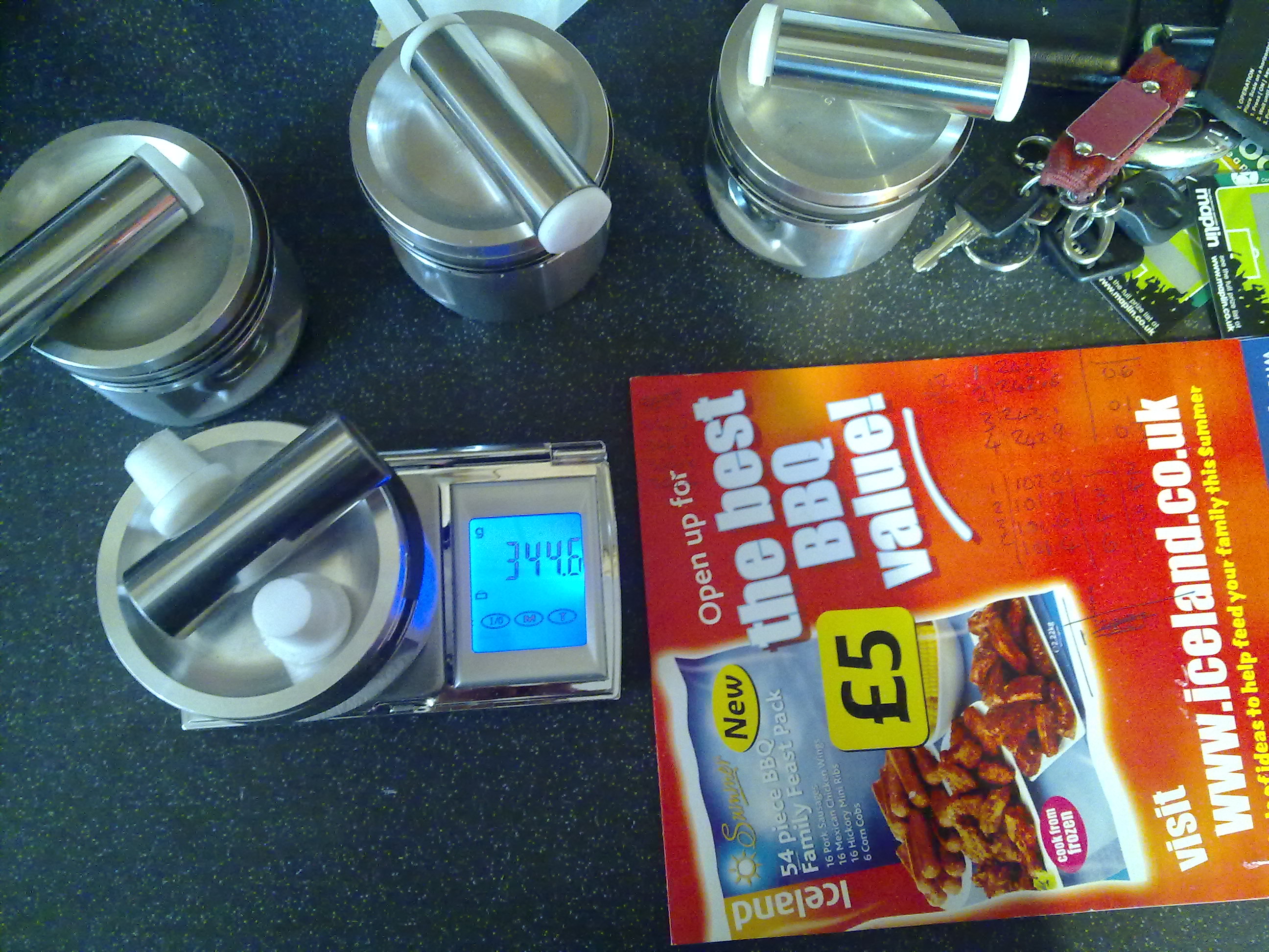

rods - little ends reamed for floating pins, big + little ends faced off to be polished by me with some buttons for the gudgeon pin,
the buttons was shaped for my block, for a perfect fit and balanced up with pins and pistons

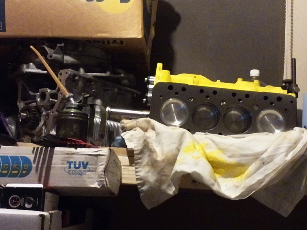

all waterways are now drilled, tappedand plugged up in the block, the head the same, after i have measured up for the thrusts the block and head will be going for drilling in side of the head for the dry deck port, skim, cam bearings and an acid dip they do

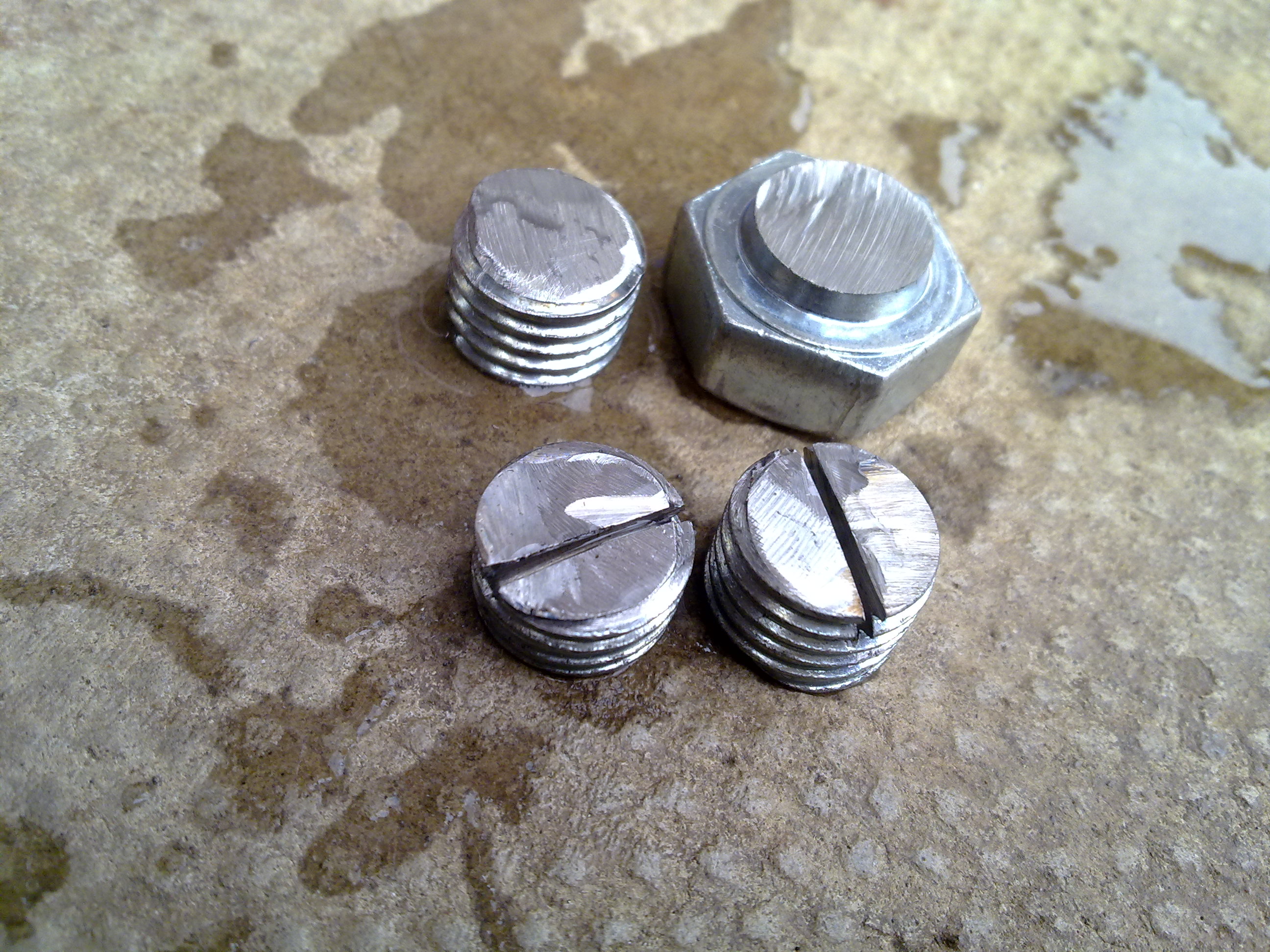

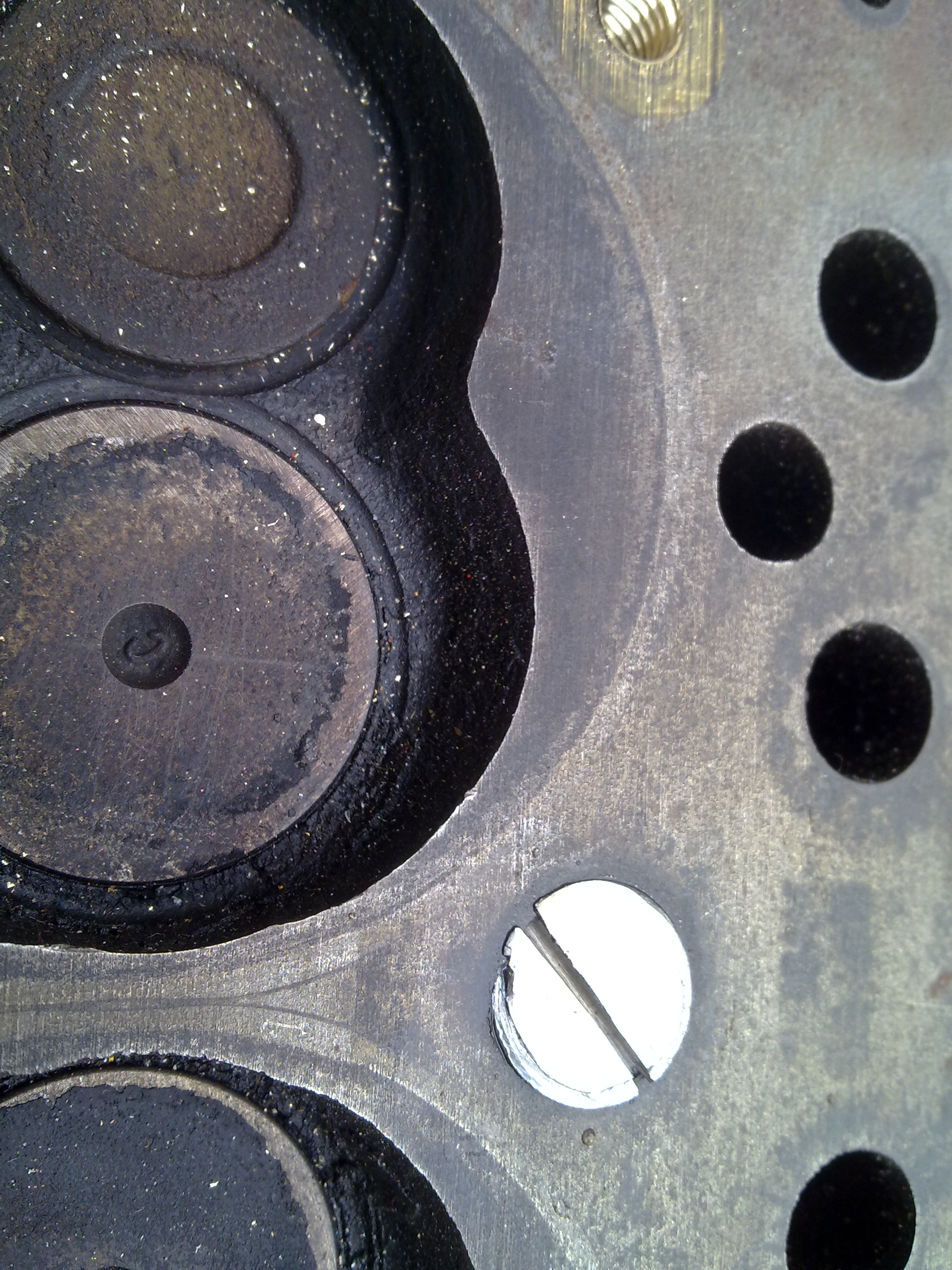

the head was pluged with m8 grub screws and diy m16 grub screws
the block m8 grubs and diy m14 grubscrews all secured with 'property of mod' locktite :)

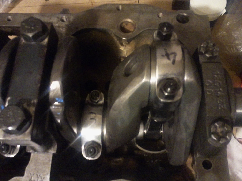

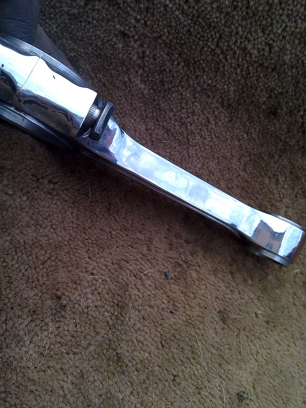

rods are done, i think,*tongue* 530.05g each sound right? they are all balanced up now but will more than likely spend alittle more time with the polish

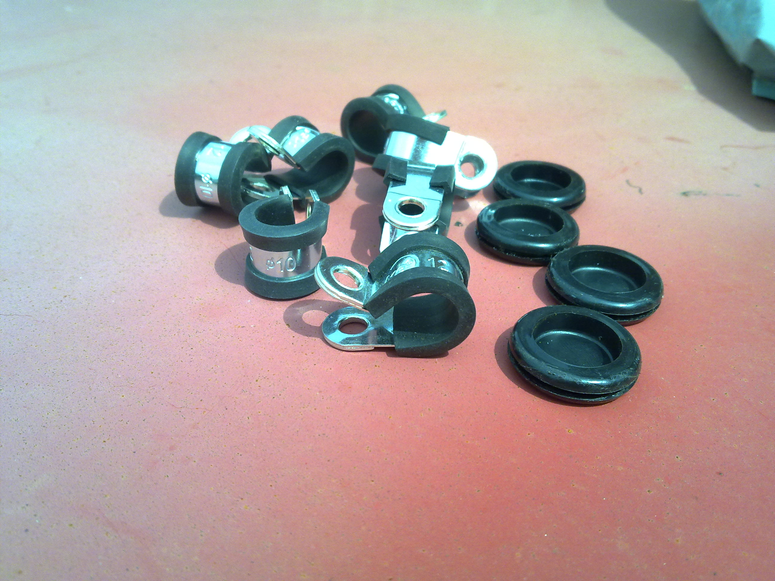

fitted the fuel lines today, 10mm feed and return,
as i dont want any joins in the cockpit they was made up from a single piece, bending the tube up by hand was er.. interesting it involved alot of poking from behind*happy* but they are in and im happy with them, cannot recommend the rubber lined 'P' clips enough glad i bought the same for the brake lines

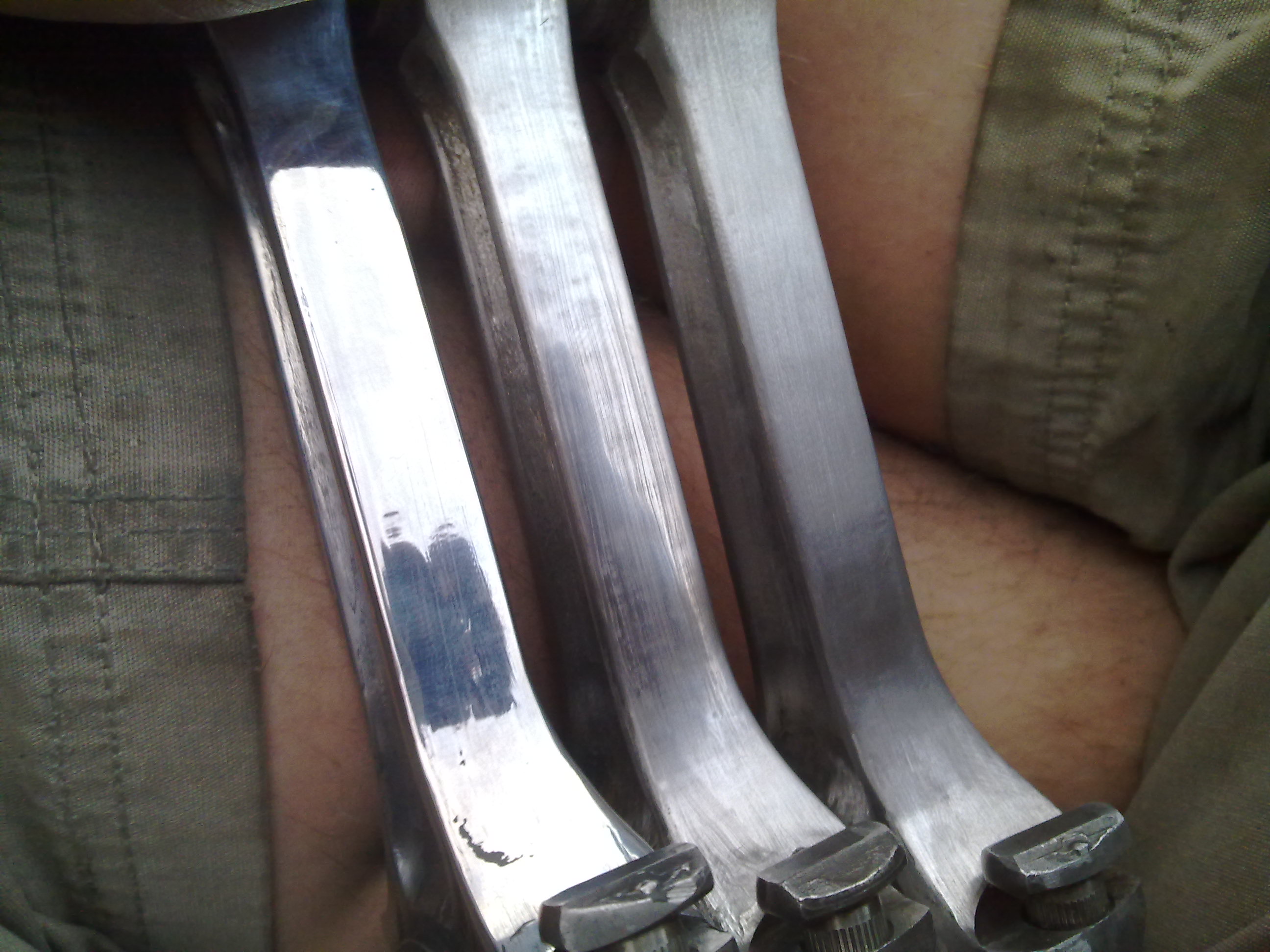

rods, 1,2+3, three different stages of polish
the single rod is roughly how they all are now

To me it seems as you've polished off the shot peened layer. Is that correct?

what did you use to polish the con rods?
these are just polished up standard rods v with a little forceracing machining first
how much would shot peening cost?, have not even looked into it yet/dont know if i should bother
dremil with sanding drums to take the main cast ridges off, then up in stages with sandpaper finally a mop on a bench grinder
worked out very time consuming, *oh well*

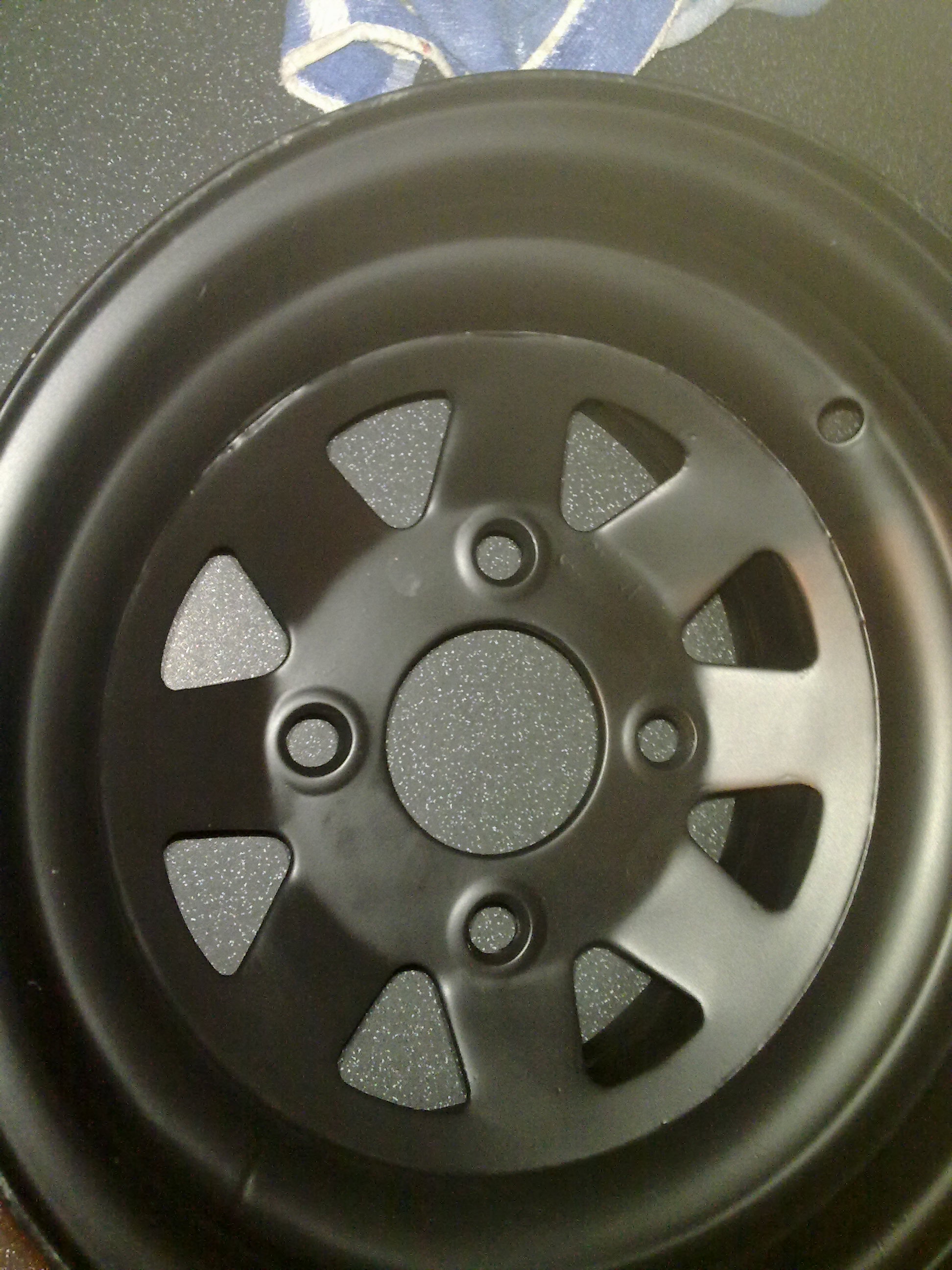

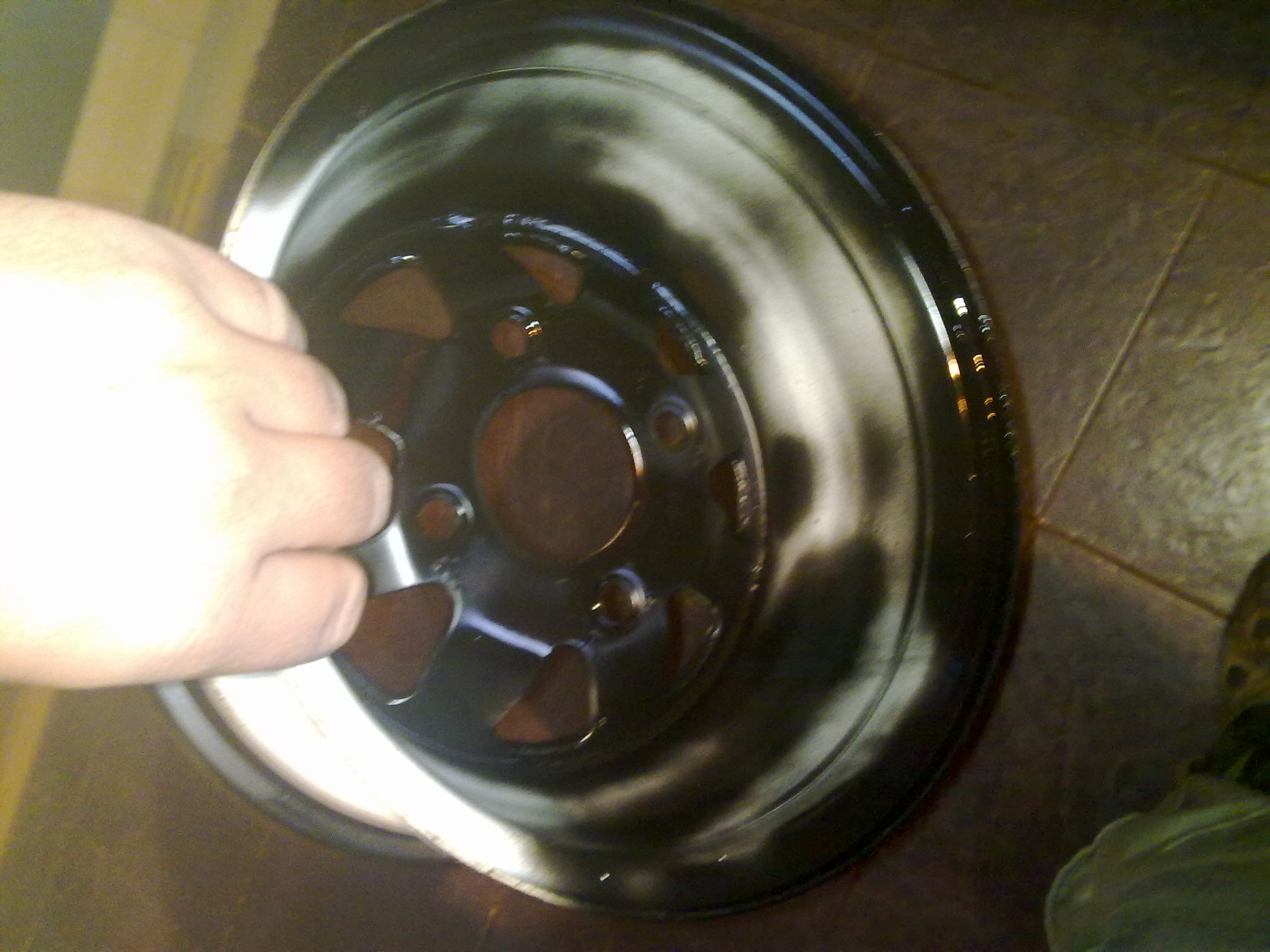

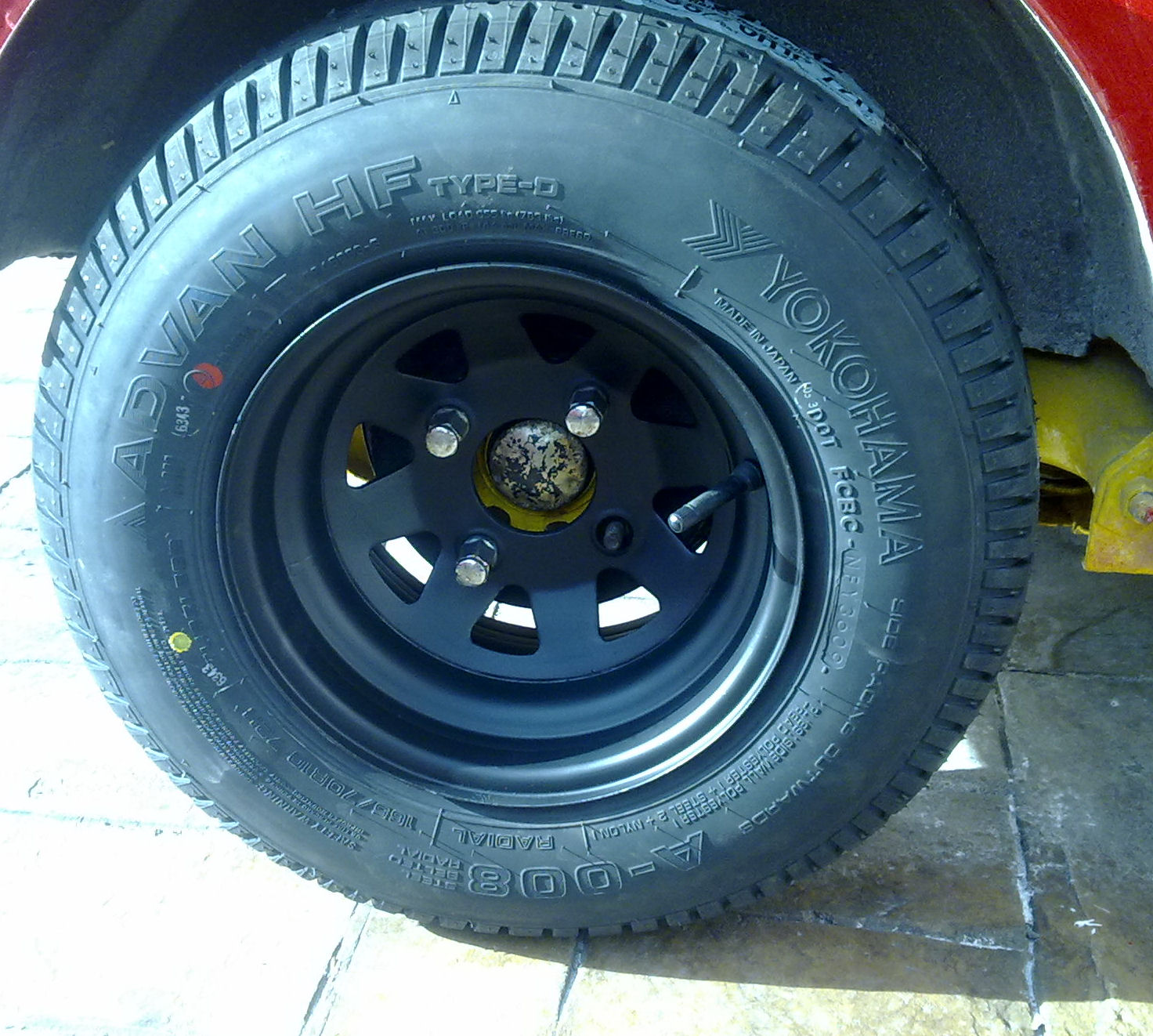

i have been fortunate to have had 2 weeks off work but unlucky with the weather i have managed to sort out abit more wiring. tidied up the 2 rear quarters, and started to skim the rear section under the boot before getting rained off, so i stripped and painted 2 of the wellers i have and then fitted the tires
another small update, 2 more wheels painted,

i love that paint, i owe jo a can. where did you get it from? :)
its holts matt black, i got it from a local car shop, its good stuff, quite tough

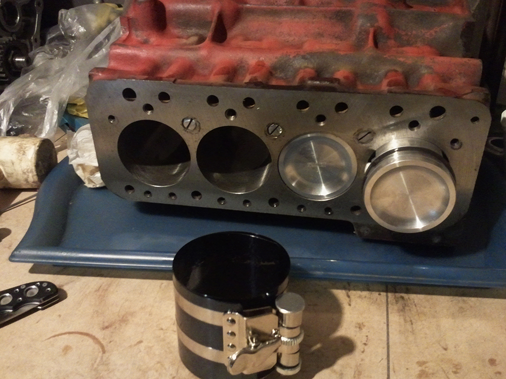

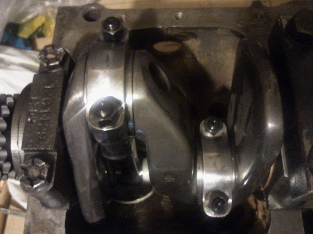

well its been a while hasnt it lol
held up on the cam lube that has not arrived yet and torquing the rod bolts, because i broke my socket*happy*
i started to give it a little paint but i think it will take a few coats,
