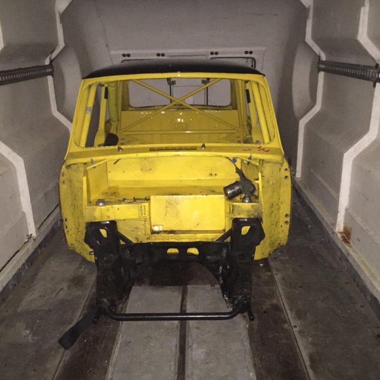

Progress has been a lot slower than expected, goal posts keep moving, but here are some updates.
The rear arches where removed:
a new rear arch was constructed higher up and further back than before.
the shell was blasted again to remove the gay yellow
The front cage was extended further forward to allow a ridged fixing point of the coil overs
