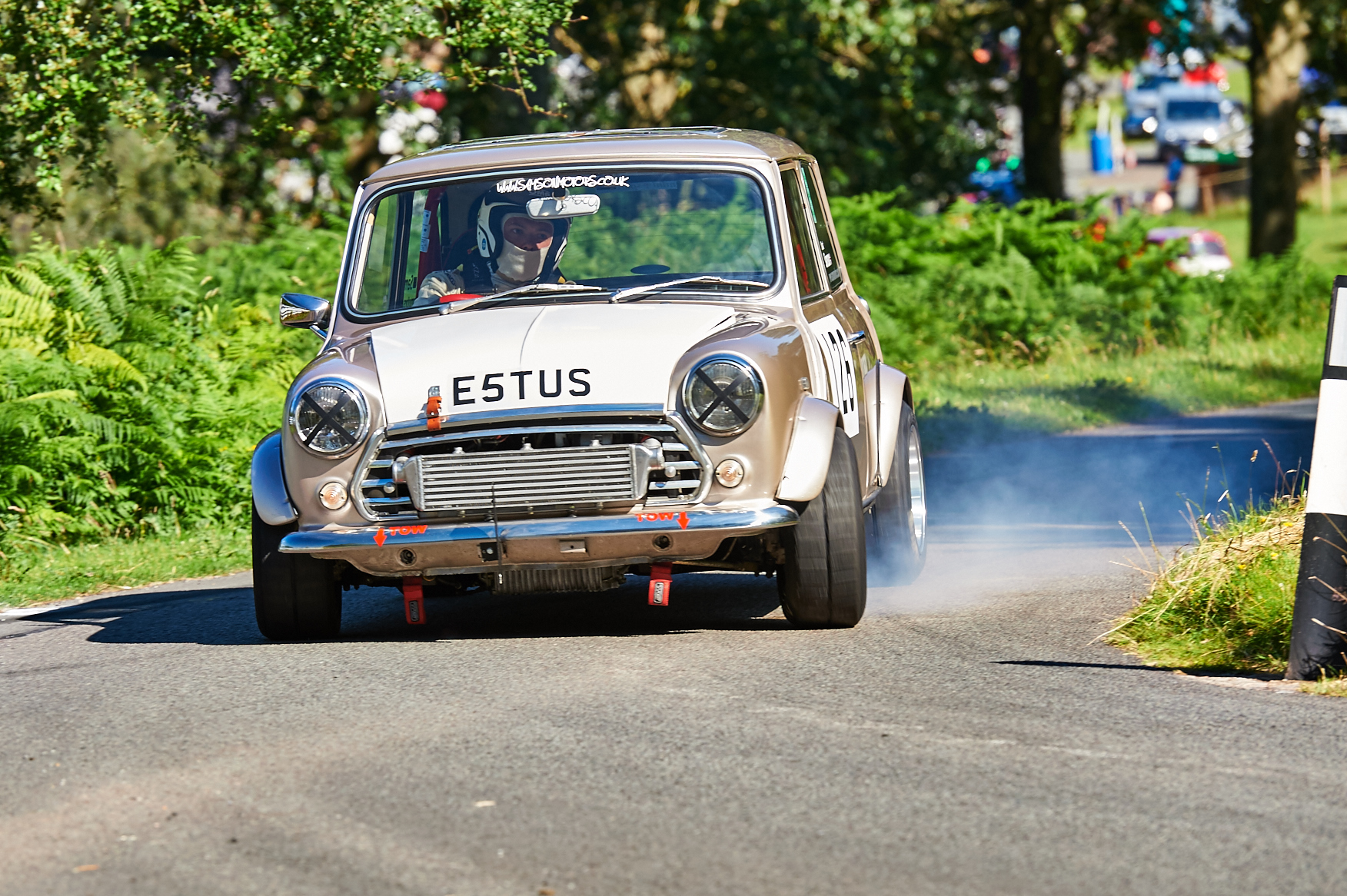

Anyway, all the work was worthwhile because my mate took this shot: (even the scabby bonnet looks good)

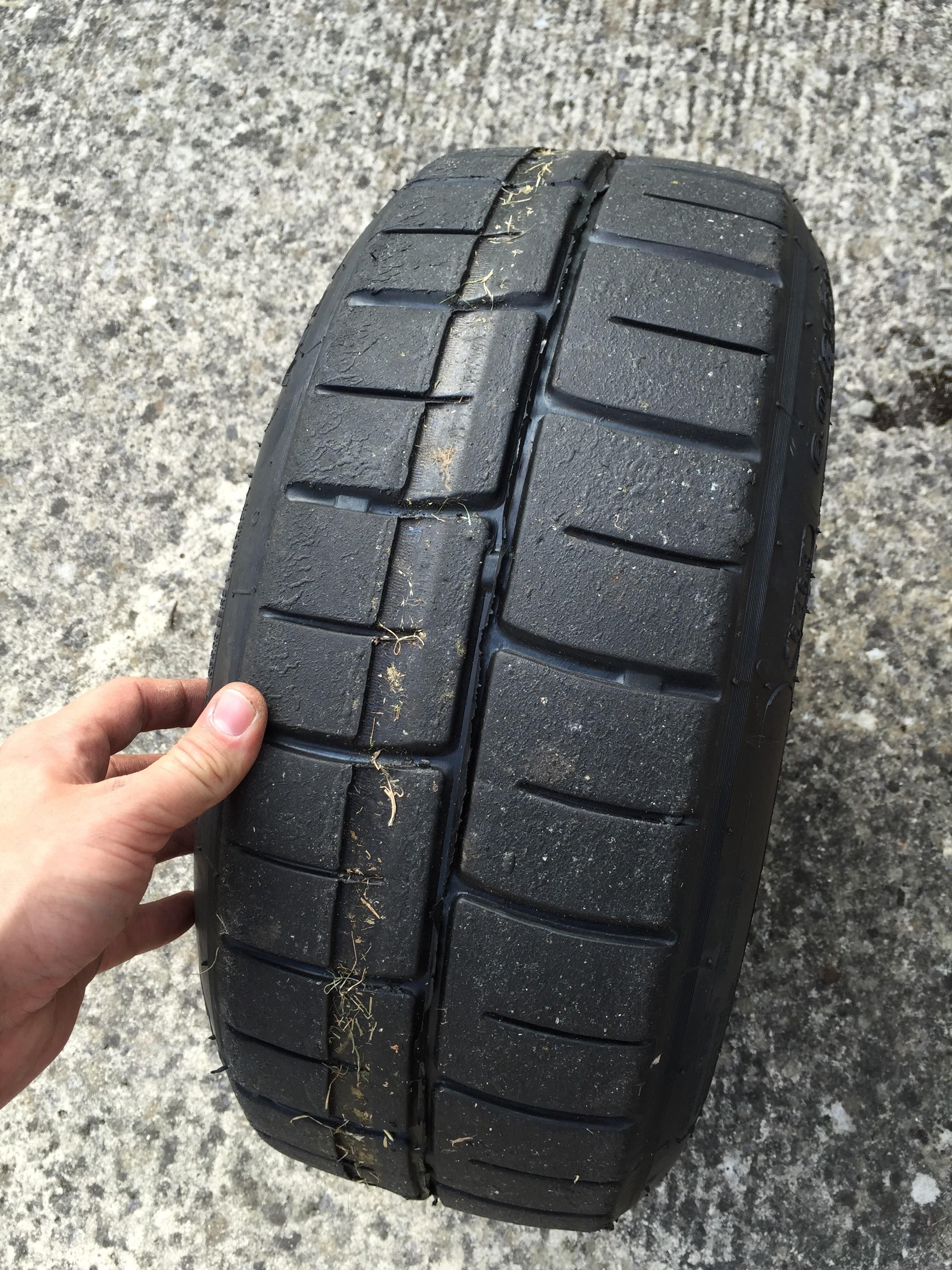

First visit to Loton Park, great venue, cracking hill and a good weekend. Got ACB10’s for the rear too, that was the only change, huge improvement with some more grip at the back. We had a fantastic running group; Morgans, Ferraris and us, the top paddock collection area was a brilliant sight.

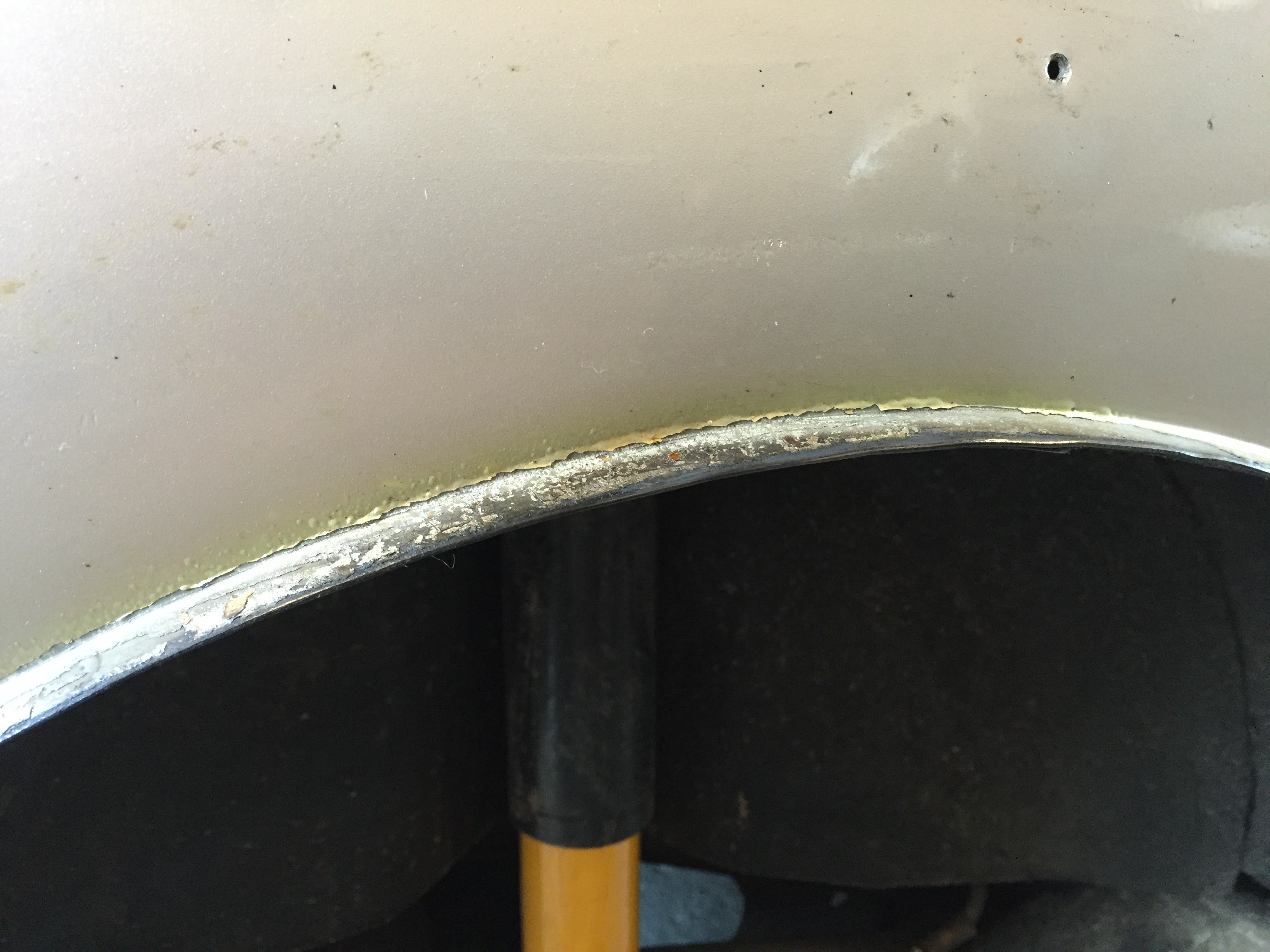

My fat ass did result in scoring one of the new rears with the arch (not tubbed – on the to-do list) so had to raise it up a little and stiffen the shock for the Sunday.
