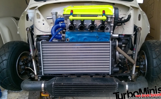

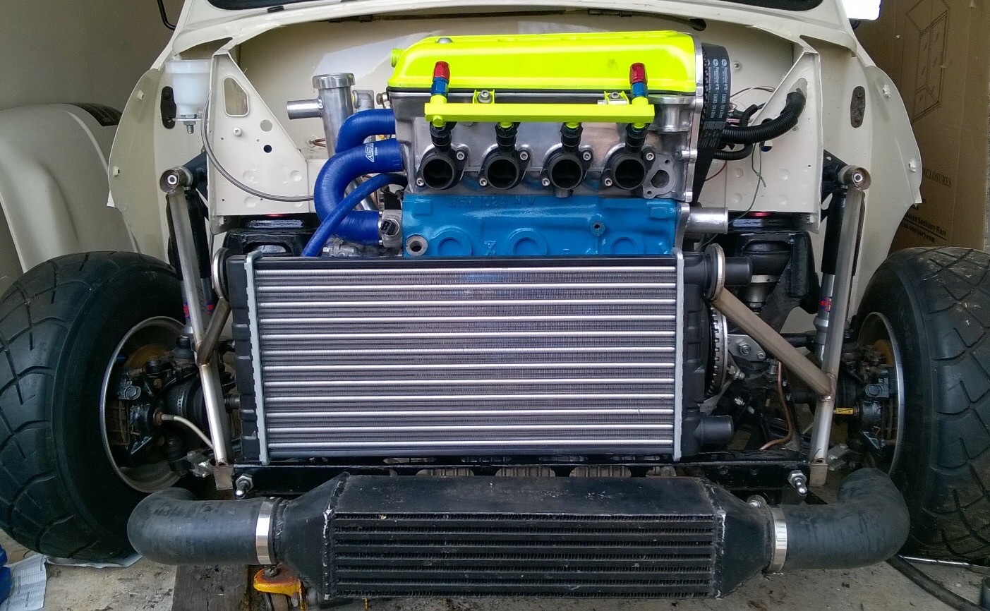

I managed to take the mk1 for a spin this weekend and get some time on this project. I got a few odds and sods finished off, and finally got my rad mounts all finished. It's mostly just assembly work now, which I'll try and get a few hours in here and there. I need to give this a shakedown before the end of summer.

Matty, is the core of that rad made from tubes and fins?
just had same discussion with Robert and Nick,
if it is you might want to look for the other 'proper' ally cored one, that one is shite

It is the ali cored item as it measures the same 25mm thickness as the one I have.

I've got a feeling it is Brett. It wasn't very expensive put it that way. I only swapped out my original copper one as it had a slight leak and this one was lighter. Have you got a link to the decent ones? If anything my old rad made it run a little too cool, so this may work ok. I'll get it running and see what its like.
Yes Andrew, this one has the 25mm core.

My ali cored item was half the price of the thicker tube and fin rad.
This is an ali cored job -
http://www.ebay.co.uk/itm/Fiat-Cinquecento...=item51d08a1c84
You can see the higher number of horizontal cores in the above item compared to this one -
http://www.ebay.co.uk/itm/Fiat-Cinquecento...=item27d837bc11
