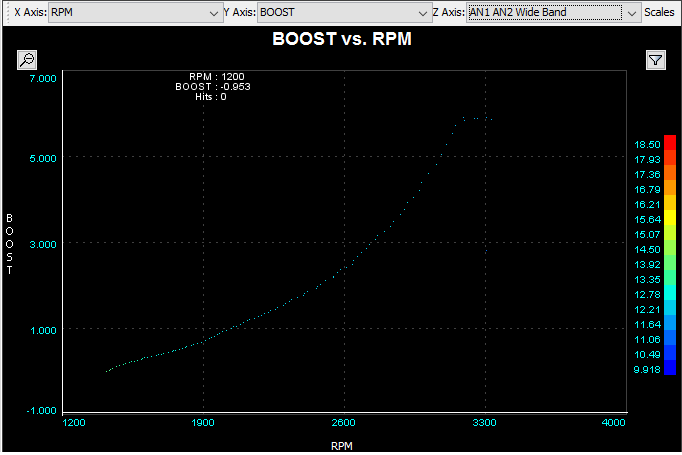

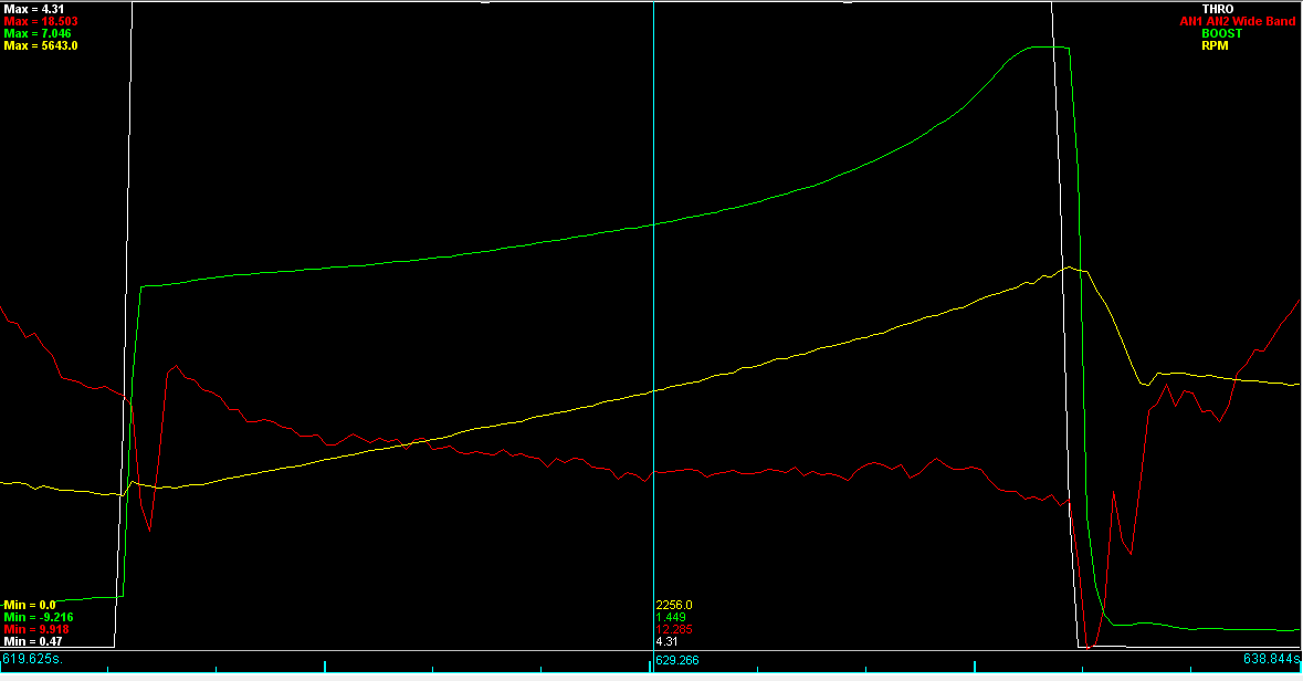

yeah 2.5l, Hx35w, 7 blade, 12cm twin scroll, but on a non twin scroll manifold, as i was going to buy / make a valve similar to what your doing
but the turbo was a hell of a lot more responsive than i predicted
the recent acquirement was listed as a hx40 'super 40' 16cm turbine, not took it to bits yet may end up on the 1.8 vtec
( ohh and the sound they make <3 <3 )
On 2nd May, 2016 robert said:
THANK YOU brett , appreciate it ,what holset do you have on your car ? 2.5 litre ?
have you wheel sizes and spool log on hx35 brett?
be interesting to see how the 40 works and what's inside it .
what boost and bhp are you at ?
turbo wheel sizes
Compressor: Exd:78.0mm Ind:54.0mm
Ex Turbine : Ind:70.00mm Exd 60.00mm
boost low 0.5 bar, high 1.1-1.2bar ish
power ??? road mapped and not been on a dyno yet (peaks around 85% duty on 555cc injectors @ 11.1 afr )
needs a forged rebuild before getting frisky lol
both pics show the same few seconds of log, couldnt find any decent pulls from off boost when running high boost
although it is something i keep meaning to do
Edited by Brett on 2nd May, 2016.
