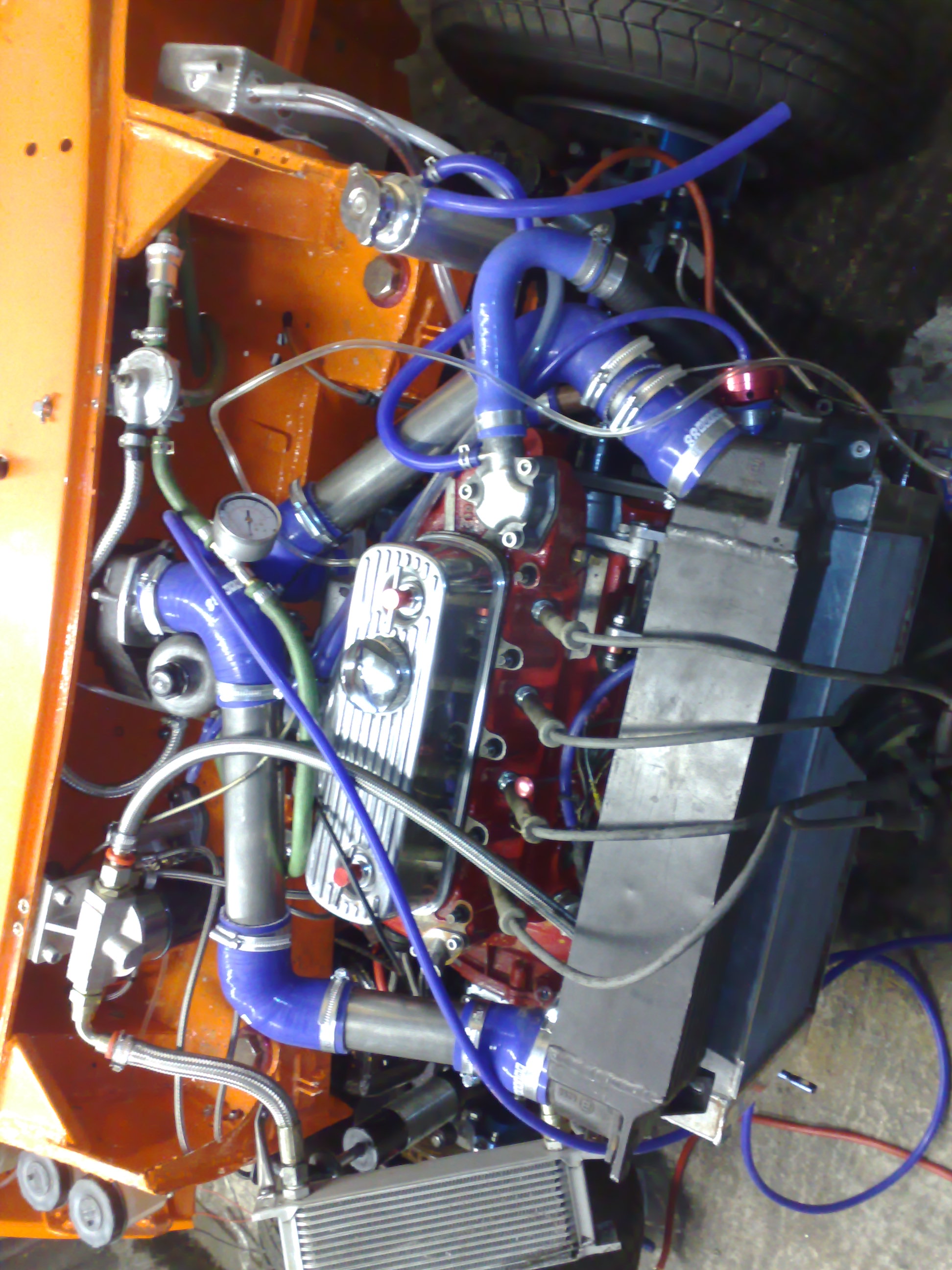

Yes it ran, for about 30 secs on the dizzy then it cut out. Ive had battery issues, i think either the battery is dead or my starter is goosed. Im just letting my bank account recoup before ordering an MJLJ and a High Starter from Wil H.
Ive also fitted a different loom as my old one melted lol.

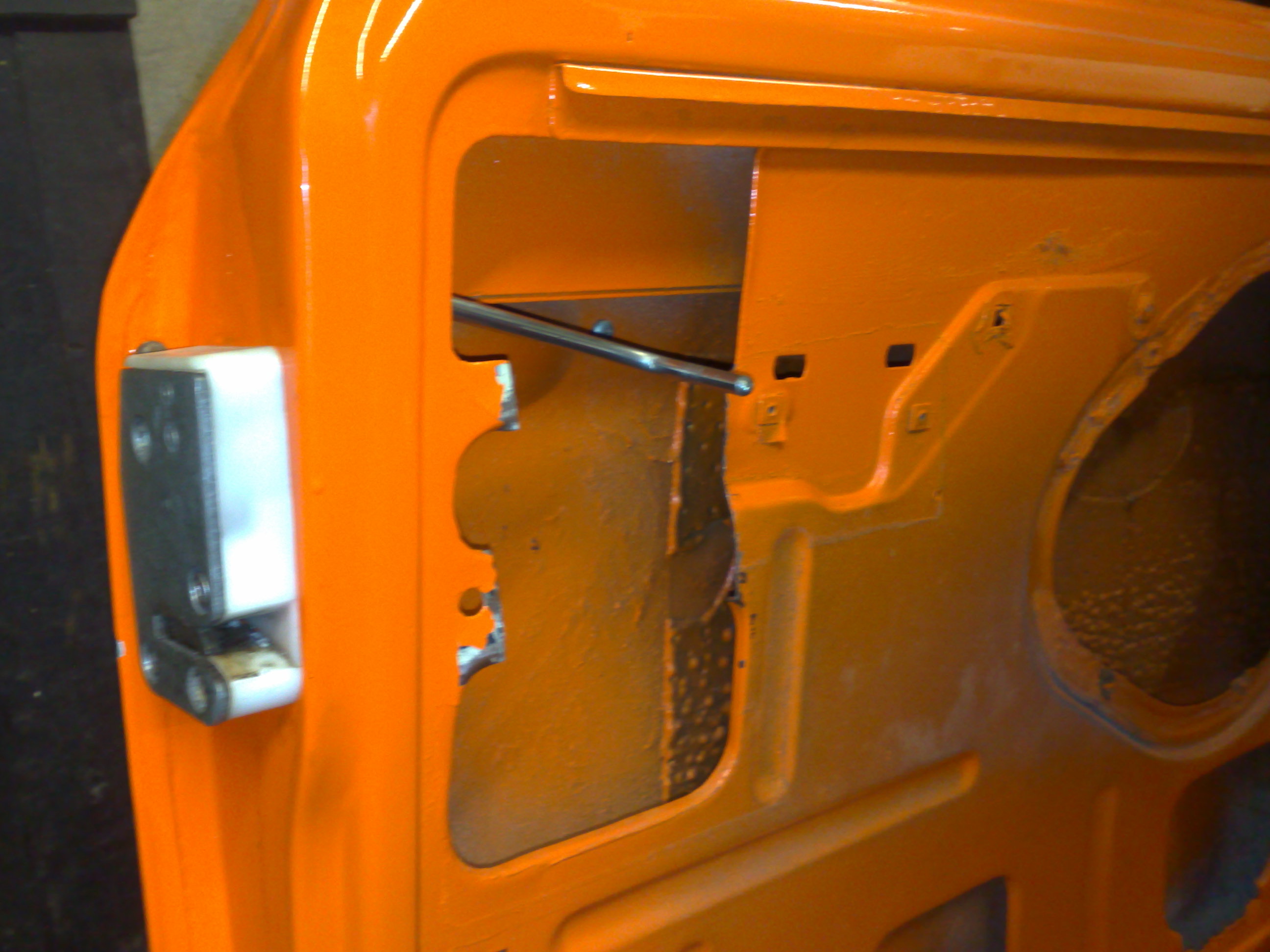

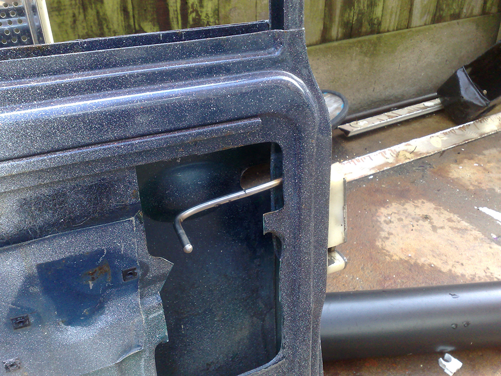

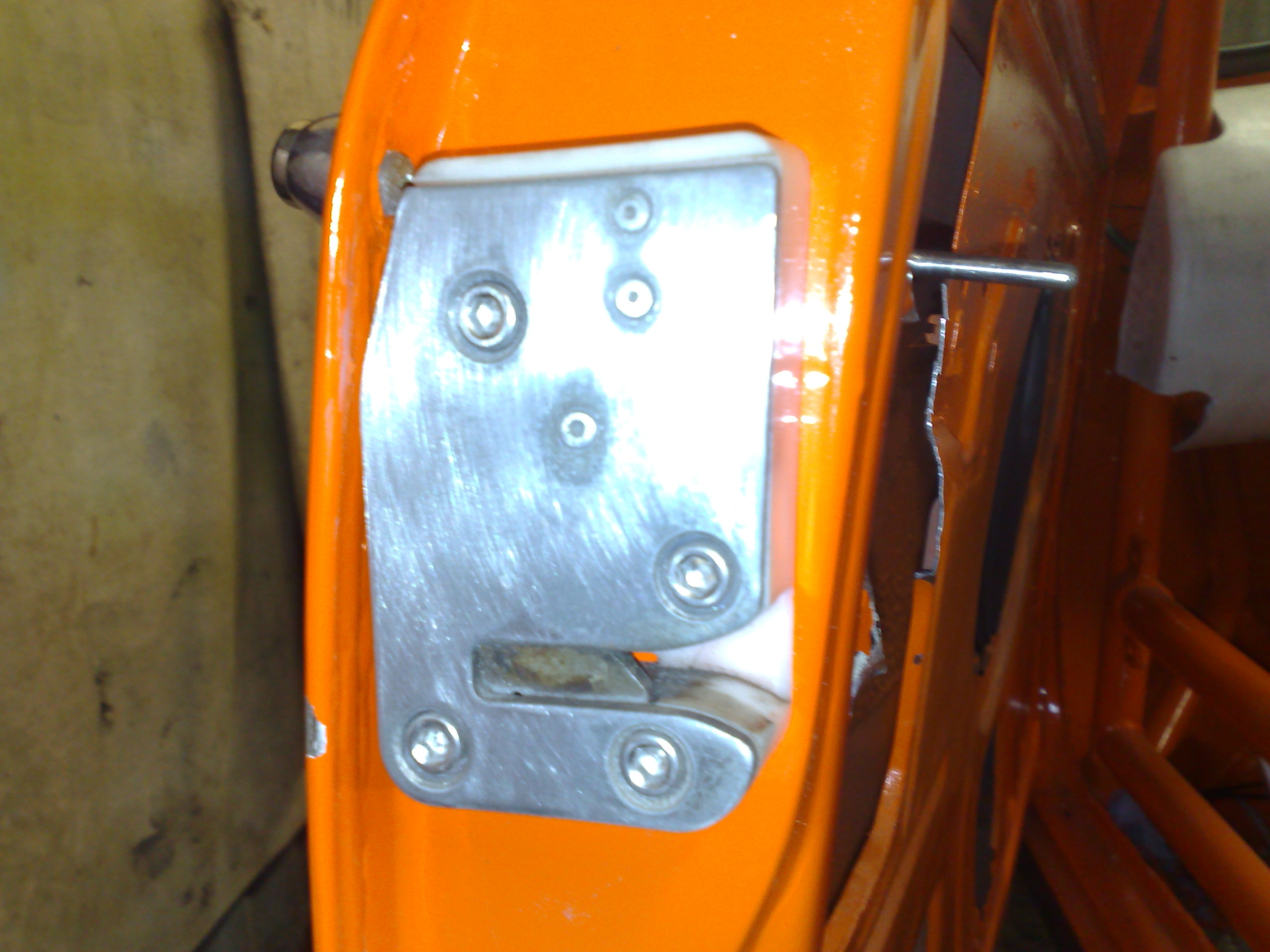

Door Latch
oo how did you do that latch? thats what i want to sdo but wasnt sure how i would get it to work.
how you used the normal mini locking mech, To be honest it could be really self explanatory if i looked at the mech properly but i dont have one to hand.
This opens the door, ive ditched the internal lock, opening and winder mech.
Weight reduction tha sees!
sorry yeah thats what i meant, didnt mean locking it, my bad. i take it that is just connected to where the normal mech would be connected?
do you flick it up or push it towards the front of the car to open?
You push it up and yes it just welded to the normal mech.

ahhhh simplicity and lightweight....just what im after *happy* top job!

Another quick vid of the motor running, ill add up some pics of my little door latches ect after tea! Its running a tad rich at the mo! It absoloutly reeks of fumes!

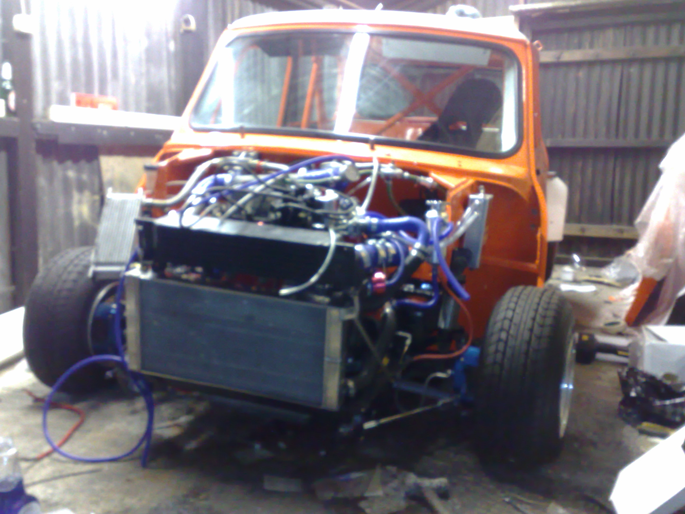

looking good Mike, and all of a sudden i'm a little bit envious of your rad,lol
Wow that is an honour, carl austin envious of something on my car!!

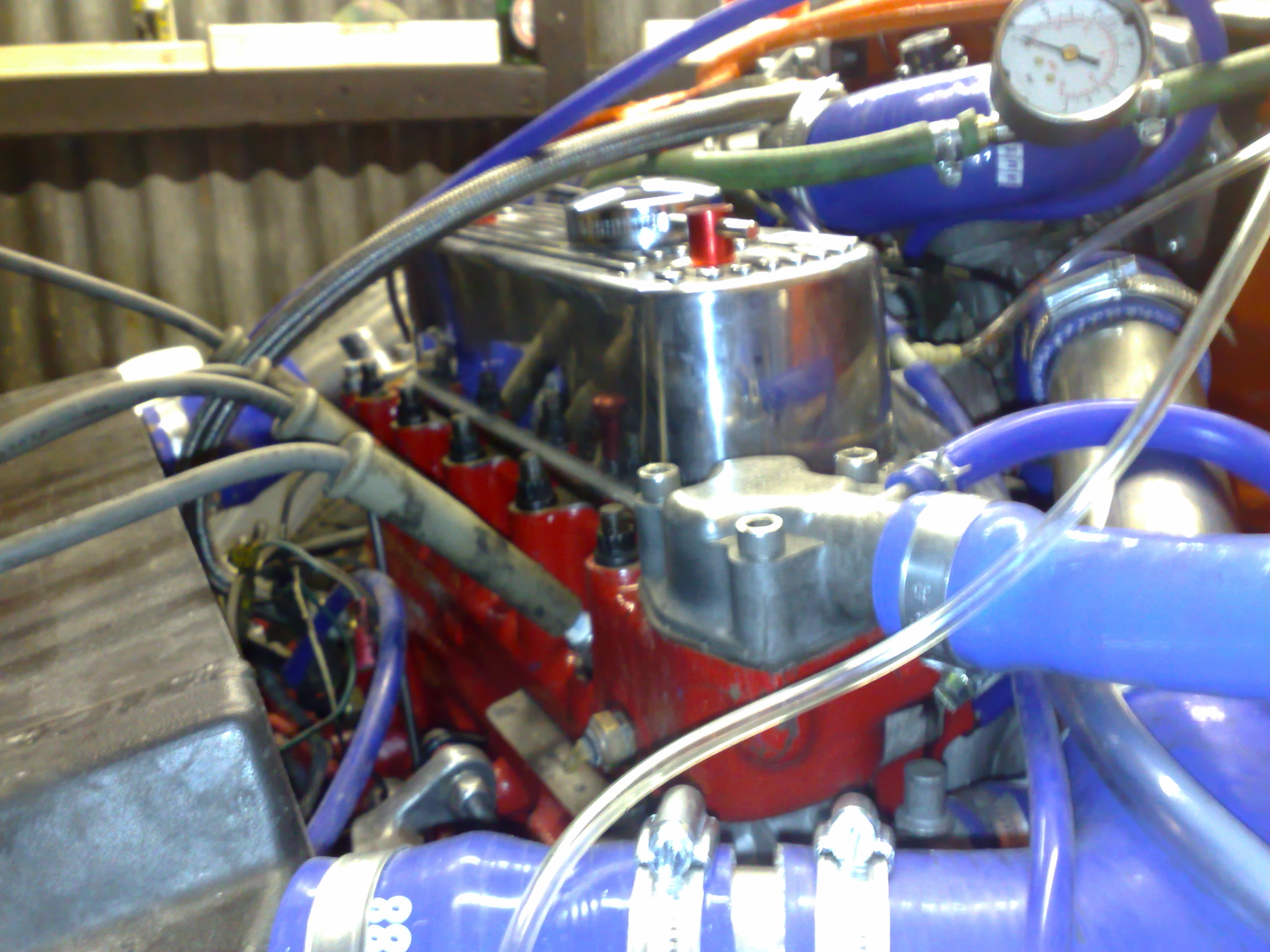

Mike that looks amazing!
Where did you get that flask type header tank if you dont mind?
Somewhere off ebay mate, cant remember where though.

That is looking the business Mike!
Good to hear that she's alive.
6301 Posts
Love this car. Really looks fantastic. Well done mate

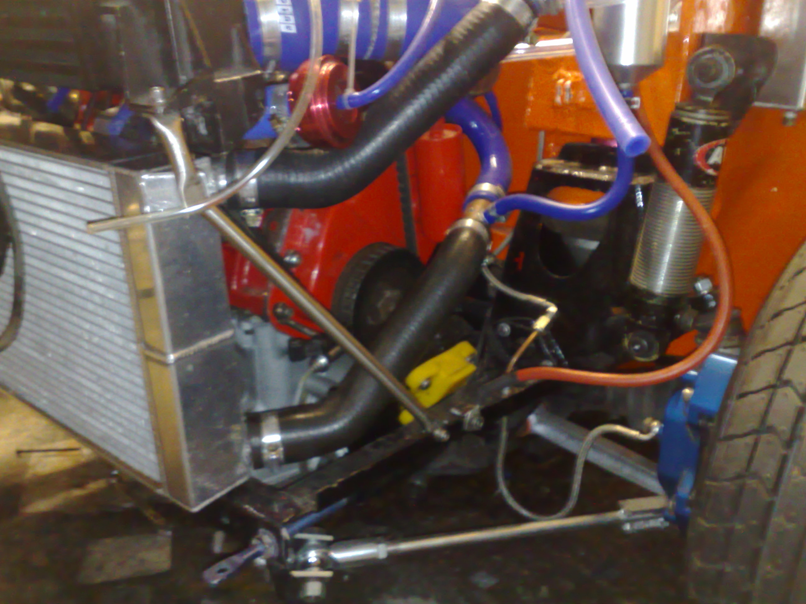

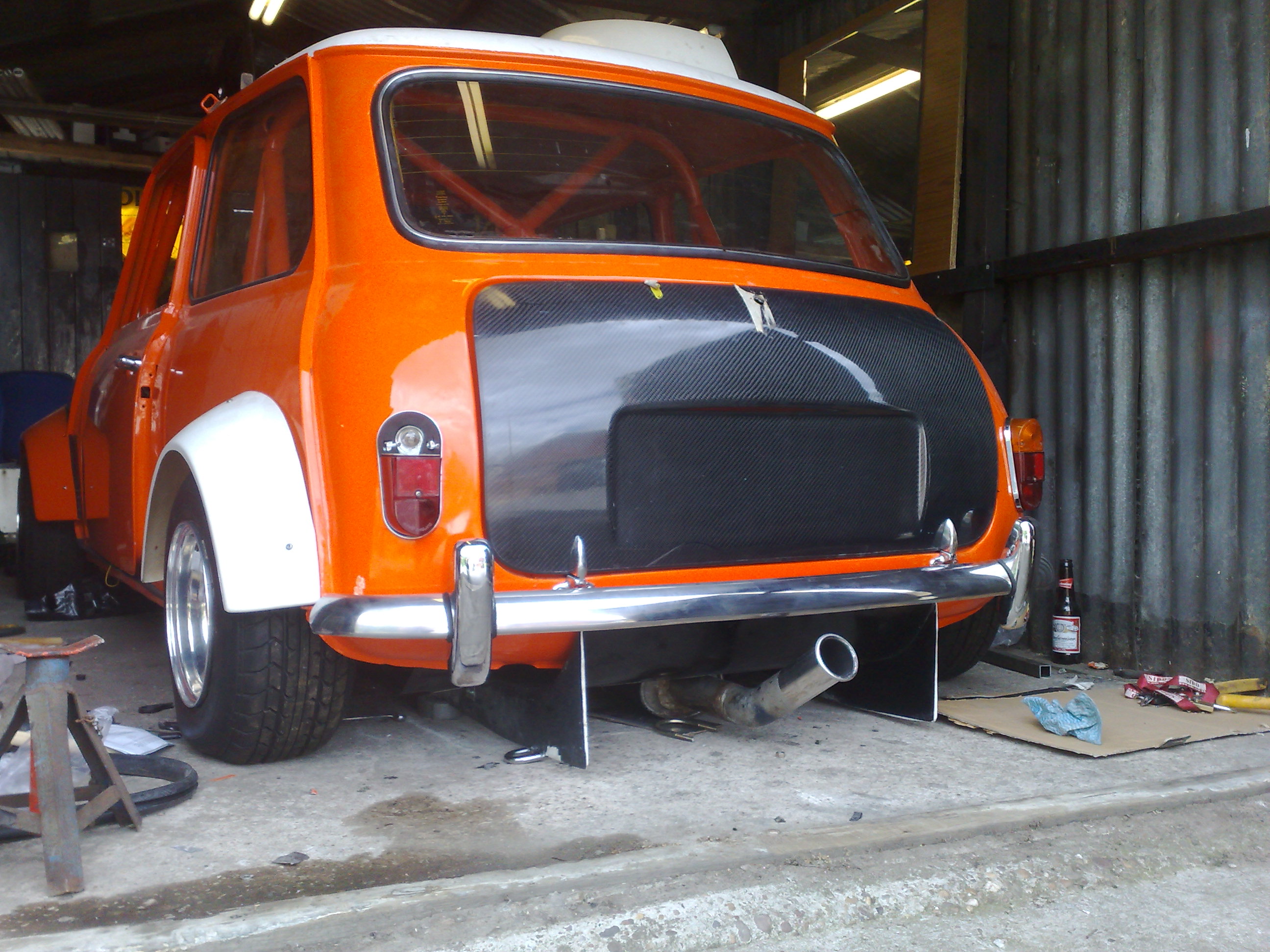

quick question though, will the car not fail its MOT as there are no brace bars on the subby ?

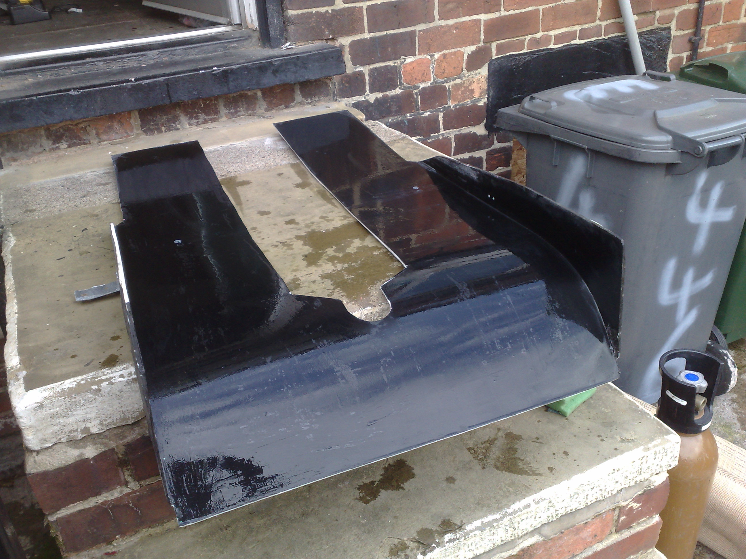

On 17th Aug, 2009 Jay#2 said:
Ahh, i am in the midst of constructing these, similair sort of thing to the standard ones but they go down to the top of top of the subby and to the bulkhead not the inner wing! This is due to having tanks and resevoirs there instead.
