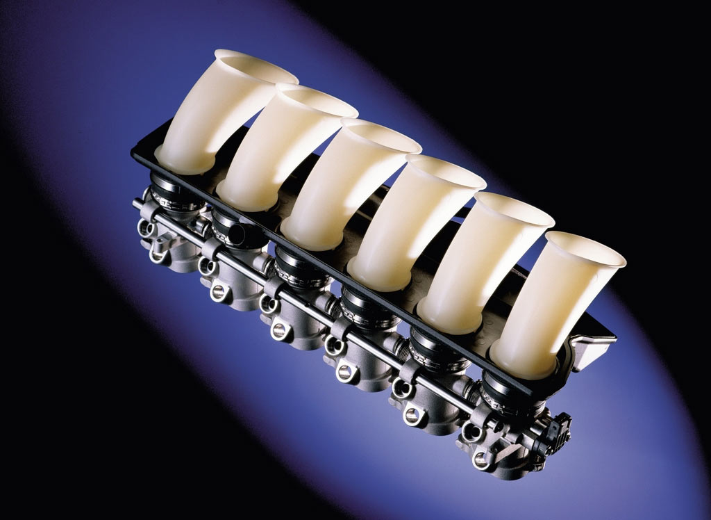

I think you should not be worried too much about even tilting the throttle bodies a bit (as the runners maintain the injector to port angle and that is probably something you should not upset, unless you want to spend time on that) using a short bit of long radius pipe to bring the TB's parallel to the bulkhead and use a shorter ram pipe.

Yes you are correct the injector is placed downstream of the point where I would angle the ITB manifold up slightly so hopefully won't be a problem, but as I mentioned thermodynamics / engines isn't my thing. A friend of mine works in engine development and basically said if I can't or don't intend to measure flow / tumble or any effects on injector flow / patterns (i.e. do it properly) then try to make the inlet path straight as it is rarely wrong to keep the path straight, but you are equally likely to be correct that a gentle radius wouldn't upset things but it's such a slight angle change (literally a couple of degrees) I am happy to live dangerously *happy*
To be honest I am also now getting close to the bonnet / scuttle if I try to angle it up much more so any change will be slight as I am nearly equi-spaced between the bulkhead and the scuttle, the only way to get more airbox clearance is to make the runner shorter which I would rather not do.

I knew I had seen a solution somewhere :)
bmw s54 intakes..
Bung me the numbers off your turbo and ill see if I have a map.
ps go turbo now and save a lot of time ,as matt says .

Thanks for taking the time to look these up, They look err, expensive and tricky to replicate *wink* But yes if they just bolted on then those darn Germans with their M3 trickery would be just the job :) , strange they all seem to be moulded in white... Almost look like rapid prototype parts, but seen enough photos to show the OEM parts are indeed that colour
