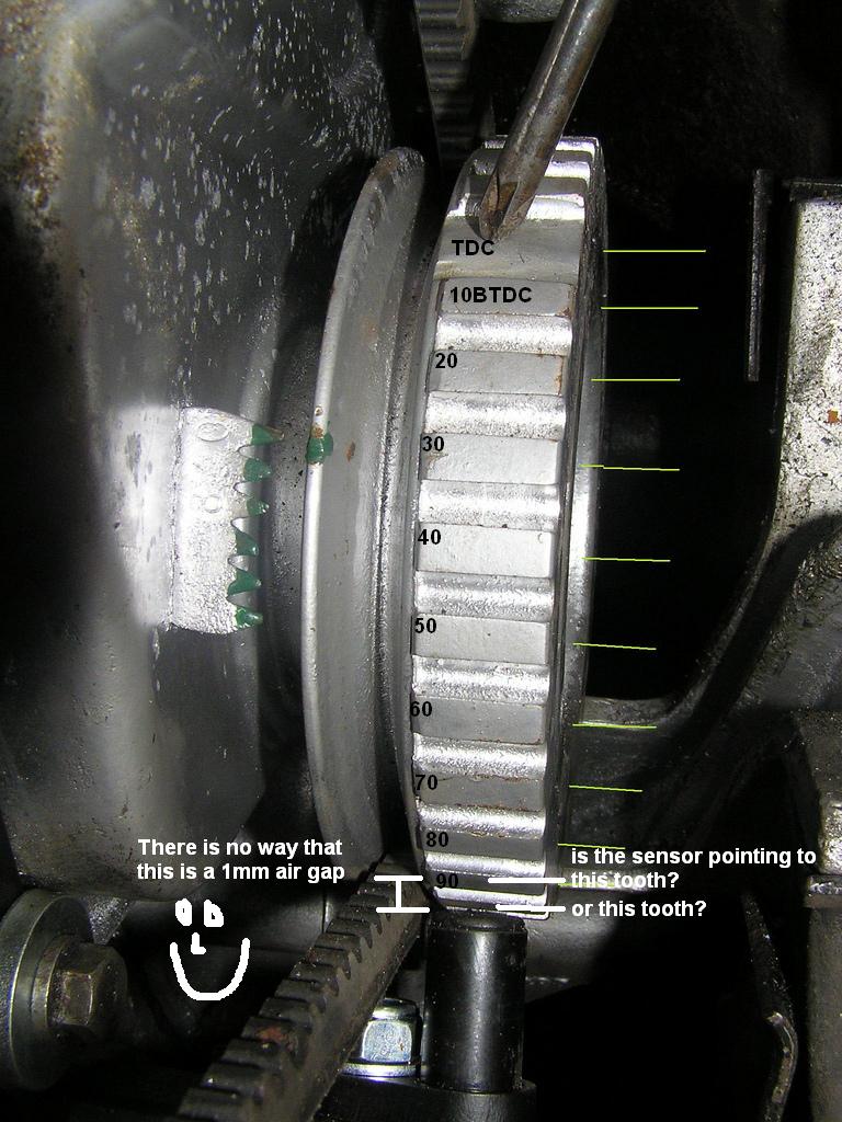

It might be the picture but that sensor looks in the wrong place to me.
It does to me too tom but I haven't been through to look yet.
Looks about one tooth out to me in the picture, although the angle of the VR sensor is a bit deceptive in the photo.
It's got thirty degrees more to go (= 3 teeth) before TDC and the sensor is 7 teeth behind the missing one so total 10, not 9 IMHO.

We set the pulley with the head of, so are confident about the missing tooth. The camera makes the CPS look at a funny angle, but with my rudimentary measuring (a ruller accross the nut) it is sat at about 90 degrees. The bracket is adjustable anyway so should be fine.

No, and it isn't....... I was looking at the TDC mark on the pulley (with the dab of green paint) in the photo and counting back from the TDC marker on the timing cover and it looks like 30 degrees (~3 teeth) BTDC in the photo.
Not a criticism, just worth checking so you can reset it in the software if it needs it.
Mine are a couple of degrees out too, it's impossible to be perfect with fixed brackets and I can't see the point in making adjustable brackets if you can put the offset in the software :)
If you have set it by aligning the missing tooth to the marker on the timing cover, and then placing the sensor 90 deg anti clockwise, then it is in the wrong place. Is it the pulley Phil machined for you?

Thanks for everybodies comments/concerns, but as John says the missing tooth is at the top of the pulley with the engine at TDC. The CPS sits on the horizonal plane accross the centre of the pulley, making it at 90 degrees. It's not very clear from the pictures as I had the camera at a funny angle, but it is in the right spot with a small tolerance in either direction. I was very carefull to check it before I finally fitted it.

by my deduction the sensor is pointing at 100* BTDC

The only problem with that logic Colin is that the sensor is actually pointed at the one you marked up as 90. Like I said funny camera angle. Will get another pic in a little while.

You do realise that the air gap needs to be 0.5 to 0.8mm and the sensor perpendicular to the target tooth?

I wish I had not posted but it really does look like one tooth (10 degrees) out in the initial photo, so please just check it before you run it....

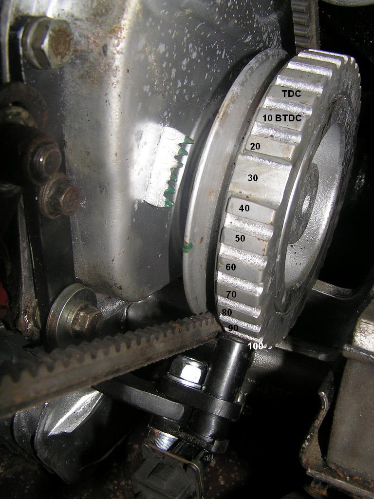

Here's a better picture. The screw driver is sat in the cut out at tdc. The sensor is pointing at the 9th tooth down and is very close. It might be a couple of degrees out, but we should be close enough to adjust it in the megajolt software.
While I had the interfooler pipes of, I fitted the new screenwash bottle. It's tight but it fits.
You can see how close the sensor is in this pic. I haven't measured but it looks like less than 1mm to me. I guess only time and the meajolt software will tell if further adjustment is needed.
If the sensor is mounted with an air gap less than 1mm, its still pointing to 100* Unless the camera you have bends light in ways no other camera does, lol
Shoot me anyway, I am told im wrong all the time*happy*
I'm with Sprocket still, it's on the 10th tooth (100 degrees) not 90 degrees !!!!

Right. I really appreciate that everybody is trying to help out, but...
1) In my picture with the green lines, the camera is tilted backwards so that I can get the whole wheel in. This gives the impression that the sensor is pointing at a different tooth. It's not a very good camera. Because of the metro engine mount I can't take a picture side on as it is where the camera would need to sit.
B) With the greatest respect to everybody that has commented, I can count! I have had my face in the engine bay and counted the teeth, using the fingers on both hands, and the sensor is pointing at 90(ish) degrees. I can get my wife to check for me tomorrow, or use my toes instead of my fingers, but this will not effect the outcome. It is pointing at the 9th tooth after TDC.
iv) Again, the camera angle makes the sensor bracket look miles away from the pulley, but it isn't. As I said, I haven't measured it, but it is less than 1mm.
7) John is coming round tonight to do some work on the van and he will verify, that although I am an idiot, I can count teeth on a pulley...
