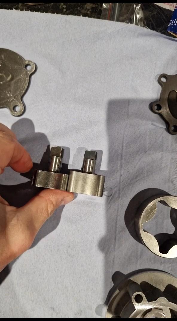

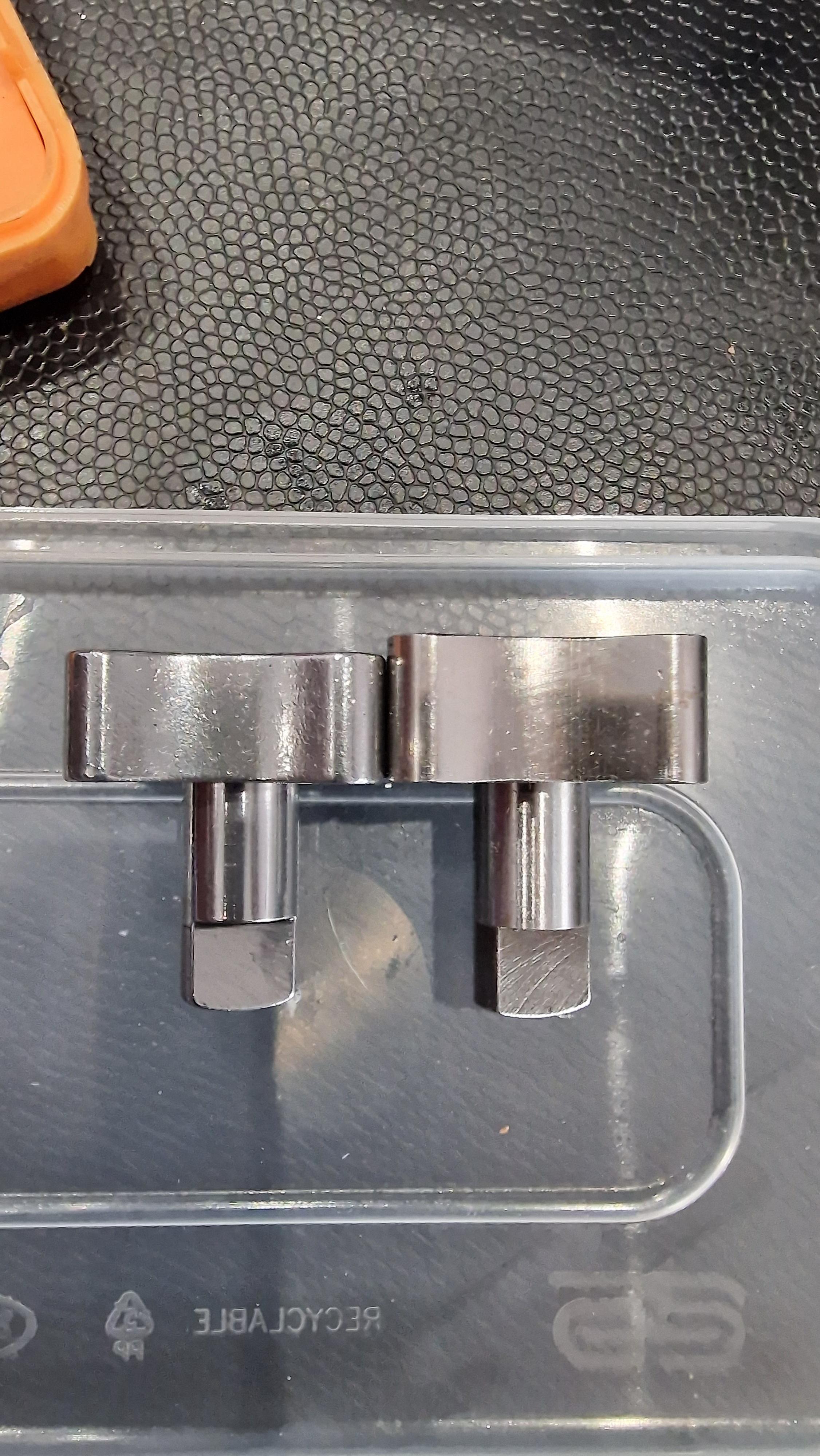

For some reference
KAD pump on the left, OEM on the right.
OEM on the left, turbo pump on the right.
