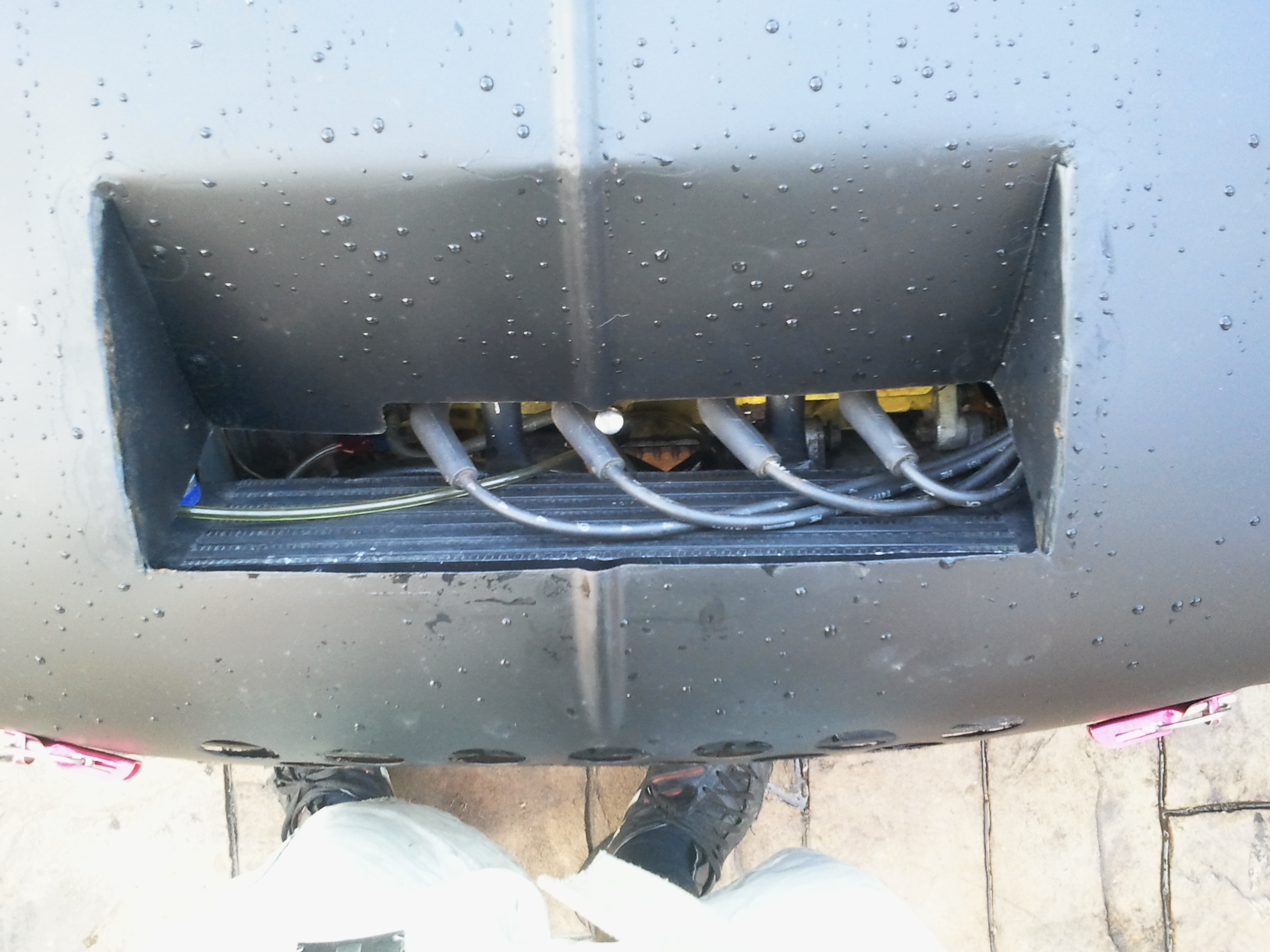

Could you not have one that clips on with some little bonnet pins of some sort? Use some of them draught excluders on the edges? Or a sliding clear plastic thing on runners?
I was thinking of moulding something into mine give the air filter a bit of cool air but I don't want it to look shit lol

looking good mate.
will the grille go on?? or is it to tight?

i rrrrreeeeeeeeaaaaaaalllllllllllyyyyyyyy like that bonnet,i mite just have to see if a vent like that will fit onto my already modifried bonnet,
On 5th Jan, 2011 wolfie said:
John dunno mate *happy*
Jt ive kept it as tight as i could but ideally it needs 2fans or another custom ally rad the grill will fit on but stepped out slightly with a small starter the dizzy removed and a jap alt the fans should go down back of the rad and grill on the front
john it should fit mate its deceptive how wide it it there is over an inch removed from the inner edge of the arch both sides
kenny go for it mate make sure it clears the rocker cover mine has a sloped metty one on now

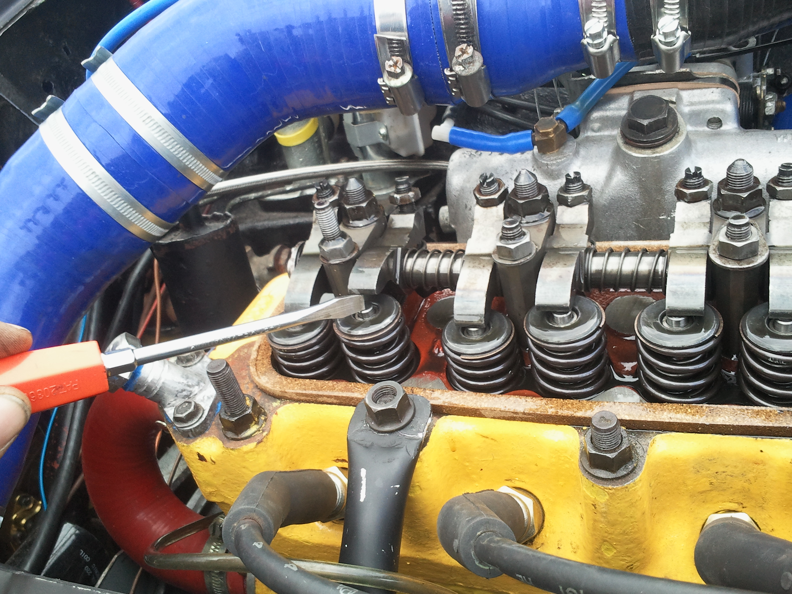

expecting a bent or dropped valve the first ting i did was pull off the rocker cover where coupe found that on no4cyl inlet had a rocker clearance of about a thumb (very technical) the nut had stayed on and the whole lot had unwound!! re set it nipped them all up abit more and it almost fired up ( less the now totaly dead starter motor)
a quick bump start and it was off
sorted lucky escape, decided not to run again and to end it on a bit of good luck so i packed up...

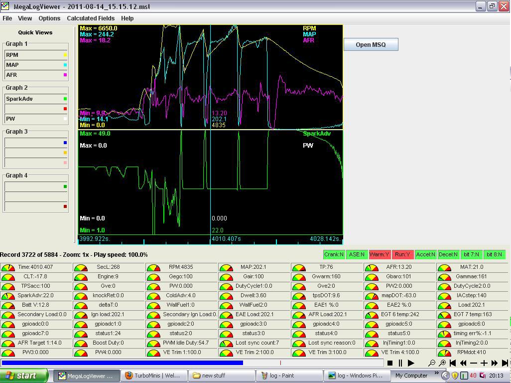

thats the log of the 14.6 against some lad in the binni (if anyone knows who that was id like to keep in touch)
Edited by Brett on 15th Aug, 2011.
well today using Joe C's method of finding tdc i well...er found tdc *tongue* and it was 4degrees earlier than i had marked up ( i measured 9deg last time) and using some sort of logic i worked out i had dialled in the 9degree offset the wrong way making my spark 13 degrees earlyer ( i think) than my ignition map states
meh this hurts my head
basically i measuerd my crank sensor bracket to be 9 deg out but its only 5 degrees out because of the error on my tdc (4deg) plus the fact i dialed the bracket offset in at 81deg btdc it should have bin 99 deg
hmm i think ive been running 13degrees more advance than i though witch would part explain the det at 12psi and 24deg advance (24 +13 =37 *Punch* )
i did pull 10 degrees over the weekend so i must have been running approx 27degrees advance at 1bar ( no audible det) imo i have plenty of head room for more boost :)
would also explain the kicking back and popping on start up ( maybe the 3 burnt out starters too) 23 degrees cranking advance *tongue*
yes i am fooking gobsmaked its still togeather..
and due to the fantastic-ness of the interweb here is that 14.6s run *happy*
