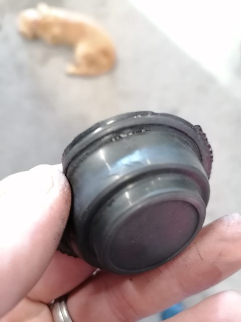

Went through the usual checks but couldn’t get it to run unless I pulled the piston up manually using the damper. So, I figured I’d taken too much material off from too big an area and now the piston wasn’t lifting. Not sure if everyone’s keeping an eye on various parts, but the carb bits are getting pretty damned expensive. Burlen wanted £300 for a new piston and dashpot. Managed to find a NOS assembly for a rover V8 for £70 so waited for that to arrive.
Bingo, back to running with a little throttle, but couldn’t get it to idle, even with full choke. Again, ran with piston raised and throttle. This made me think that the piston wasn’t rising, so I went back on the hunt for an air leak inlet side. I’d applied pressure and vacuum to the BOV before, but only the pressure side off the plenum. But the signal side was able to draw air either way.

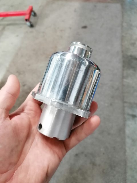

Little bugger to find, but there was a leak.

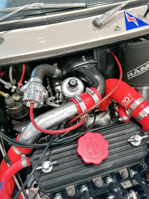

Blocked the BOV take-off and signal line and it started ok. Unbelievable. Did not realise how sensitive the HIF44 was. But hopefully I can now sort fuelling and finger’s crossed I'm good to go.

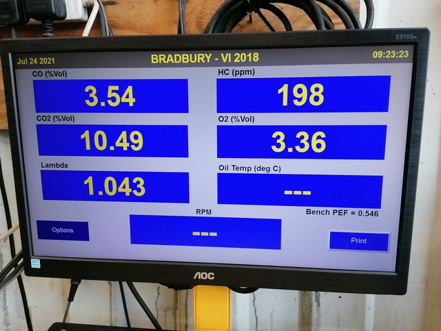

So between the dump valve leak and suspect part lean off pipe, there was considerable inlet air leakage. Now I've remedied these issues, and it runs. But it's rich, very rich.
I assumed this was due to last tune and needle adjustments whilst air leak(s) present, so changed the profiled BDA needle for a bog standard BDD, still rich, and actually worse on HC count.
I know rich is better than lean, but I'm far too rich for the MOT criteria, Even with jet fully up I can't get below 10%CO and 3000ppm HC. So still a way off.

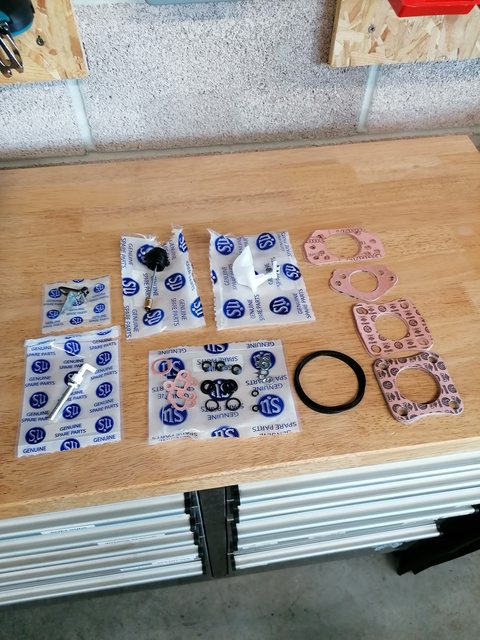

I've ordered another service kit, as my spare jet got pilfered for another job. I can only think that the jet has worn, and is letting in too much fuel regardless of needle height? Also going to change the bimetalic strip and plunger as they are probably original items and unknown history.
I've checked that fuel doesn't flow out of jet with dashpot off, so needle valve/float is ok, float has been checked for height etc.
I've tried my original spring, new yellow and new green, all vary the result, but never enough to get the idle mixture above 10:1 AFR. Changed the oil thickness to slow the rise, but again, not enough and I'd like more reaction for acceleration. Sticking with the 20wt SU oil for now.
I've never had a problem with it being rich before, usually the opposite, so I suppose a nice problem to have. I've been scratching around searching but asides from choke seals (which I'll do this week), I can't think of anymore suspects or remedies. Any help appreciated.

Last week I was still awaiting my service kit so called up Burlen only to find the service kits and rebuild kits out of stock. I’m only 40mins away, so took a jaunt on the motorbike out to see them. The staff are great there and threw together a kit of parts for me. There is currently no stock of the needle valves so that was stopping the kits being available.
I’m sure the choke o-rings would have done the job, but I replaced the jet, bi-metallic, float and damper as they were all worn or of unknown history. All back together and it started straight up. Using the two turns from bridge as base setup it wasn’t a million miles off, needed a bit of leaning out to produce the best figures I’ve ever seen from it.
Took it up the road and it was a bit hesitant on heavy acceleration. I had left the green spring in, replaced it for Yellow and it was happy again.
More for my record than anything else:
- BCA Needle (polished from stations 9 onwards)
- Yellow spring
- 20w oil
- T-Piece trick
- Part lean off connected
Very happy it’s back together and performing, but equally annoyed with myself for not staying on top of the little bits that had clearly been degrading. Mad that there were air leaks and over-fuelling in the right amounts to counter each other.

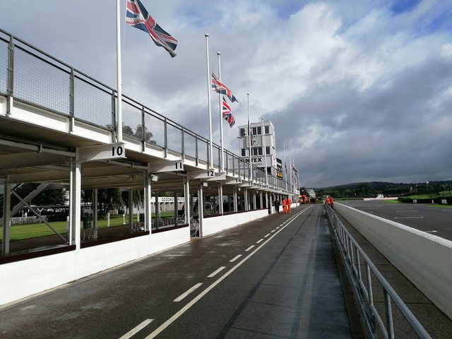

Well conclusion first today, I do not have enough top end for a circuit such as Goodwood.
Regardless, Saturday’s outing to the hallowed ground that is Goodwood circuit was certainly an experience. Weather early doors was appalling, drove through torrential rain all the way.
A side note for anyone that tows… I took the time to measure the nose weight of my trailer then readjusted the position of my car to reduce nose load and it’s transformed the handling, particularly downhill. A simple ten minutes that most won’t give a second thought to.
Anyways, got to Goodwood and finally a break from the rain.
My first visit to an event as a participant, apparently there is normally a separate area for tow vehicles and trailers, but it was not available, so everything was stacked up in the paddock. Everyone has their own covered paddock area for the cars, which was very welcome for the next couple of hours of rain.
I attended the new drivers briefing and has a pit lane walk to see what the track conditions were like. Standing water on the chicane exit as well as fordwater and st mary’s. But likely to dry out through the day.
First practice was wet track and still lightly raining, a sighting lap to try and just stick to the commands the track boards were telling me. Had to snatch second off the line, very slippy. But found my way up to 4th quickly enough. Aware it was not ideal conditions and with a puckered butthole I felt my way around the track. Lavant corner tried to cause me issues and the back stepped out. Luckily, the handling has been so much more positive since the move to 10” wheels and I held it for what seemed an eternity, but as you can see below, wasn’t too bad.

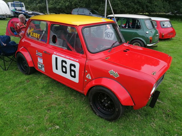

Tyres were coming into play and my faith in the brakes was all time high. Plugs were as good a colour as I’ve seen in the car. All coming together nicely.
First timed run. Bettered the launch again. 3.05. Nailed the shifts up to bunny’s leap. Linked the esses well, not too shabby on sawbench hairpin and made it to the top cleanly. The timing board up the top paddock had moved from the Saturday, and whilst staring around for it, noticed one of the other competitors pointing and waving at me. 47.43. I lost the plot. Celebrated like I’d won a world championship.
Managed to prove the run wasn’t a fluke in the afternoon, set a 47.60 with a faster first half split, but really messed up the entry to Sawbench, didn’t stay wide enough and had to climb over it scrubbing lots of time.
By the end of the afternoon it was very hot and the car was not too happy. But still kept the launch tight and split under 24 seconds. 48.90. It’s all to gain at the two hairpins and late braking for the gate, which is easier said than done. Particularly when someone belted into the tyre wall on the first day and the skid marks remain as a horrible eye drawing marker on your runs!
Car is smokier on start-up these days, and the plugs not happy from long idle time pre run, think the head will want new valve stem seals and a general overhaul this winter.
A great weekend, in great company. PB’s and class records being broken across the board. Finishing 4th in our club as fastest road legal car is a first for me. Another Wiscombe next Saturday, and two events at the end of the month make it a busy one, but all down to the wire for the various championships and challenge cups.
So here it is: New PB 47.43
