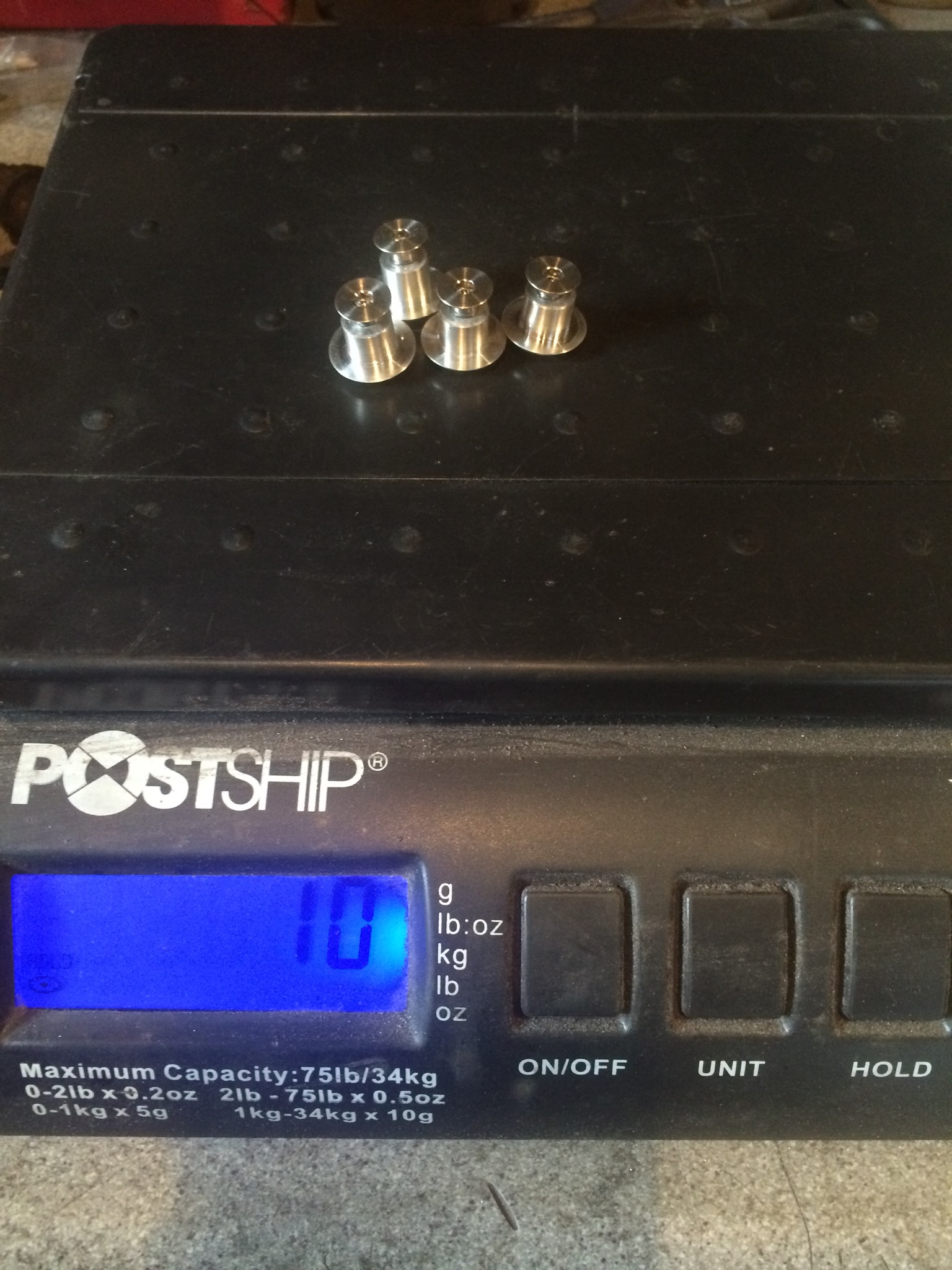

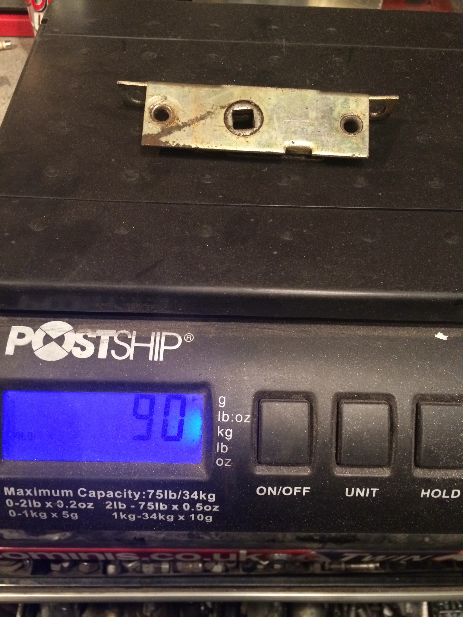

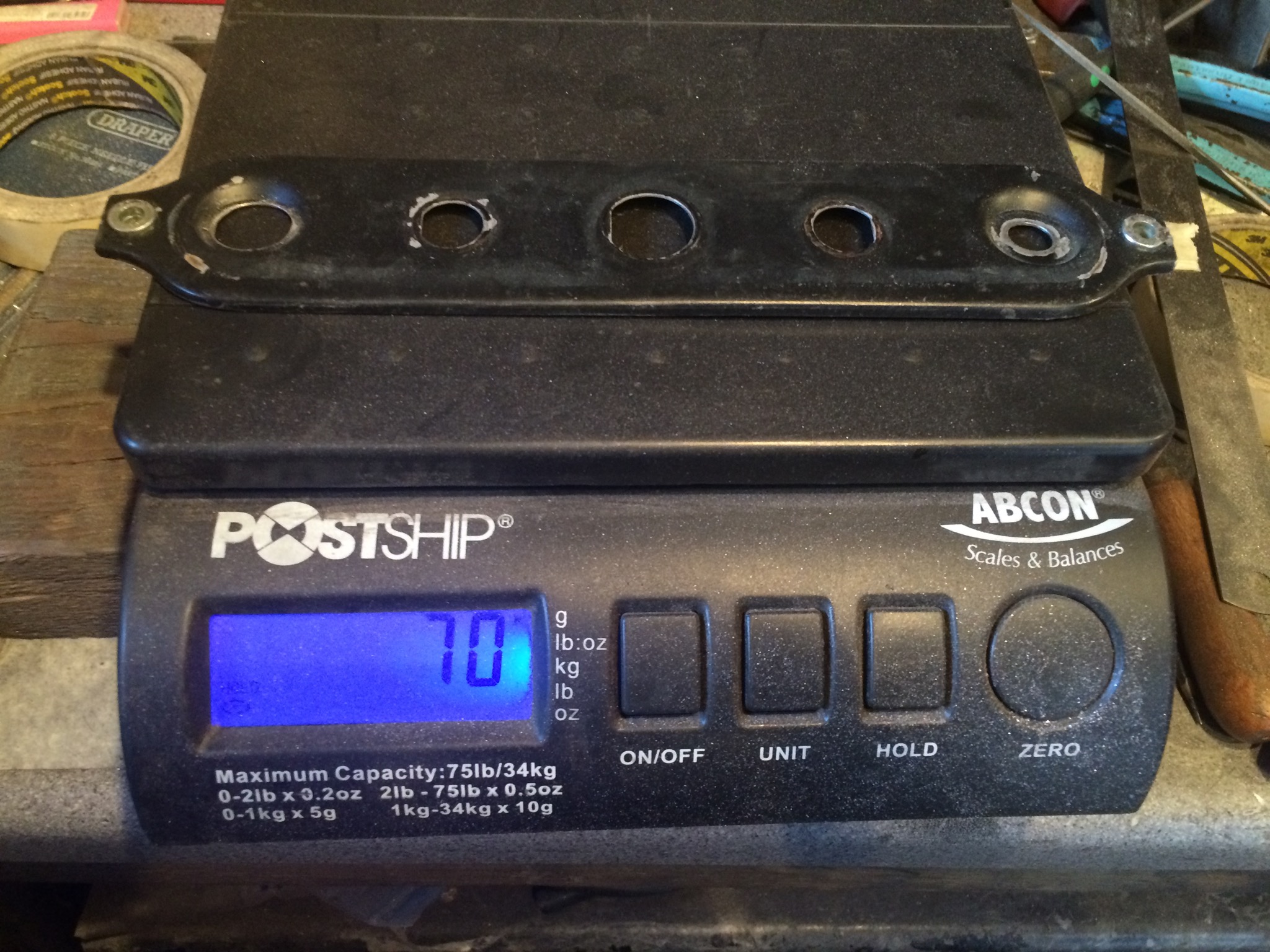

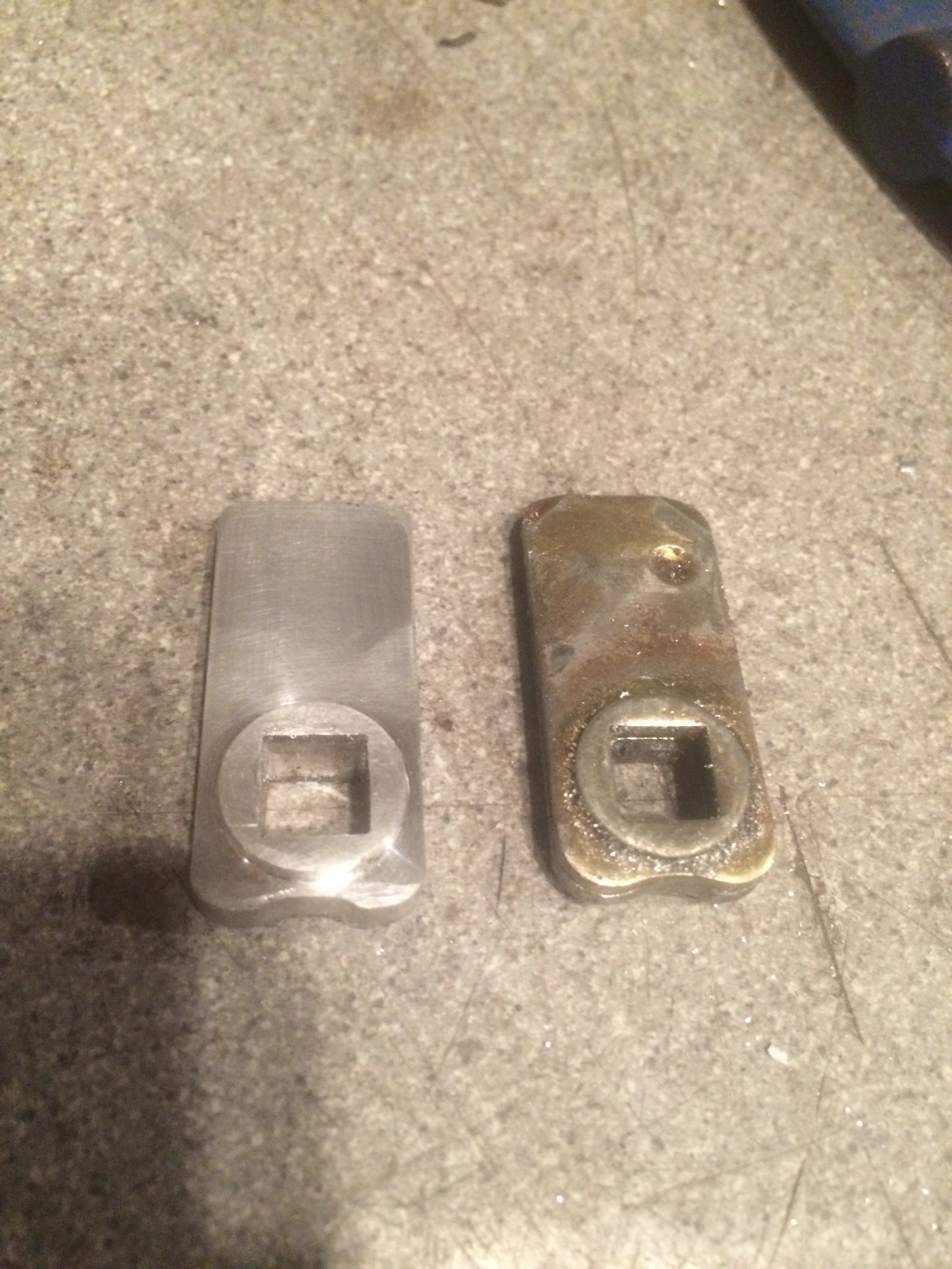

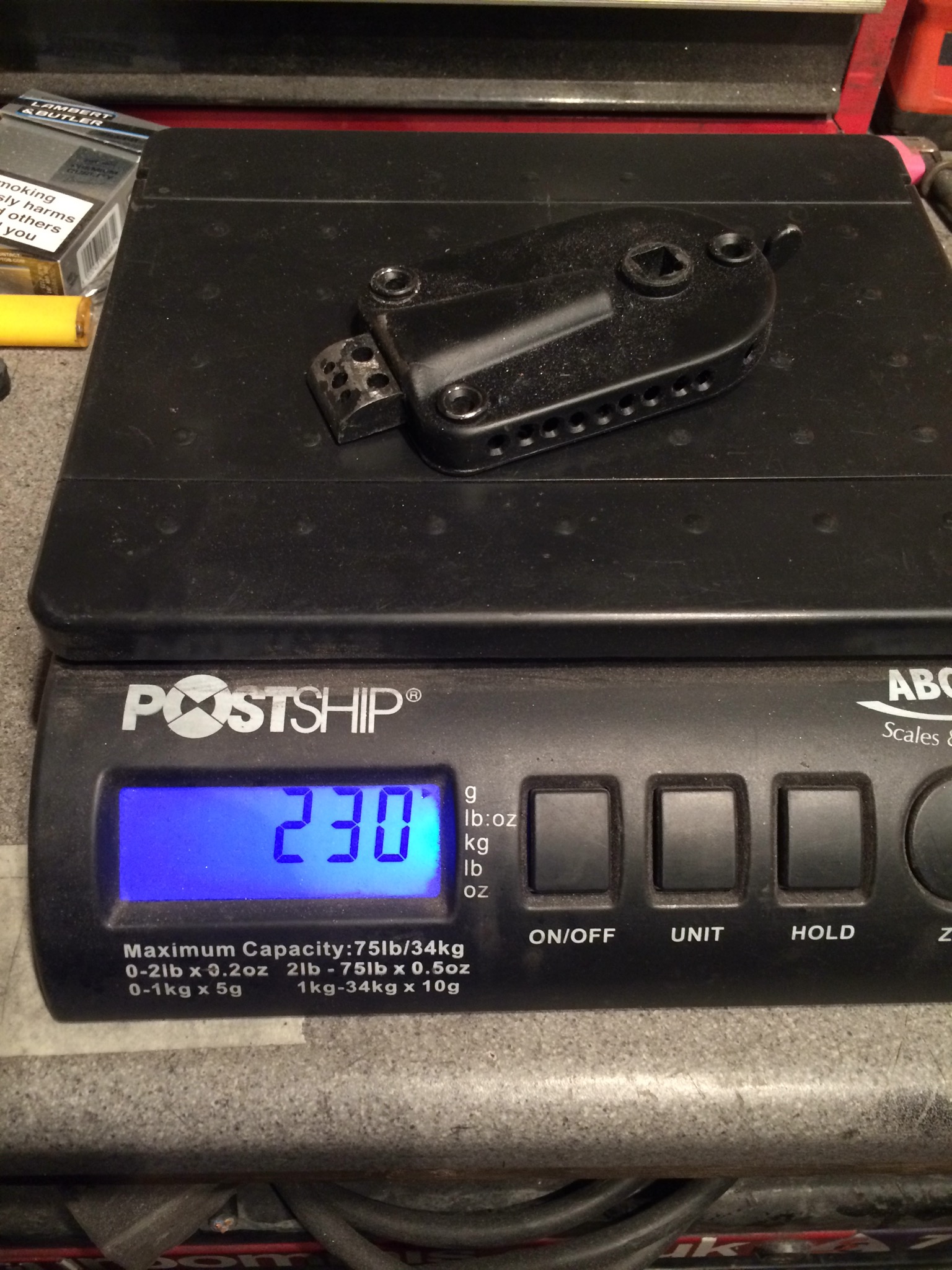

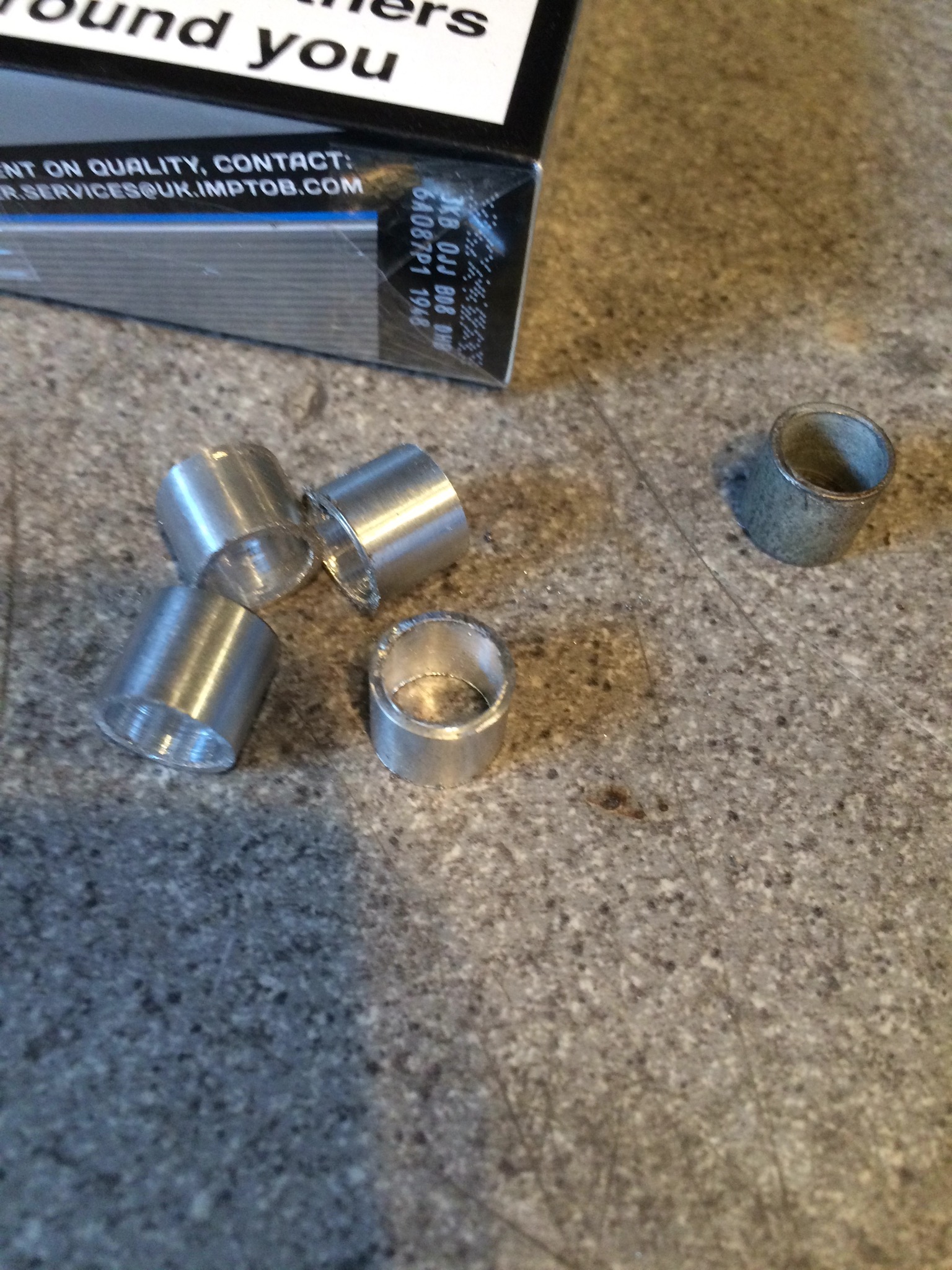

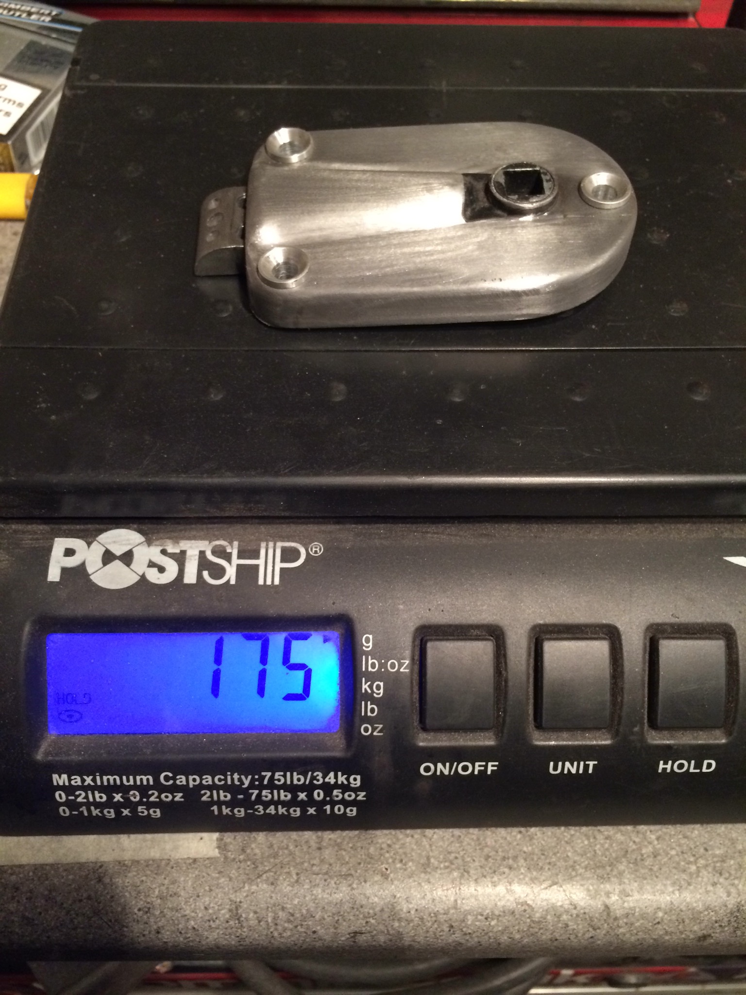

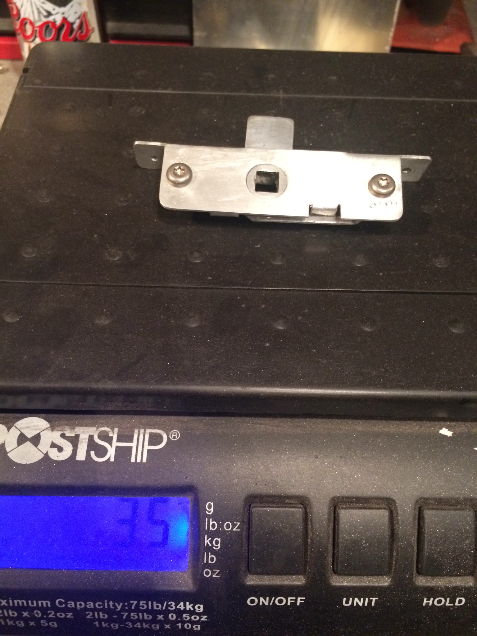

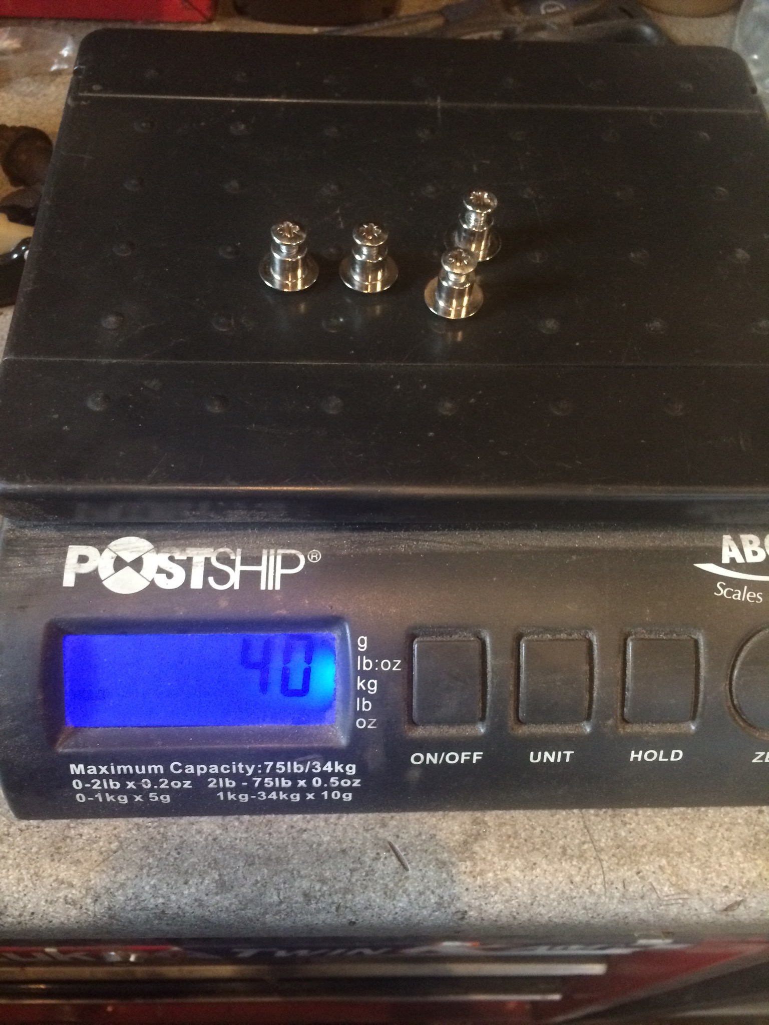

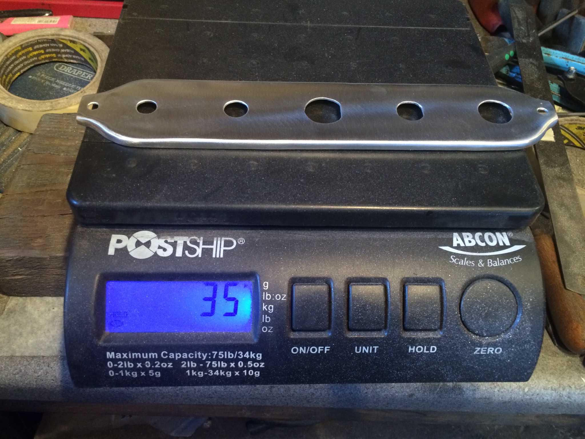

Where has the 50g come from on the timing cover? The amount your saving on literally every component is awesome and will be a surprising total i reckon...

Some of this weekends work..
And more
Dave it's not what you can see it's what you can't see lol.

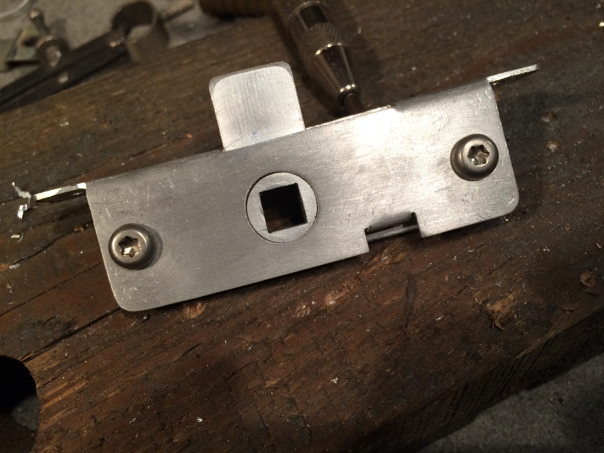

The shell was getting tired and I was never happy with the work on it the first time around, so it made perfect sense to me to re do the body, now Its been opened up like a can of beans there was lots of stuff I was not even aware of! Lots of filler in places where there should not be, 3 inner Flichs was found.. And lots more..
As for reinventing the wheel 🤔🤔 why not ? lol.
cost well we never chat about cash on here, but I only do what I can with out going short, I have stuff I am fitting this time around that I have sat for a long time.

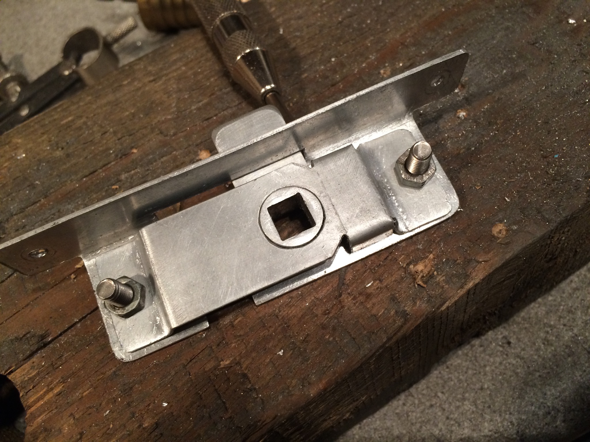

I like the challenge it brings tbh and I love finding a way around stuff, like that boot lock that was 8hrs non stop worth of work and I Finnish it at 01:00 as I set the task of only hand tools apart from the lathe.

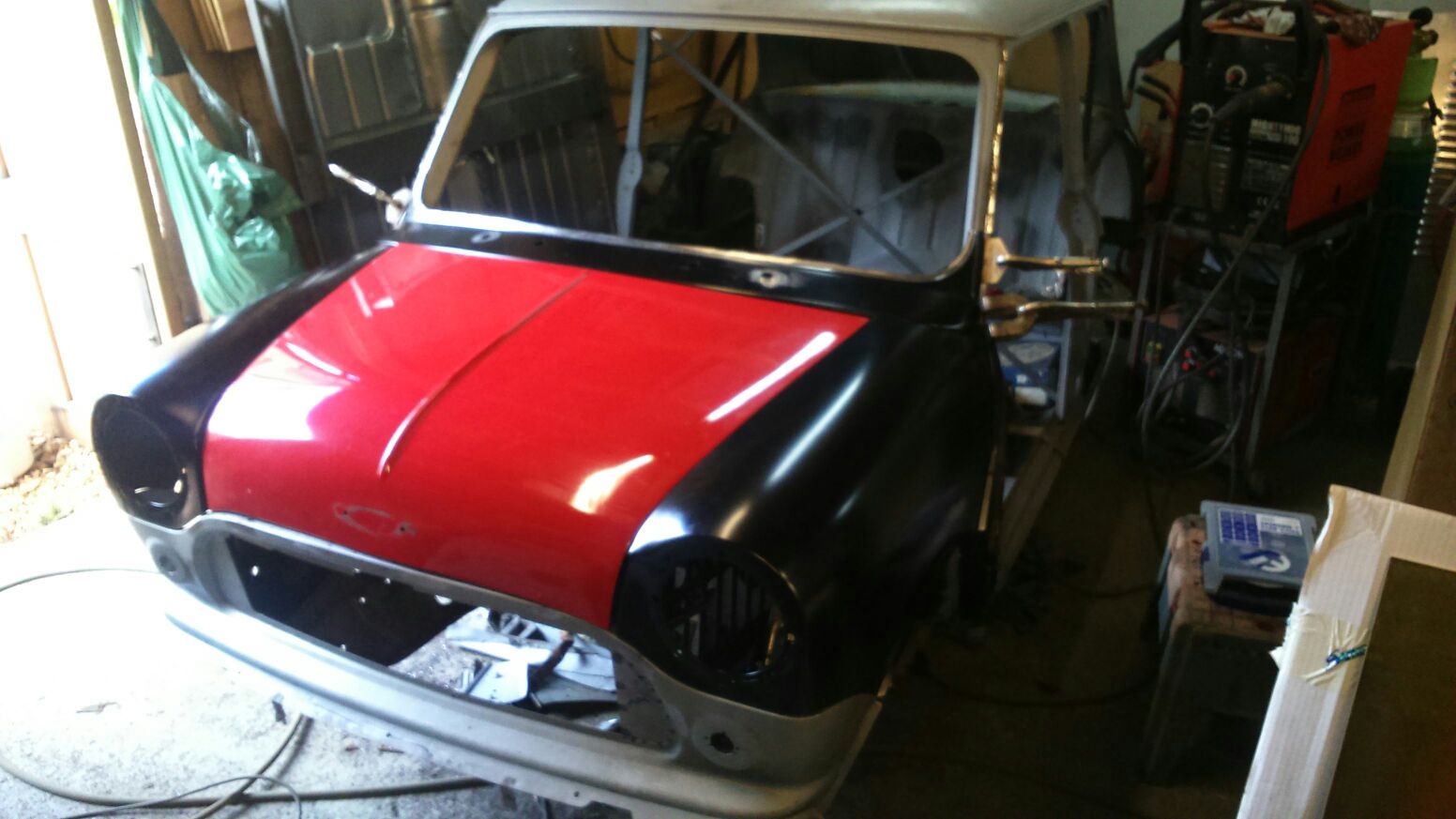

A little sneaky peak at how the mk1 looks

you're going to paint it red and become nic in his final evolved stage?

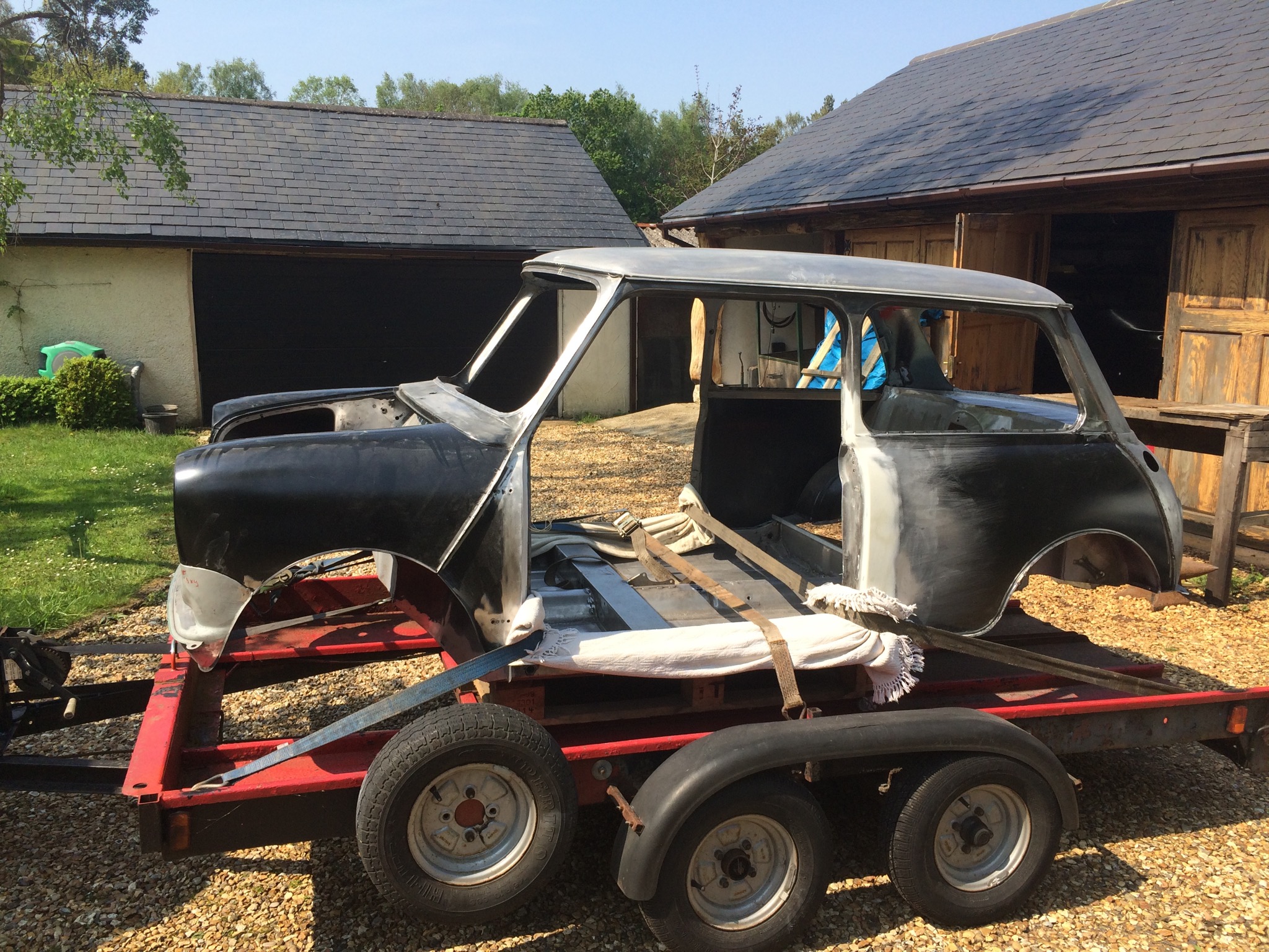

Well chaps,
It's been a long 16 days but it's getting there!
Paul most of the skilled work has been done by a bloke I know, but I have been doing as much as I can on it over the last 16 days, as it was also good to work with someone who can show me some new skills! As every day is a school day.
As I post this the mk1 is at the body shop for its first coat of primer as there is a lot of bear steel on it. Then back for some more work here and there.
I am still on track for my dead line, and just on budget as planned 😀

Looking really good Simon
Makes my 'progress' look like a lazy afternoons work
Looks like you've gone for rally style sill axle stand holes which I plan to do as well, I have the axle stands already, I was even planning to put the rear hole in what looks like the same place as yours as it passes through the stiffener for the rear subframe mounts
I spy some inner sill swagged holes too
Are you going to weigh the bare shell when it's done, it would be interesting as a comparison as I plan to weigh mine when I'm finished, it was 98kg before I started on it's latest diet

Thanks but I can't take all the Credit
Yes mate I am using sill stands, as it seemed like a good idea When the floor was out.
At the rear it goes through the double steel at the front it was tied in to the door pillar.
For sure I am going to weigh it 😂 It would be rude not to, saving weight was the key when the new body panels were fitted, and lots were lighted before fitting.
