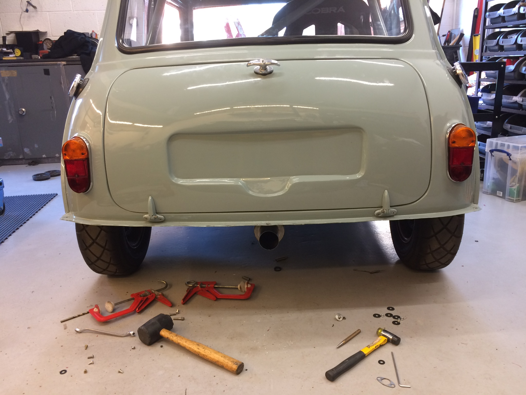

Not much has been happening in mk1 land as I am having a little brake from it, just doing little jobs at night after work tonight was fit the rear boot lid and try and get the gaps right.

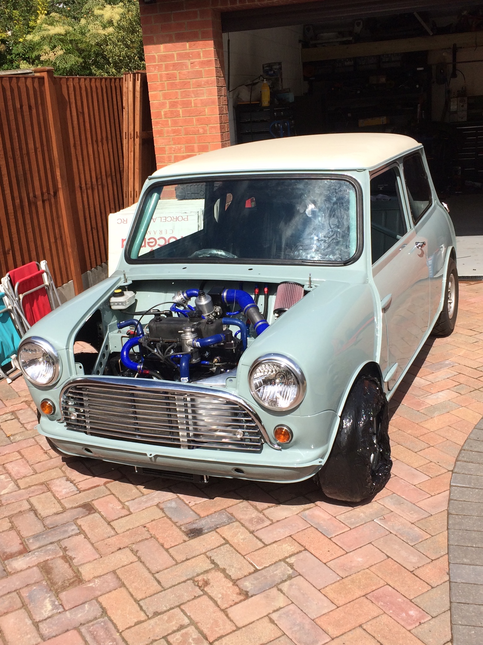

Well gents, this has happened.
The car is not fully built but the parts left to fit was sat in the footwell. I have 10liters of fuel in it and it fires on the button first time.

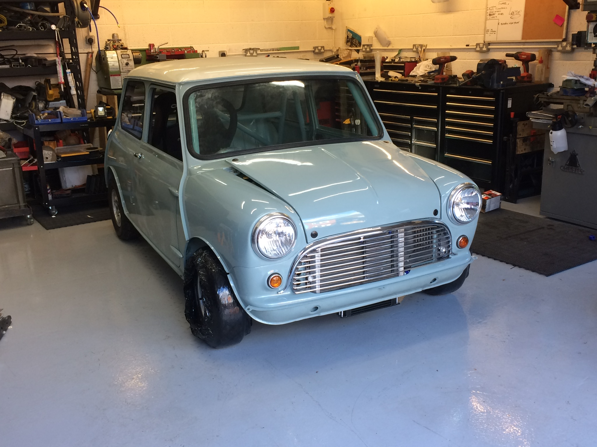

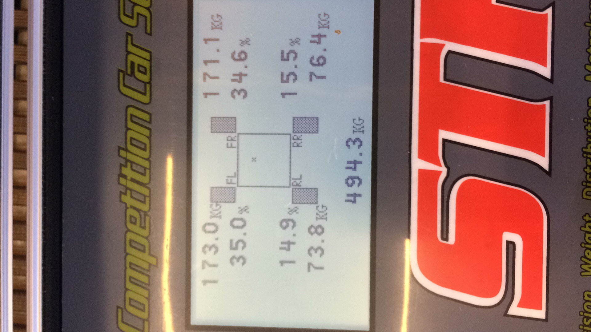

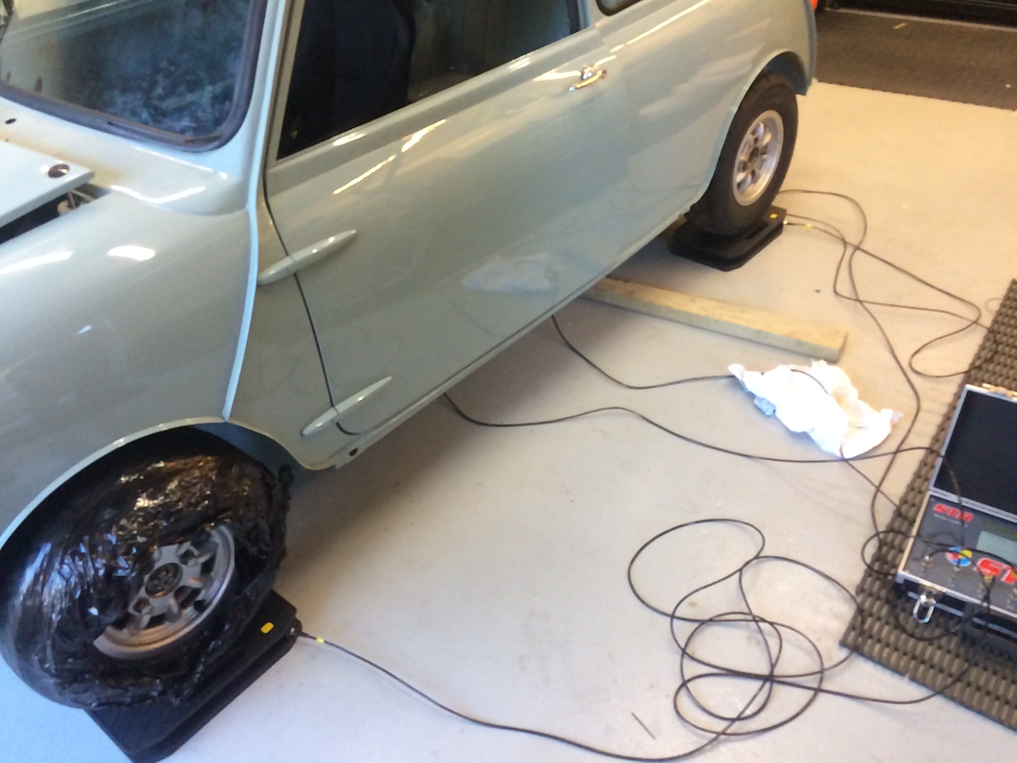

Well done matey, you hit your sub 500kg target and it doesn't look like Swiss cheese!
I think it really benefits from the pukka mk1 floor and that it's still archless and so standard looking
Well done!
Are you going to run a wiper motor i.e. full road / MOT'd spec?
Thank you mate 👍.
Yes it will have an mot for sure, and be driven as and when I can. There is still some bits that I think could be lighter but it will give me something to do over winter.

With all you have been doing I really expected a LOT lighter than that mate
I was thinking the same mate, but there is a lot of cage in there. I think i have found 30kg+ I could remove ie all the turbo stuff 😂.
In all seriousness I was shocked it was heavier then I thought and happy it was not over the 500 mark.
I will be going over every part that's not been remade or removed on the Christmas holidays to see where savings can be found. There is some stuff that I know about that I need / want to remake and I know the engine could be lighter in places.

Lovely build! Should you wish to shed more pounds I think the only really easy route left is to go for one of the MS 5port alloy heads...8.5Kg saved in the blink of an eye.
I also consider the oil cooler to be a personal road / endurance accessory, so these 1.5Kgs do not count! 😎
