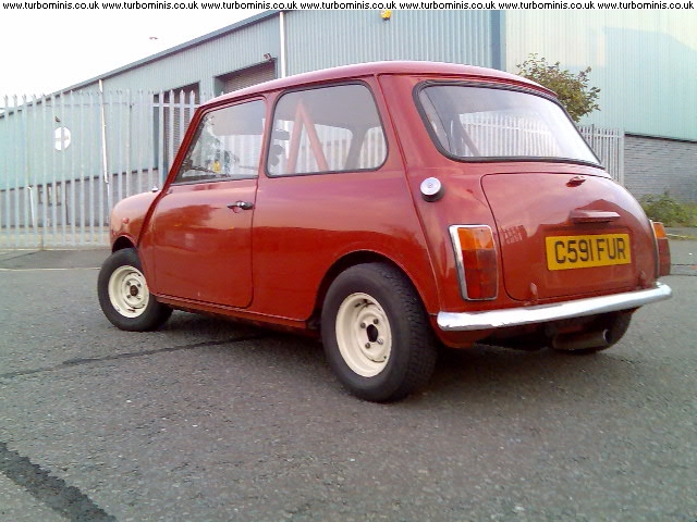

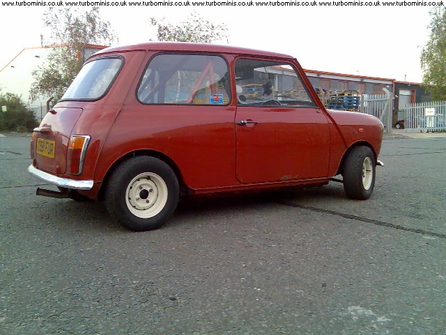

A pic of my fun machine & the mini, i thought the pics were a bit arty :oP

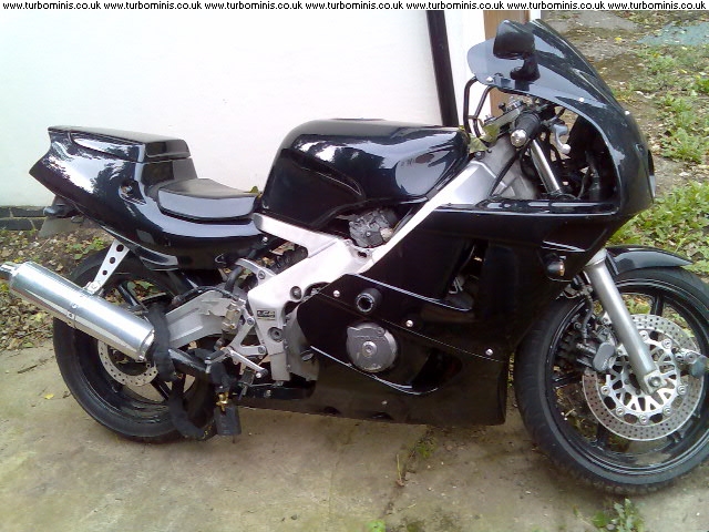

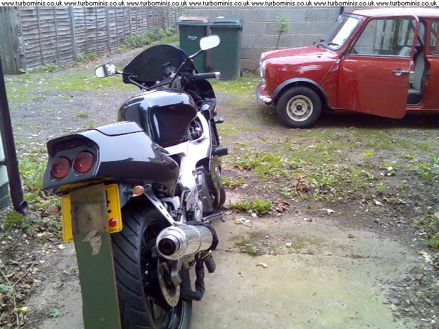

A couple of pics of my bike for all those that have or like bikes, its a Honda CBR400RR "Babyblade"

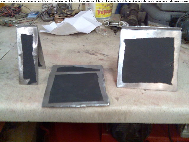

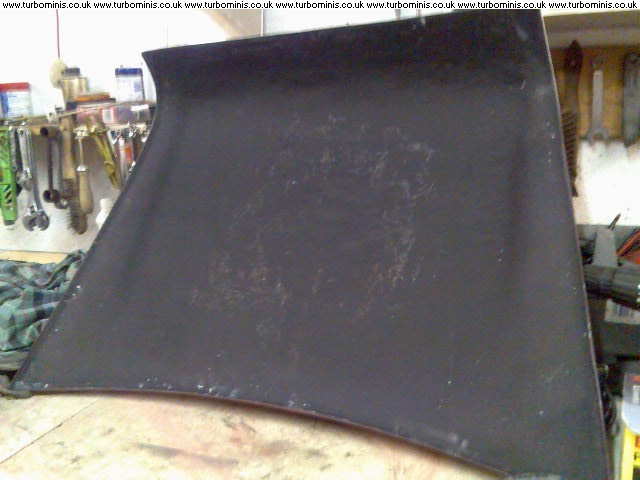

well i'v made up my re-inforcement plates for my rollcage prepped & ready to fit weld to the car & i must add, 3mm plate is blummin sturdy stuff, gr8 for making gussets etc etc

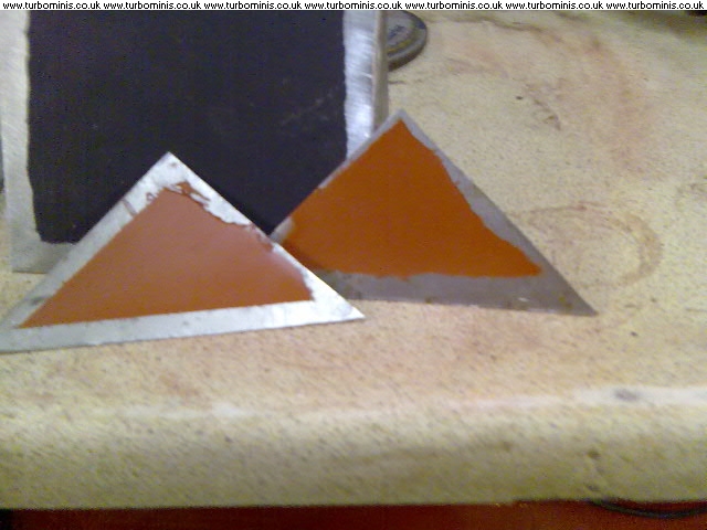

also made some triangle plates to weld to the bonnet & boot apatures so i can fit my grp bonnet & boot with painted on numberplates *tongue*
i'll put pics of those but they are'nt finished yet,

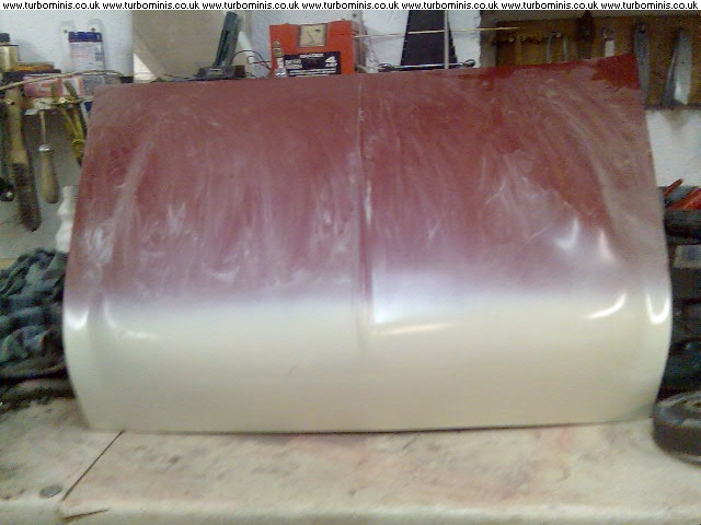

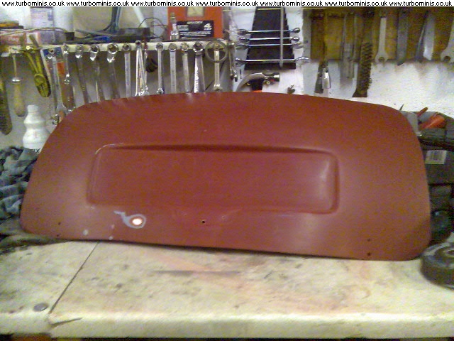

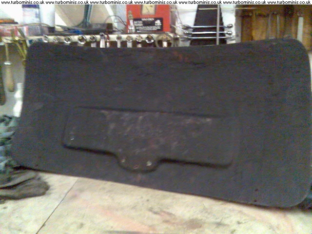

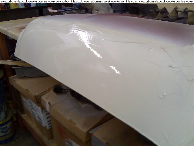

the boot lid only cost me £5 at the aston hall mini show & it was in a really bad st8 with cracks, big chips & drilled holes etc etc but i thought i'd repair it, it cost me anther £5 in materials & paint so worth it i feel, so just have to fit these as soon as i can this week probobly

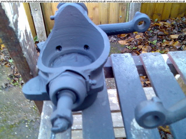

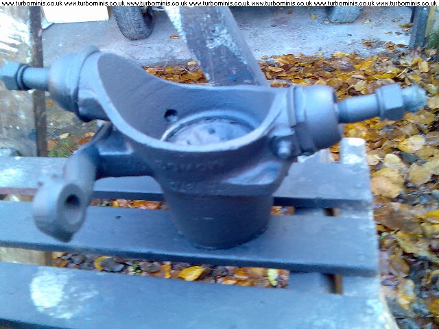

heres my recon hubs, its been ages since i have done a set of these *tongue*
they do look a bit blue in the pics but are matt black, should i paint them gloss? more pics to come

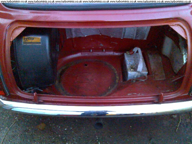

here other pics from earlier, my pc software for pics is s^*t chrikey its cold working on the mini, more to follow this week & thanks for the comments chaps, it keeps the enthusiasm going & wanting it running for avon nxt yr of course*happy*
the body is nearly how i want it, just some minor swiss cheese holes to make in places, Oh!!! spot the old battery charger its 20+yrs old & works perfect!
i'll explain why i've only painted the centre sections of the cage re-inforcement plates & the lil triangles for the grp boot mounts, the reason is just for welding, good clean bare metal & all that & that because the underside is part-coated with paint its to stop the dreaded rust!!! & the bonnet is old english white at the front because its the base colour for my painted numberplate *tongue* paint is lighter than plastic plates i think *happy* aprt from MOT time of course, any comments always apprieciated, cheers again

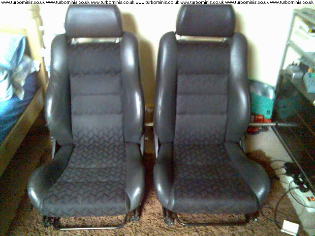

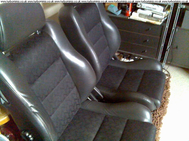

almost forgot!!! i got these for £50 the pair, they are in top condition, leather needs a little feeding on the drivers side, just have to figure out how to mount them, & yes! they are in next to the bed! *tongue* Height adjustible drivers seat which is ace cause i'm a short arse!
i wanted a oldschool style recliners but for the price i'm happy with these, i felt myself & my passenger 'when i have them' need a small amount of comfort *tongue* it'll just have a grp or ally drivers bucket for the trackdays & 1/4mile fundays
any ideas how to mount these would be gr8, cheers

Are they from a Metro or some other Rover?
If they are then it should be relatively straight forward.
Make up some parts that either bolt or weld to the runners which at the front go down to the standard crossmember mounting points and a big [] shaped loop at the back attaching to both runners and sitting on the floor. You can then drill through and fastern them down to a spreader plate (welded nuts help!!) under the floor or if you don't want to drill holes you can throw a leg forward off the [] which bolts through the where the normal loop for the seat clip would go. Just make sure you triangulate it or Mr MOT man will sulk! Iy you really want to push the boat out then you could run another leg down from the middle of the sliders to the seat belt mounting points and run slightly longer bolts for the seat belt mounting!
I have done this several times with MG Metro seats but unfortunately before the days of the digital camera!
I am using MG Metro seats as the basis for the interior on my girlfriends car I am about to start building. If you can wait I'd be happy to post pictures of the mounts. They will be one of the first things I will do as I have to wait for the trimmer to wrap them in cow and at mates rates it could be a long while!!
If they are Metro based I'd be happy to make you some mounts for the cost of material and a drink (cutting and welding makes me thirsty...LOL)

Looks nice mate, exactly what im gonna go for. No frills, well maybe ear plugs *tongue* From the pics it looks like youve painted the tapers on the ball joints, thought they had to be nice clean metal idealy. Hopefully im wrong and they are masked up. Keep it up, coming along nicely. AL

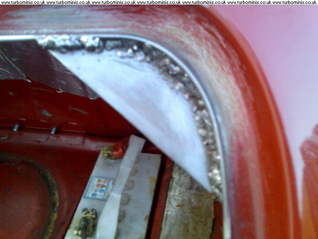

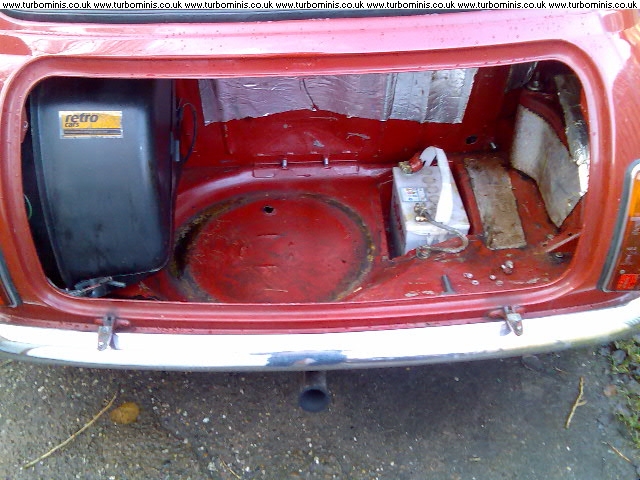

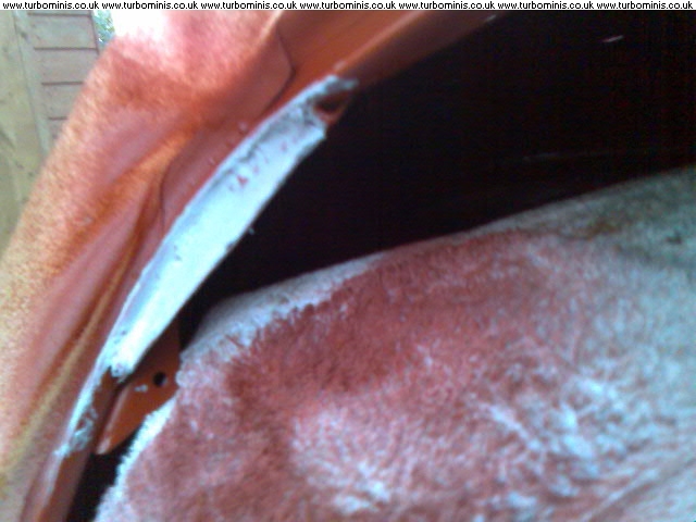

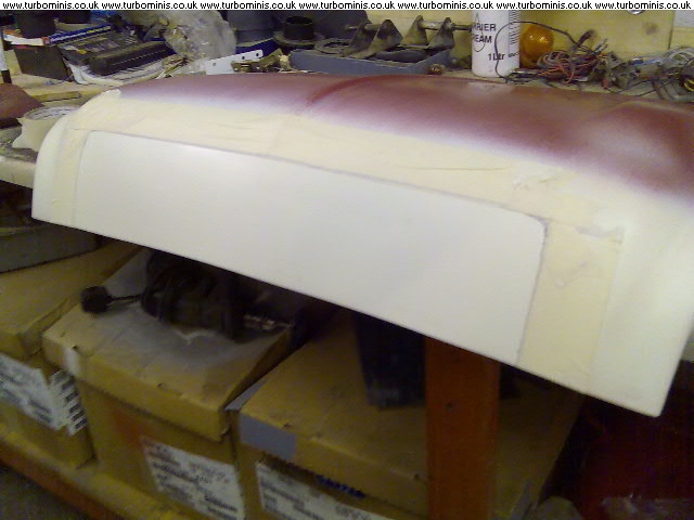

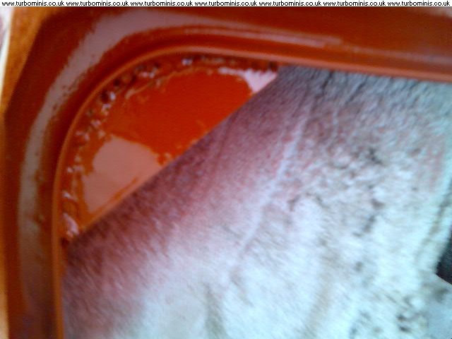

Well i've partially sorted the bootlid mounts, welded the triangle on & prepped bits etc pics below
by the pic below, you can tell i have'nt done welding for a while, it was a bit suspect at 1st but got better, penetration of the weld was ok though!
primed
cleaned up & seam sealed
all fitted

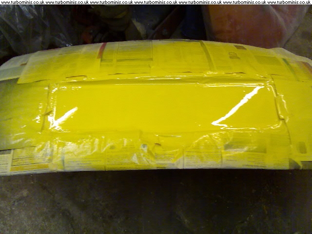

the GRP bootlid numberplate paint basecoat *tongue*
front numberplate area masked out on the GRP bonnet
numberplate area painted in old english white

Just a comment that your number plate backings are supposed to be reflective by law, so you may struggle come MOT time if the tester is half awake and feels picky.

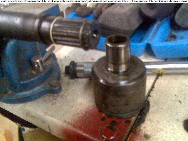

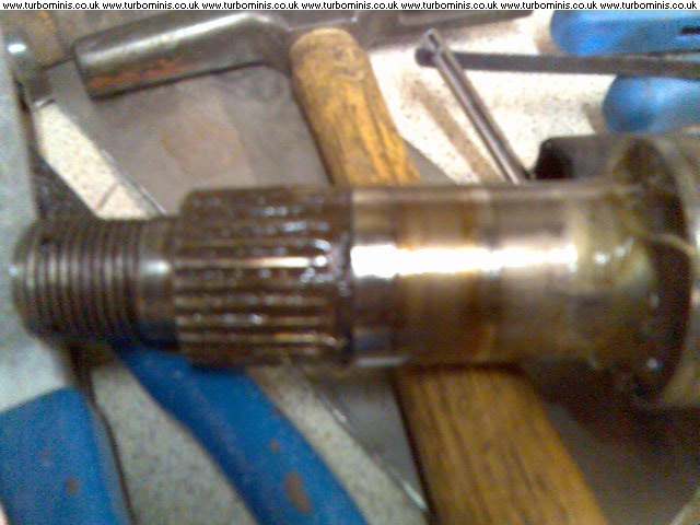

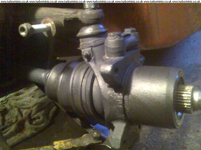

nr coventry

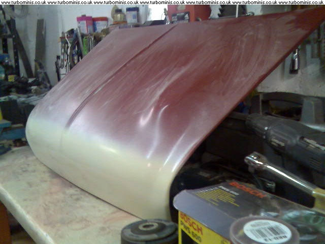

:( Well i'm not a happy lil chap at the mo, my grp boot has a crack 10 mins after fitting it B$&)!$d!!!!!! paint is crap on the grp bonnet n boot, not even a close match so they are going to be red-oxide primer my favourite colour luckly :) my painted-on extra-light numberplates went up the swanny! the paint bled under the masking tape so i had to sand the bonnet 'n' boot again arrrrhhh, & its a bit too cold for my liking, bring on a lil bit of global warming!!!!
also fitted hard polyurathane engine steady mounts & it was a complete cock to get the steady-bar off! enough for me to chuck a ratchet & dent the galvanised garage door quite bad! & the ratchet broke! it was a cheapo ratchet though so not that fussed!

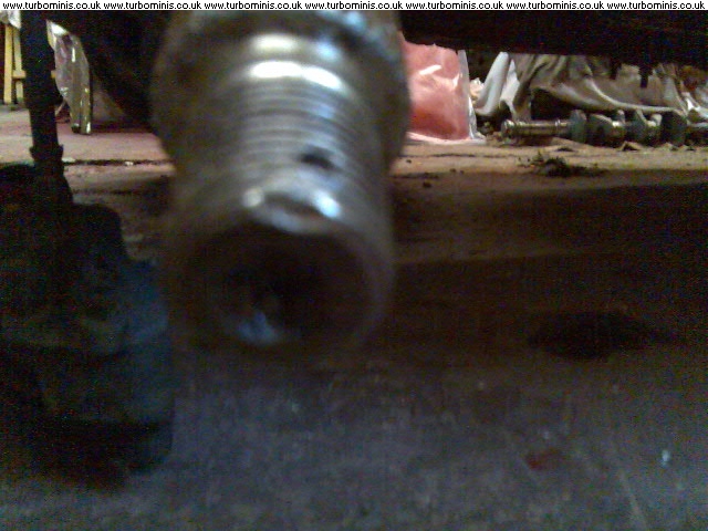

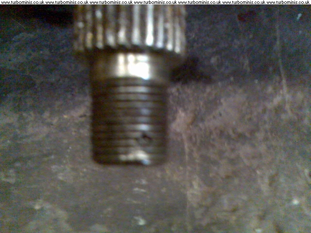

i noticed a knocking on the front pasenger side too! & my top ball joint was slopping around so built some spare hubs up with new bearings & ball-joints cleaned & painted them up, whilst walking round the car with tools in my hands i dropped my hammer on the tip of the outer CV & knackered the threads on it arrrrhhh!why does it go this way sometimes, then i noticed my steering rack boots were shot, they were originals to when the car was built though!!!!!
so i've basicly took the pot-joints, driveshfts & hubs off & replaced everything wear-able including bushes, gaiters, grease the lot, the only thing i have'nt done yet is fit my front hi-lo's & weld in some plates where the dash vents used to be,
pics to follow on friday or at the weekend, i bought a pot-joint separating tool too! & made a tool for getting the inner CV's of the shaft easier, going to check all the suspension over again, re-torqye all the nuts n bolts, weld in my roll-cage plates i made & then the 998 turbo engine build will be the nxt installment i think,
why does all this stuff need doing when its this bloody cold tho *surprised*P
