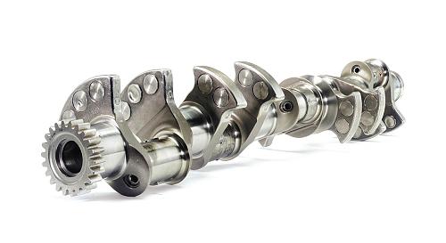

I'd say that the weight of the crankshaft won't affect rpm potential at all. Rods, pistons yes, but not crank. Also, what you need is a heavy crank. Light cranks wears out the main bearings. WHen this is said, the reason to wedge the Mini crank is not to lighten it. It's to move the centre of the weight to where it belongs. A Mini crank is far too heavy on the big end side, and too light at the counterweight side. The best one from the factory is infact the 850 one with proper counterweights.
Have a look at Swiftune's ultimate cranks:
This crank is hardly light, and will of course spin up later than a severely lightened crank. However, what this crank does, is to make the mains survive.
Heavy crank is good, but it has got to be heavy in the right place. This means that Blading is rubbish. Wedging is good and backdrilling is good!
Swifty told me this crank is designed to rev better.
Paul
Compared to what? A seriously lightened crank will rev better, ie. spin up faster. What this will do, is rev better ie. not wear out mains with sustained high rpm race after race. For Carl and his drag-racing, this crank is not the best option. For Le Mans 24h, this crank is the best option.
Rev better...Get them to explain this a bit more. What is better? Faster, smoother, longer etc?
Swifty believes it will have the inertia to spin up quicker than the usual worked A+ crank and sustain it as you have said which will preserve bearings.
Having said that though, apart from them being so expensive I dont have one because Im not sure I believe it.

danboy
715 Posts
Member #: 1381
I think he meant "it has a lower polar moment of inertia which will enable it to spin up quicker"
At least I know what he meant!

6966 Posts
i'm sure youv'e got it wrong dave, a low polar moment of inertia meens it had most of its mass near the centre. which is not the case with that crank, tell me i'm right .,
the debate continues, lol,
this one could run and run,
i think what paul is saying is that swifty is bullshitting alledgedly, as if hes told Paul he " beleives" it suggests he has ne test data to prove otherwise,

Regarding the Swift crank I belive it will improve the Secondary out of balance forces, thus giving the bearings an easier time at high RPM
