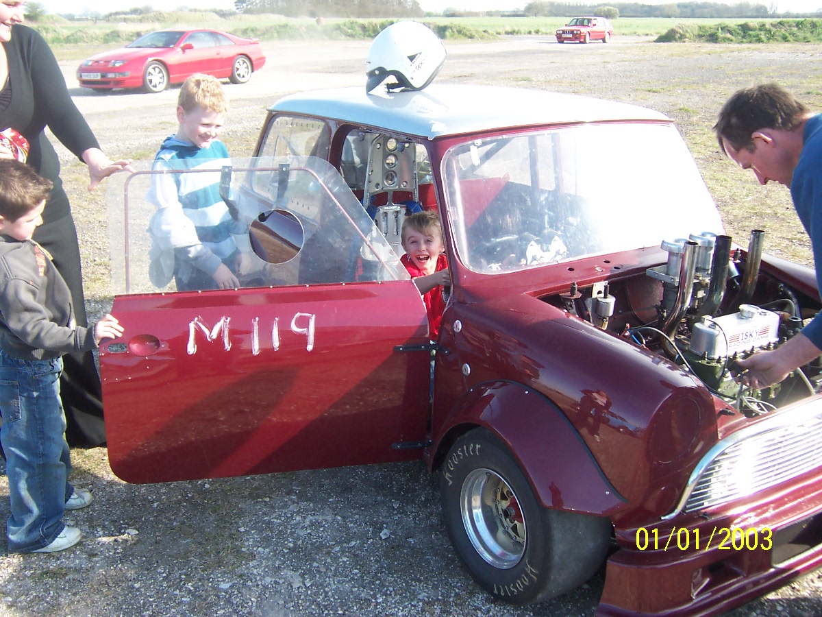

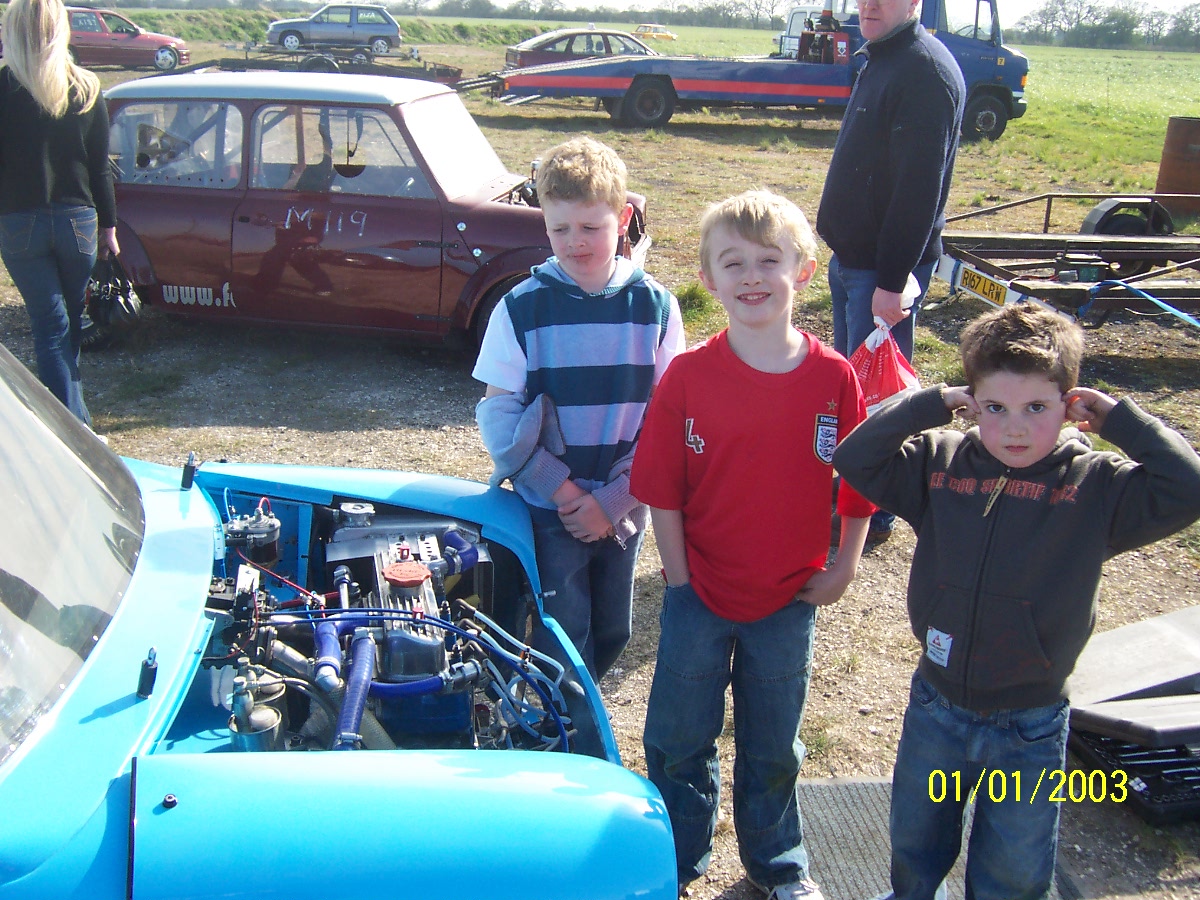

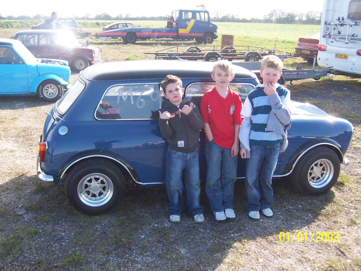

York was my first ever visit to a Drag meeting, I finished up taking the wife and Dan, (my boy) along with his two cousins and their parents. Despite what some of the above posts have to say about the day We all had a great day, Cheap entrance fee, reasonable fast food prices and loads of enthusiastic competitors and spectators.
Regarding Minis I have attached three photos of what I considered the best performing, best engineered and best prepared. (sorry about the sprogs in the pics)
Dan has not shut up about "Carls mini" since we left.
