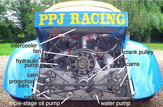

Came on here hoping to have help increasing
knowledge of turboing Minis
We already successfully race a 700 bhp rallycross
car .. obviously not a Mini, but for son/fun etc
plan to use a 1480 block that we already have
plus T3 turbo plus Kugelfischer pump
plus chargecooler from Lotus Carlton
and we've had a lot of negative stuff*frown*
e.g. some said (can't find the quote now)
that it's no good boosting big bore blocks
because of blow-by! Get real! That was
a prob 15b years ago but now with the
technology and dosh, you can have
liners with perfect geometry, nice
pistons with steel gas-nitrided rings
with Napier style profiles and
ductile steel too ... the higher the boost
the more the ring is forced against
the liner.
Torque plate honing to avoid distortion
when torquing down head bolts is crucial
We can blow big-bore engines OK
Just wanted some +ve stuff re: Minis
Going ahead with the project ... ignoring
the detractors.
Thought someone might highlight
potential clutch and gearbox probs
AND SOLUTIONS.
We have seen the drag-Minis claiming
280 - 300 bhp and so IT IS DOable
We have drums of very hi RON fuel
We regularly boost a big engine
to 2.2 bar .. max 2.5
BMW boosted their 4-pot 1500cc
engine to 4 bar .. we realise the
Mini block isn't the same, but then
again we're not looking for as much
power. A 1500 n-a engine should
give 140+ bhp with today's technology
so 200+ bhp by using a nice bit of
boost shouldn't be a prob!
Vee haff ways of making it verk!

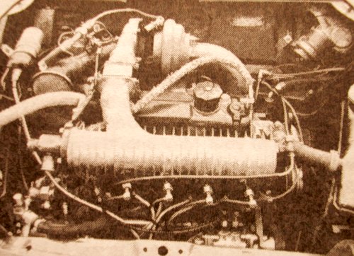

As for power achievable, almost 40 years ago
using crabby Heath-Robinson technology, Alec
Poole got 180 bhp from his 1300cc Mini with a
carp turbo and NO intercooler .. and had to put
fins on the inlet plenum to keep it below 110 deg C (quote)

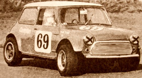

Thanks .. we use 117 RON all the time for our main race-car.
BUT .. sticking with MINIs and the 1480 block (with knackered head) that we have acquired .. here's some theory for you guys
to chew-on ...
1480 cc .. at 100% VE should give around 150 bhp, other things
being equal and excellent.
So we have, theoretically, 150 bhp at n-a 100%VE
Alec Poole got 180 bhp from 1300cc in 1969 pretty
reliably despite not using an intercooler or charge-cooler
and with a carp turbo
so 1480 cc .... .. 150 bhp n-a i.e. off-boost .. so at 15 psi gauge boost i.e. 1 bar .... what bhp can one expect to get from this
A-series Mini engine??
200+ surely????????
There are about 5 guys on here with reliable 200 banana engines, I believe, but they wont blow their own trumpets.
We call it bananas rather than horsepower because the Dyno figures are estimated to vary by about 30% between different places.
I would junk the 1480. You will have major problems with getting pistons to allow low enough compresion ratio for high enough boost to make 200 bananas.
Plus the 5 port head will mean that you will not gain much from the extra 100cc.
I would also junk the mechanical fuel injection.
In fact you whole idea seems of little merit! In my opinion.
