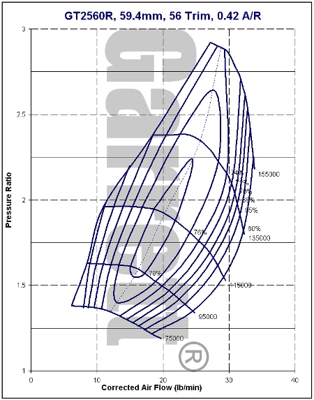

its a 215 odd bhp turbo on the zetec .so would suit a high end 16valver or full on matt type a series , its turbine housing is a bit big for good low rpm response ,but for mid to uppr should pay off with less back pressure , this would be a good step up for the 16v that need to get inot the 300 bhp bracket i feel .its deff worth a try ,just dont expect boost low down .
this appears to be similar in dimensions ,looks like a stonker for something needing 320 max bhp ....which is where the 16v's should end up .*wink**evil*

Well, this looks to me, like the best ever opportunity to de-bunk the myth of what exactly the Focus RS turbocharger specs are...
Why don't you grab a pair of digital calipers, and a camera, and take some pics of what the compressor and turbine wheels look like.
I understood that this was a very limited run turbocharger, that was developed specifically for Ford - witness interesting features like the unique turbine housing, and the compressor housing backplate with a larger diameter than the unit found on normal 2560's (at least two i've had my hands on from the garrett catalogue had the internal circlip like on T25's).
