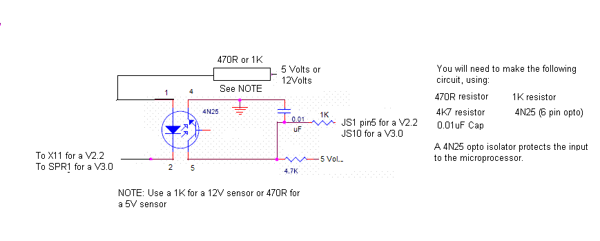

Is it essentially the second diagram here?
http://www.megamanual.com/ms2/inputHEI.htm
If so, with what you said earlier
On 29th Jun, 2008 Paul S said:
I've hooked the input direct to pin 1 of the opto-isolator bypassing R12.
The LED is the wrong way around.
For that suggested circuit, U3 pin 1 (LED anode) is fed with the 5V through a current limiting resistor and your hall switch output should then be connected to pin 2 so when it pulls to ground, the LED lights.

OK, I mis-interpreted what you said about "input direct to pin 1"
You have the 5V (through limiting resistor) to pin 1 and Hall output (potential ground) to pin 2.
The only reason I can think that it's not working is that the Hall output (open collector) is not being pulled up by this arrangement.
Normally you would have a pull-up resistor direct from the power to the open collector, this arrangement relies on the pull-up resistor in series with the U3 LED, and LEDs have a very high resistance when they are not conducting, so your Hall output may not be coming up to 5V without a direct pull-up resistor, ie, giving a clean 0V but not a clean 5V.
Suggest a DVM across green wire and black with MS powered up and turning dizzy/engine by hand to see if you are getting a clean switch between 0V and 5V.
I also looked up the U3 datasheet and did a quick sum, particularly in light of the MS-Extra suggestion of a 1.3k resistor.
Data sheet for U3 (opto-isolator)
LED (input) part only
forward voltage 1.2V typical, 1.5V max at 10 mA (fairly typical for any LED)
absolute max forward current 80mA
Thus to switch it on the resistor must be capable of passing 10mA but must limit to less than 80mA
Aim for 10mA
V=IR R=V/I R=(12-1.2)/0.01 = 1080 ohms (closest 1k)
or R=(5-1.2)/.01 = 380 ohms - that is the original value of R12
Can't understand why they say 1k3 in their second suggestion (although they do add the note "Note that some users have reported that 1K to 2K Ohms is too high, and a value as low as 330 Ohms may be need for R12 - experiment in your installation to find what works."
On my original calculation (where I said 470R) I had forgotten to deduct the 1.2V from the 5V.
With 12.2v at the ECU I am getting a switch between 4.2v and 0v.
Is 4.2v high enough?

It isn't whether the 4.2V is high enough, its how it compares to Vcc (the 5V inside the MS where you have picked up the supply for your resistor). Basically it should float at the exact same voltage as Vcc, otherwise current is flowing and it may be enough for the LED bit of the Opto-isolator to be on when it should be off.
Remember it is the 0V at the Hall switch that turns the LED on in your circuit.
If Vcc is a genuine 5V and your Hall switch is only coming up to 4.2V, you have 0.8V where you should have zero.
LEDs run at 1.2V forward drop nominally so it shouldn't come on (esp. as part of the 0.8V will be lost across the resistor) but something's not right.
Needs more thought...

Just took some voltage measurements across the ECU.
Open gap on the Hall switch
VCC - 4.9v
Pin1 U3 - 1.2v
Pin2 U3 - 0v
Pin5 U3 - 0v
SPR1 - 0v
Vane in gap
VCC - 4.9v
Pin1 U3 - 4.9v
Pin2 U3 - 4.2v
Pin5 U3 - 4.9v
SPR1 - 4.2v
So it looks like the hall switch is working OK as the output of U3 (Pin5) is switching between 0 and 5v ish.
I think I will park this until Jean has had a look at the code.
Now where did I put that K100 head?
I've just put the resistor and LED between VCC and the C12 pin hole.
It flashes at half the frequency of the ignition output LEDs so the signal is clean and consistant at engine speeds.
Yes output switching correctly, you say 0 and 5V ish (as if 4.9 is wrong), it's actually right because it's switching between 0v and Vcc.
However, a note of caution....
Your open gap voltages are spot on, Hall (SPR1) pulls to zero so LED inside U3 goes on, current limiting resistor sets the specified 1.2V forward drop over the LED (pin1 - pin2).
The closed gap readings are not so good because SPR1 (and pin2) isn't coming up to 4.9V but only 4.2V so there is 0.7V across the LED instead of 0V. Although this is too low for it to stay on (ie, it is less than 1.2V which is why the output is working correctly) it isn't ideal. I think this is because of biasing the Hall switch open collector through the LED bit of U3, which has a very high internal resistance when not conducting.
There is a possibility it may not switch so cleanly once the switching rate is up with a running engine.
Sorry to be slightly pessimistic (it's in my nature...) but the pin 5 readings are certainly good enough reason to wait and see what Jean says about the code.
