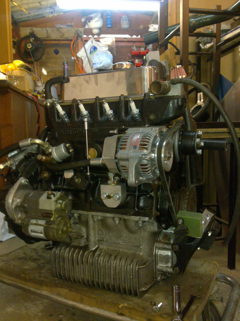

Engine is virtually finished (Thanks to Ben_H), just a couple of brackets and the trigger wheel to sort out.
Should have it mounted once the garage warms up a bit.

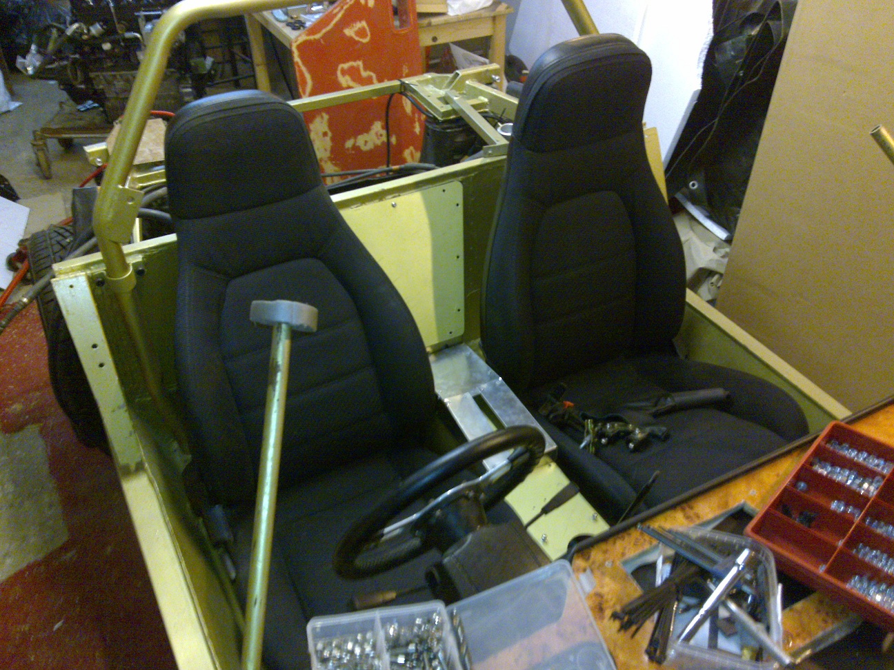

Seats fit in nicely (MX5 with speakers in the headrests).

WOW, those seats look like they're made for the job.
Gear stick looks a bit out-the-way mind

That's the handbrake.
The seats are just small enough to allow me to fit in the car, but they have got full adjustment including tilt. Good call Wil.

Looks really good, but why have you bolted your CPS to a piece of green cheese??

It's oilon, was spare in the garage, is non metallic and about the right size. :)
I do need to redesign the bracket for it though, it's slightly too thin and can flex.

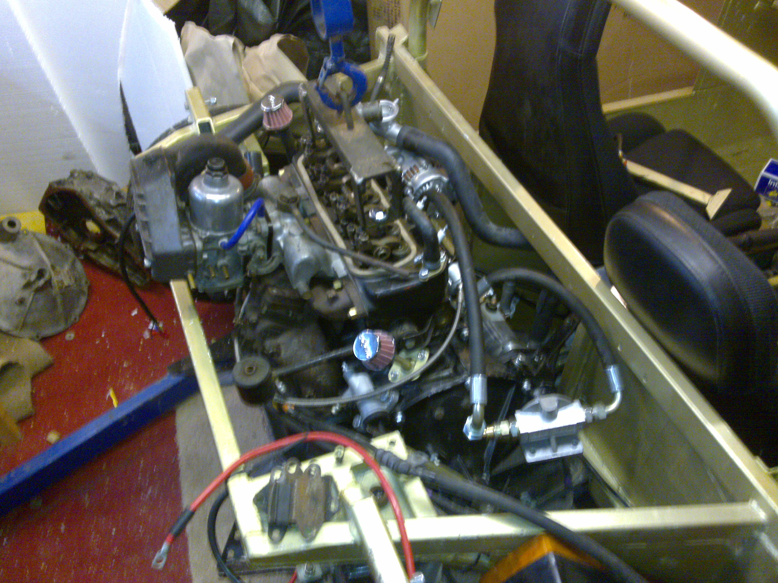

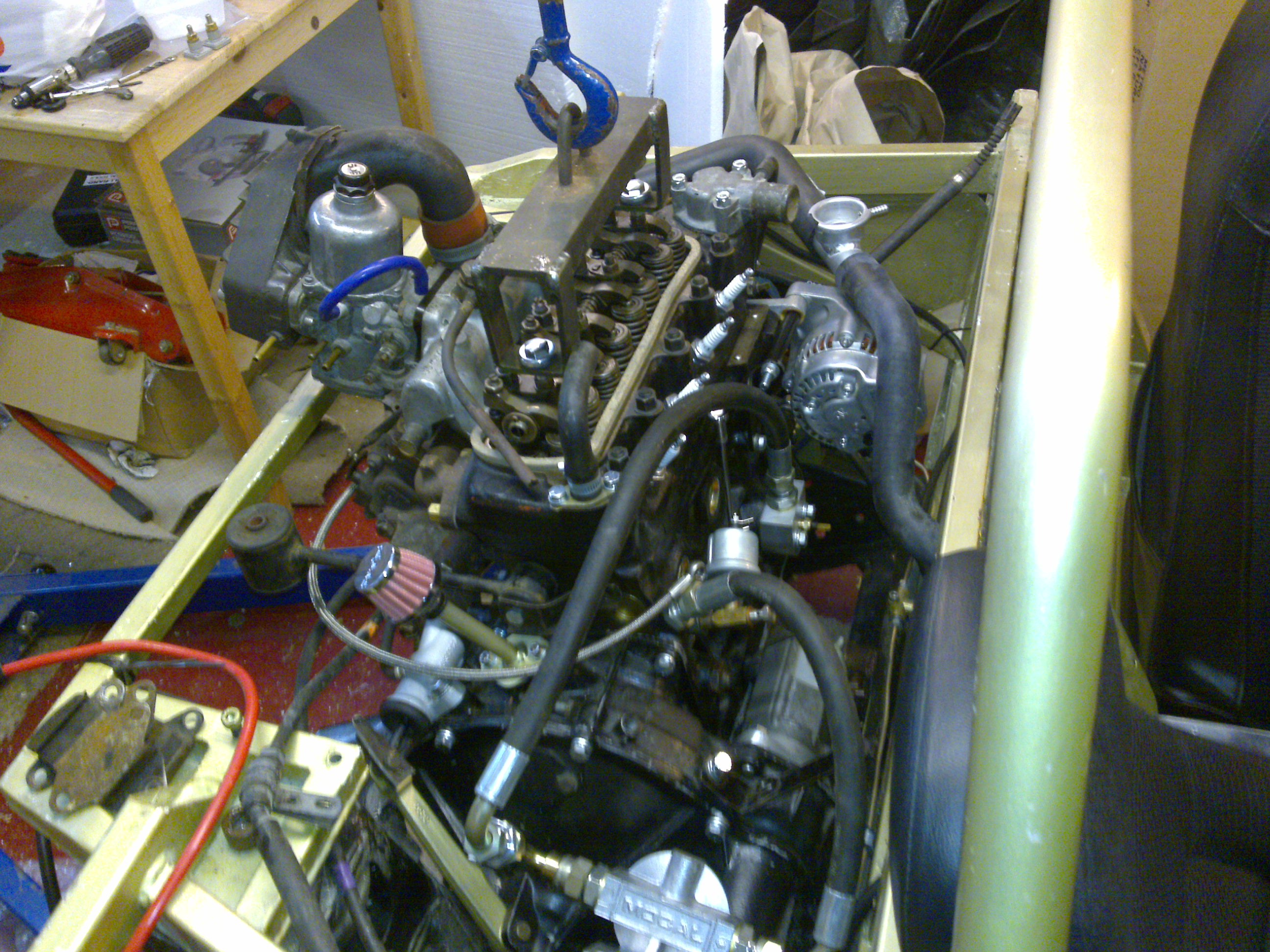

Managed to drop the engine in this afternoon. With the redesign of the rear frame, I was able to drop the whole lump in, in one go.
Hoping to have a good push over the next couple of weeks.
