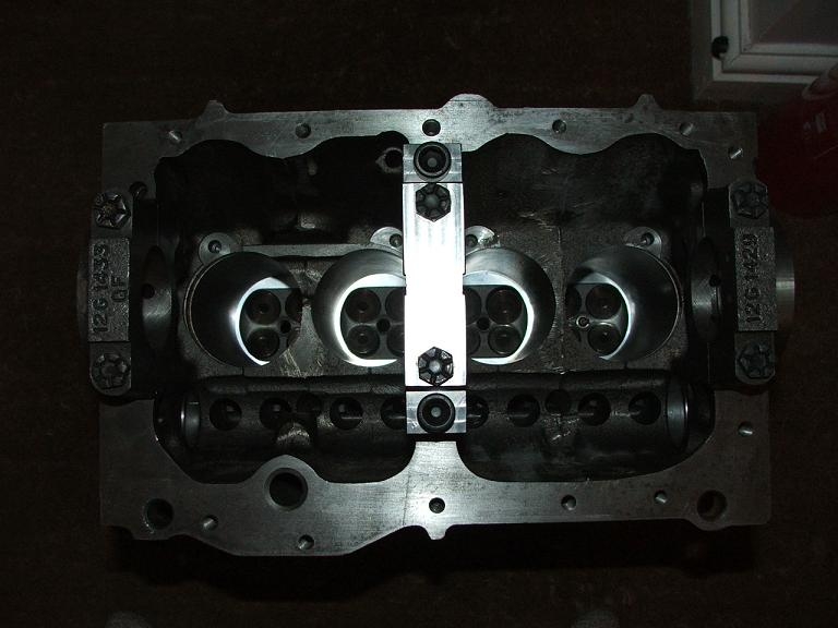

please take away that sharp edge on the ridge above the dish though.
indeed! is hould have done that wile it was still clocked up on the chuck really, thought of it soon as ii took it off*oh well*

has everyone worked out how thick it is between the bottom of the top ring slot and the corner of the recess in the top ?
Valid point, which is why I had a piston machined and then cut in half, there is no doubt about it then. I managed to keep the crown thickness at 7mm all the way across and yet opened up the dish to 16cc.
Not bad for a standard piston *hehe!*
which piston is that colin ,is it 23512 ergo 19648 (made up nos ) or such like ?
cant remember off the top of my head but its the standard deep 12cc dish turbo piston. You could possibly get it to 18cc total without weakening it beyond use

Just out of curiosity... why do you guys leave the outer rim on the crown so tall? It would seem that you could knock that down as well and not have to go as deep. In doing that you would also get rid of a "squish" point.
Squish is what you want to try and maintain. Squish promotes turbulance of the mixture in the chamber resulting in a better burn
Mikes1098
152 Posts
Member #: 2190
South Carolina, USA
I stand corrected... for some reason I thought "squish" could potentially lead to detonation if it is too tight or a hot spot. Taking a look in my book... it says "squish volume is considered scared and should not be tamper with." Just for reference squish volume is a rim about .3" to .4" wide around the chamber, and ~.040" thick. Apparently, the idea is to push the charge toward its center as the piston achieves TDC. It also states, that a reasonable rule of thumb would require the top thickness to be at least 6% of the bore... everyone here seems to meet that rule.

I'm not sure a round squish area on pistons is a good idea on A-series. I'm pretty sure in some areas the top of the piston will be below the chamber cavity of the head. This will just create a narrower chamber area, but no squish. And this is bad for knock resistance.
I think you should match squish areas to the shape of the combustion chamber in the head.
And please remove sharp edges inside the pistons !

I was thinking along the same lines the other day,
On 11th Nov, 2008 alpa said:
I don't have my stuff here (and for a long time), so I can not check.
I dont think its bad piston design, its bad head chamber design
the thing is the heart shaped chamber has been around for longer than I have been on the planet, and has been see to give results so where is the problem?
The other thing to consider is if having all the chamber/ dish on one side of the piston, will that not put a tilting force on the top of the piston on ignition?
