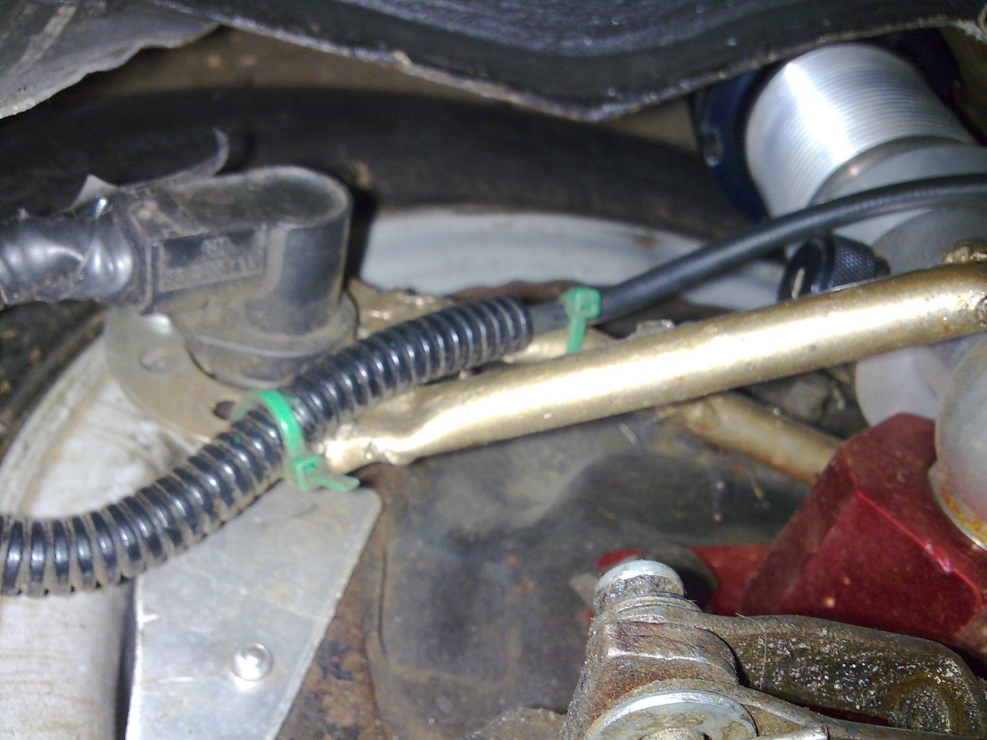

Ooo I like! Have you got any speed sensors mounted on the front hub...could be used for launch control!! *wink*
johnK
1425 Posts
Member #: 690
Norfolk
Being less aflluent than Jim I used an old Rover K series cam sensor and some M5 hex heads sunk into the rim of a minifin. The more "signals" you get the less coarse the output - I went for 8 bolts. Bracket comes off the shock mount and backplate mount
Shhhh!

John, how are yours mounted on the front?

johnK
1425 Posts
Member #: 690
Norfolk
Jim There are two laser cut "trigger" wheels on the pot joints, just behind the groove where the boot is - I turned the pot joint so it was true, squeezed them on then a couple of tigs to attach. Then I went upmarket and used vectra cam sensors on brackets attached to the drive flange covers. These trigger wheels have lots of teeth to keep the data accurate for motor control.
