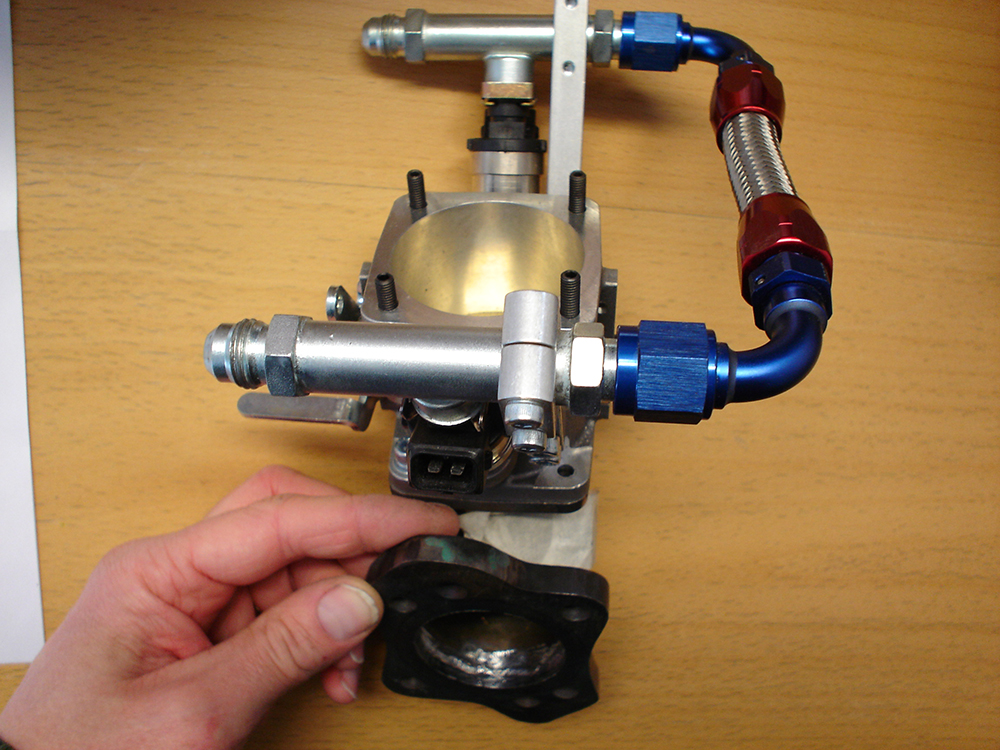

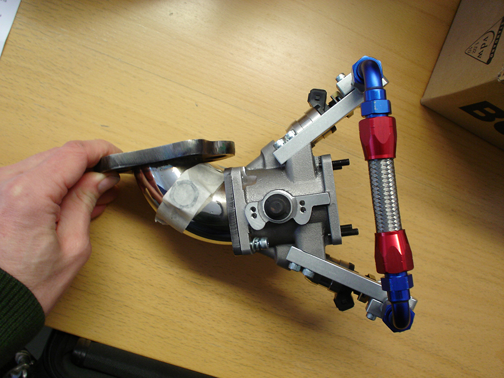

Here is throotle body.
Edited by nuukuus on 25th Sep, 2009.
1399cc, Eaton M45 supercharger, N2O system, compression ratio 9.23:1, boost pressure 0,8bar/11.6psi.
