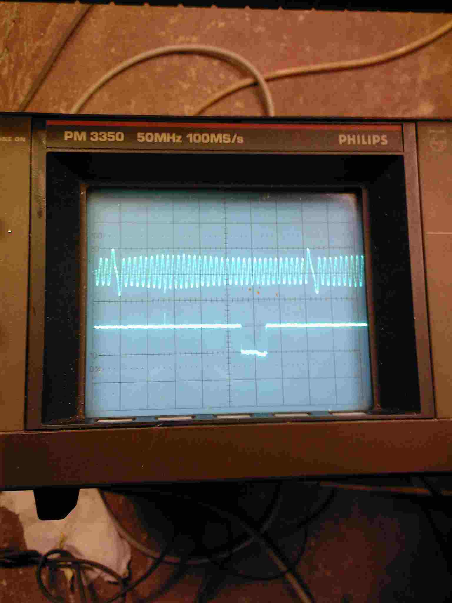

1st Scoop picture:
Channel A is the 36-1 crank signal channel B is the cam signal
First checks:
Ignition cranking timing set to tdc, injection cranking timing set to 0 and timing trigger set to start of pulse, removed all plugs and fuel pump fuse.
First injection pulse starts exactly on TDC (cyl 2) and next pulse occurs 180degrees later which is TDC of cyl one.

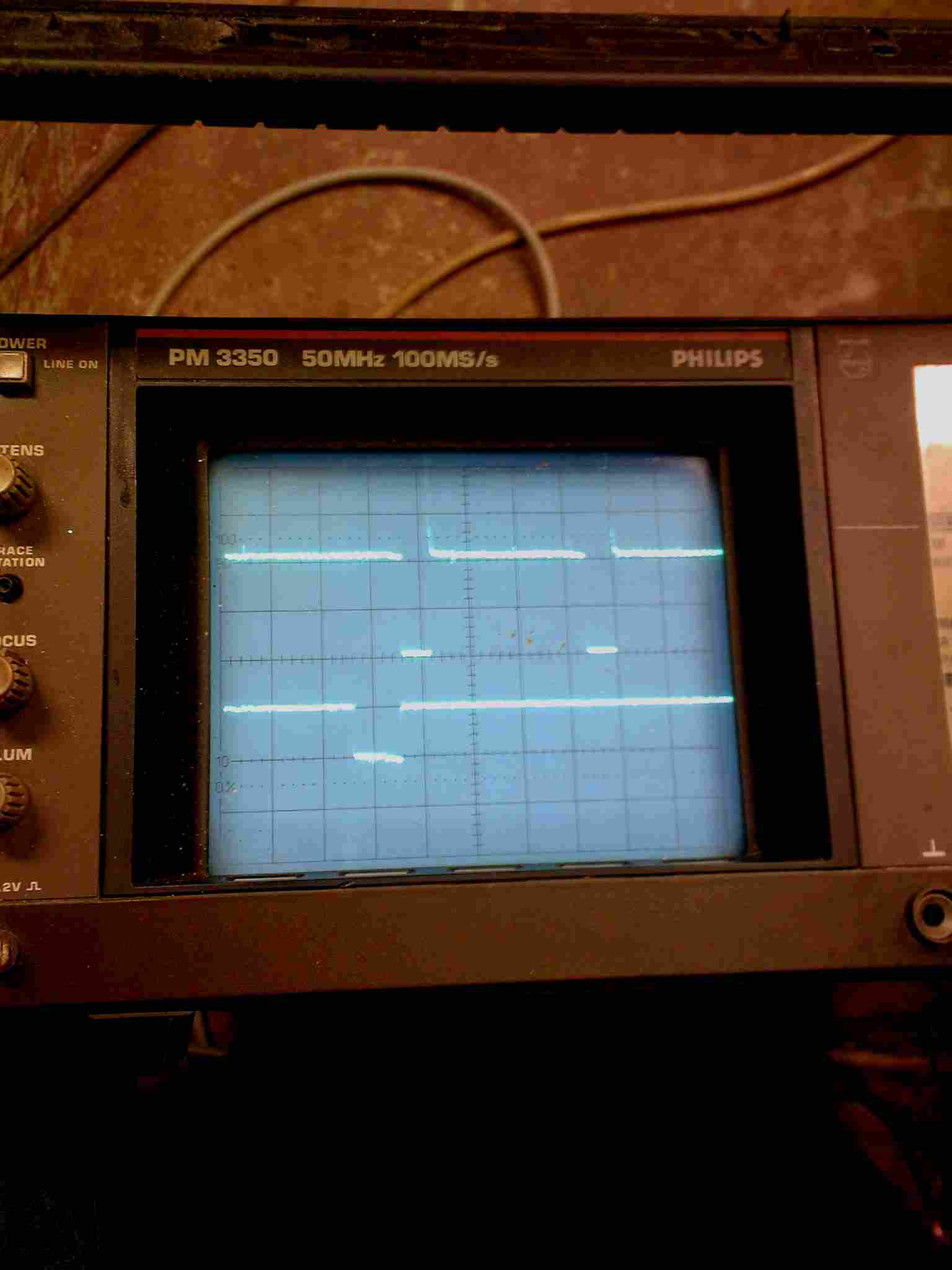

2nd Scoop picture
Channel A is injector cyl 1/2 channel B is cam signal.
So far everything seems to be oke *smiley*
Next test will be to shift the injection pulses to see how the timing works.

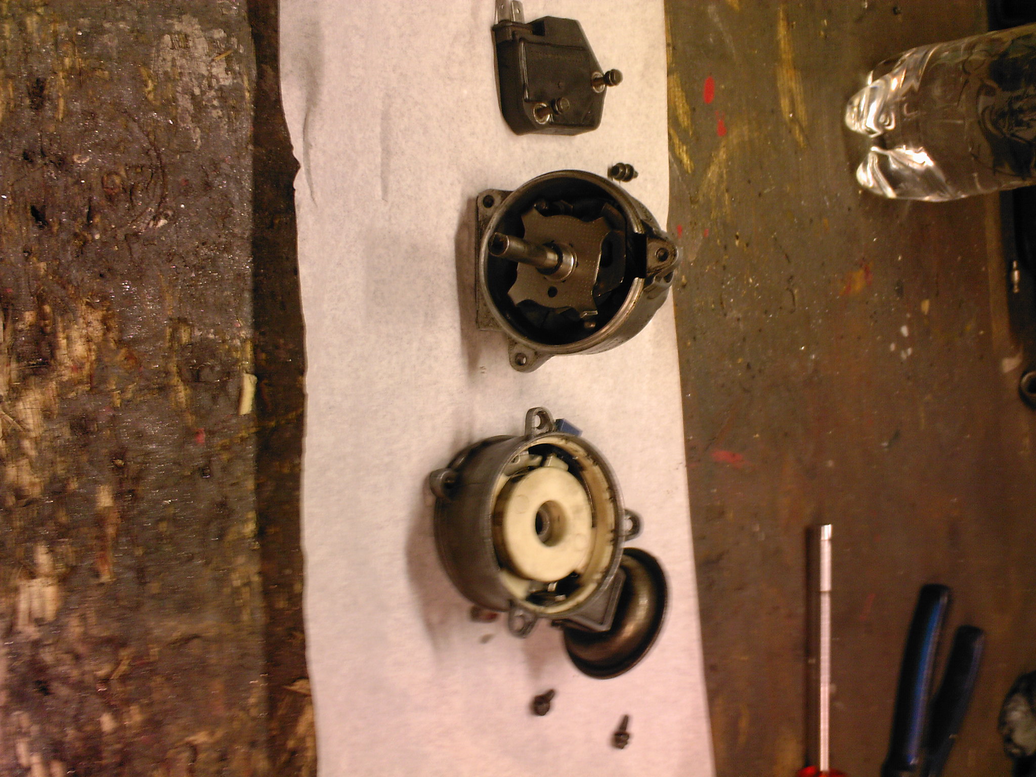

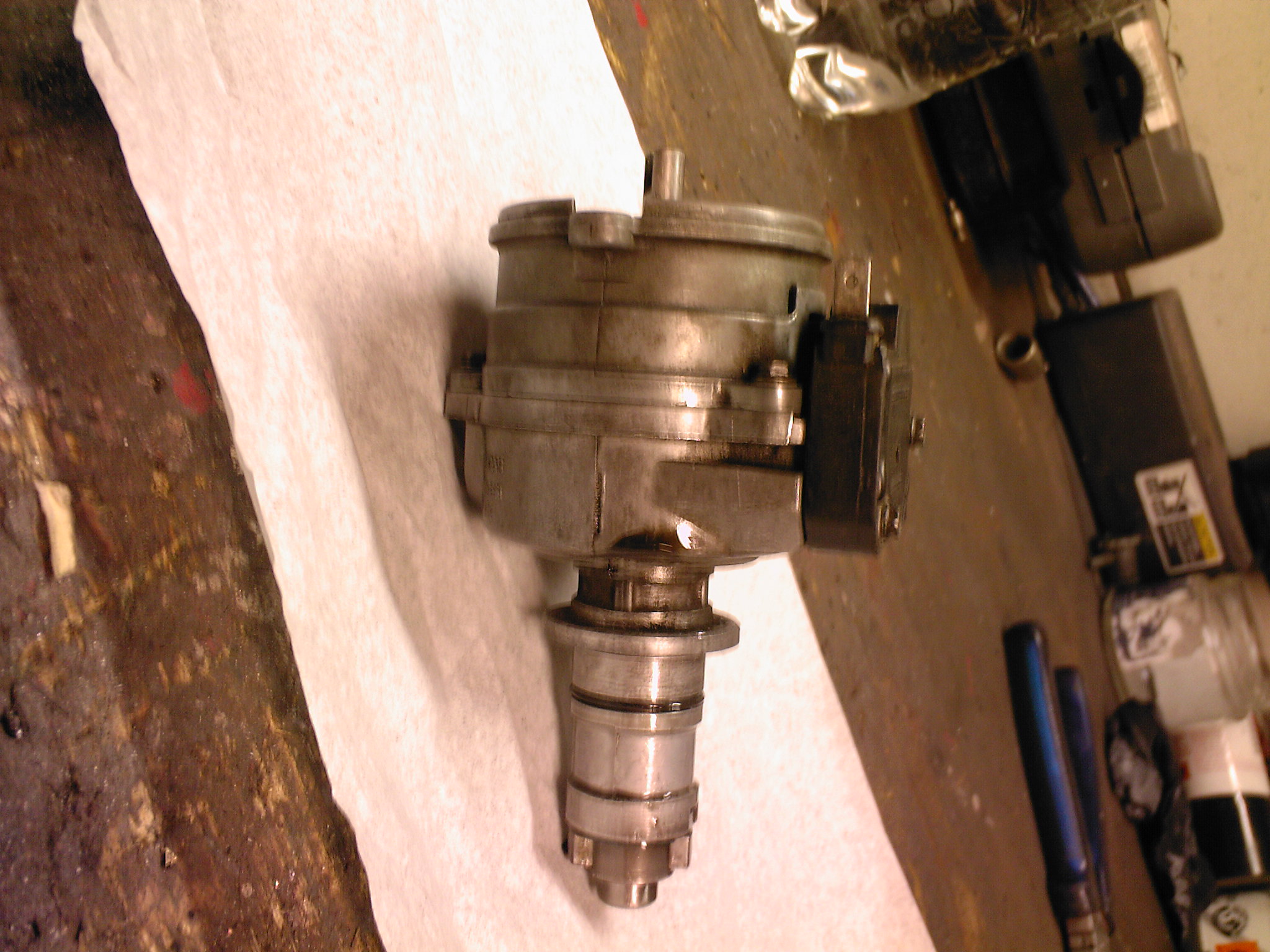

I use an electronic ignition distributor from an MG Metro connected to the M-Squirt hall input circuit (with added pull up resistor of 470ohm). I bended three of the four rotating blades downward so they don’t pas they stationary blade anymore (snapping them off would have disturbed the balance I reckoned) and snapped off three off the stationary posts and connected the M-squirt to the terminal that normally fires the coil. I blocked the centrifugal and vacuum advance. The signals looks very clean at cranking and low RPM and then suddenly starts moving all over the place just before it completely stops, when RPM drops the signal comes back again very clean. Normally the four blades (one for each cyl) are operating in parallel seems to be some kind of hall sensor internally but than quite big. I thought snapping three blades off would not harm the signal strength to much but perhaps I was wrong about that. I will check this further this evening by operating the distributor on a mill and doing some bench testing. I added two pictures of the setup.
It first this seemed to be a very quick way of getting a cam signal as I had the distributor laying around.
Regards Will
Removing (or bending down) three of the four blades is logical but without knowing why there are (or were !!!) four posts - I would have expected only one for a Hall switch - you may well be right about signal strength.
As you say, spinning it at different speeds off the engine and watching the output on your scope will soon tell you.
I have a spare one in the garage, I'll have a look inside today just out of curiosity.....
EDIT - one other thought Will, as the electronic dizzy has the amplifier unit on the side, ie, it is not just a Hall switch but a Hall switch with an amplifier to swich large currents through the standard coil, the 470 ohm resistor pull-up reistor may not be appropriate or an unsuitable value.
I suggest you wire one up (outside of the MS box) when doing your bench test to see if it is having an effect.
Edited by Rod S on 23rd Dec, 2009.
