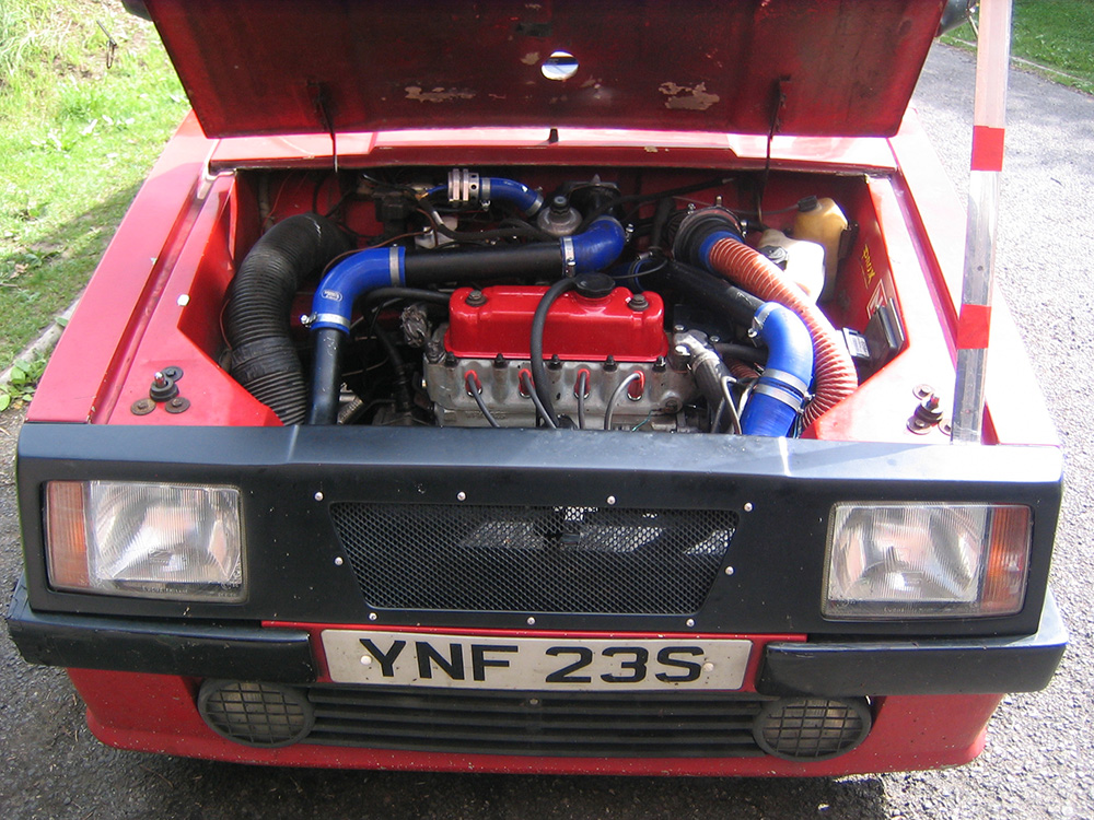

Right well after lots of tossing around it is now all up and running as it should be, just needs setting up now. I've been struggling since I got it going with variable boost levels, sometimes 15psi plus, sometimes no more than 5psi.
Today I change the actuator, and hey presto consistant boost. the actuator was new and seemed ok when tested independantly, but was sticking, it's in the bin now.
Some photos

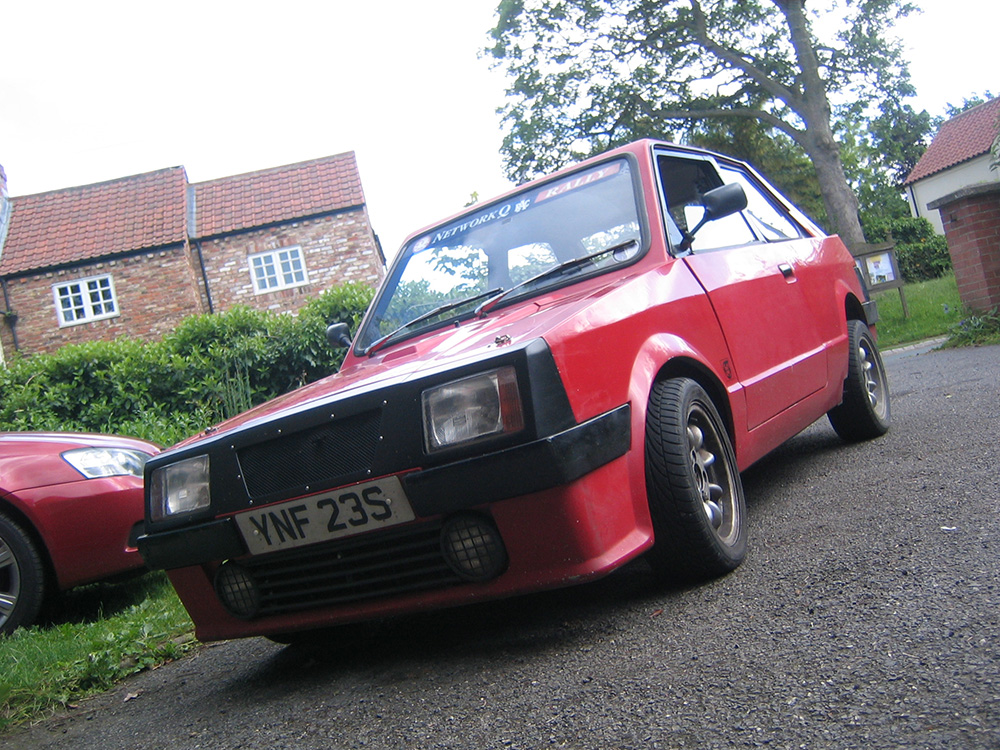

Sexy new front (daft camera angle)

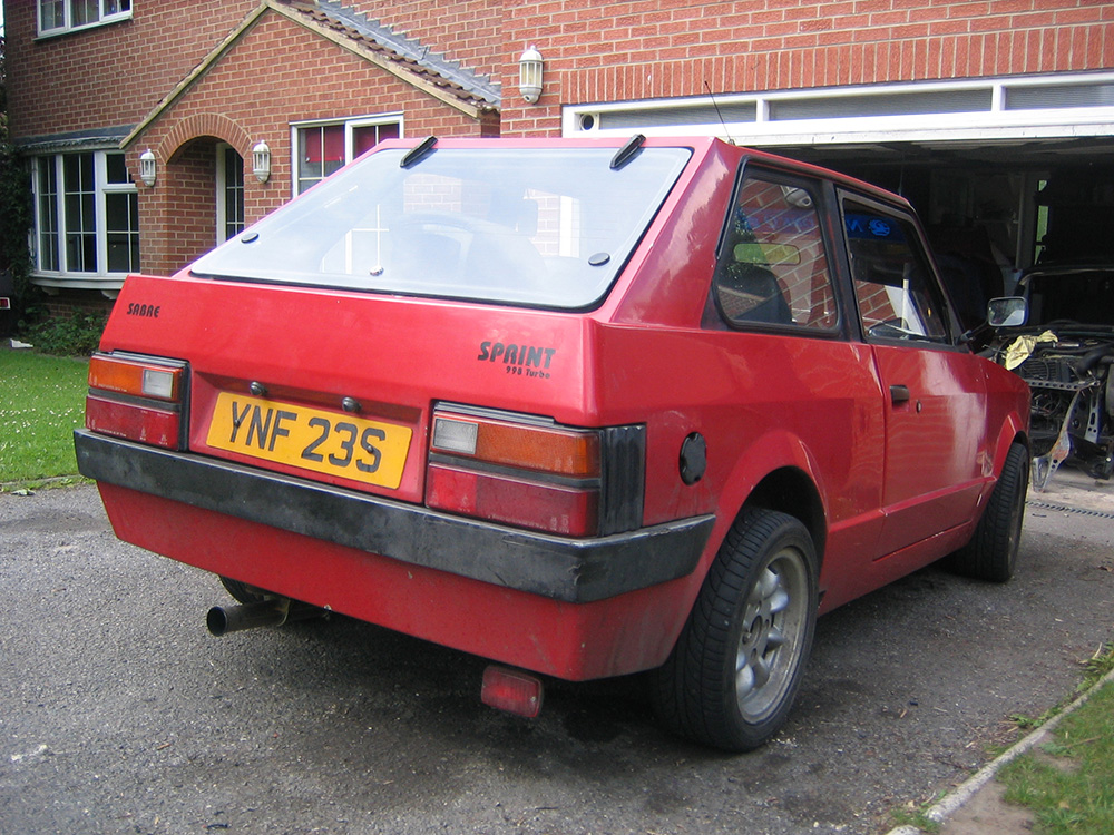

New exhaust and stickers on the rear (thanks Jimster)
Nice shine red rocker cover new bonet prop!

I'm sorry, but it still looks like a MK 3 escort.
Me personally, I think it looks like the Talbot Sunbeam, which is not necessarily a bad thing
On 11th Jun, 2010 Wifey said:
It's an Astra, no hang on... it's an old escort!
Enough said...
