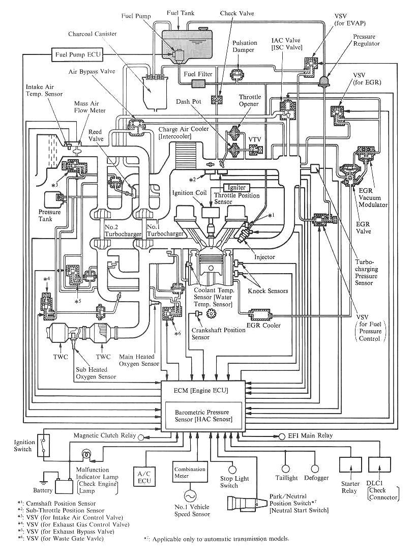

i had sequentials in my supe that was quite interesting and very complicated, valves in the exhausts, valves in the inlets, if one cocks up the first turbo just spins the second one backwards*happy*
