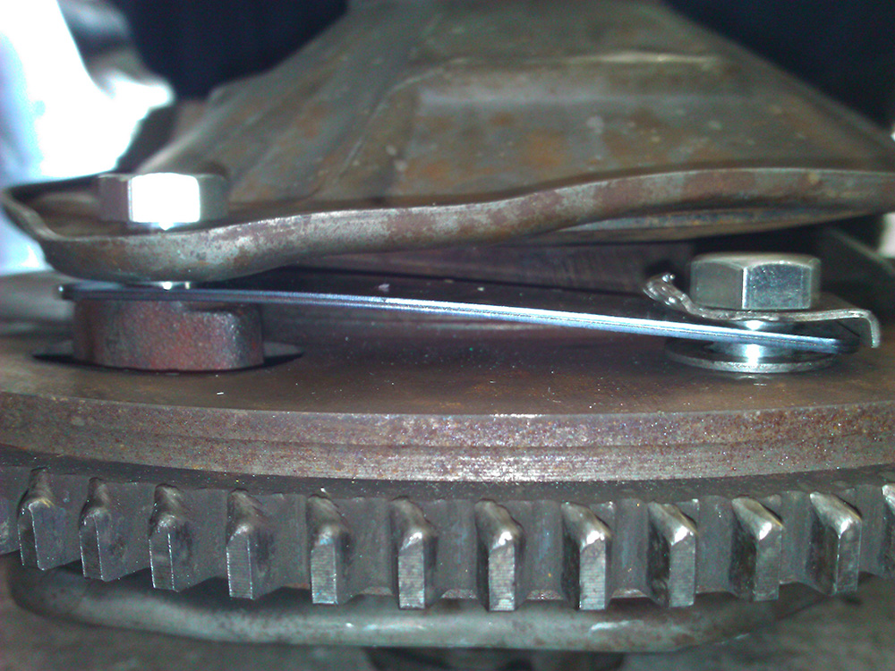

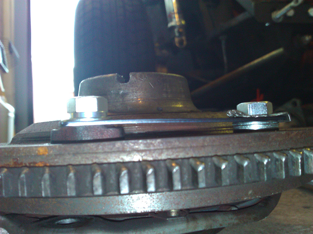

This is how it sits, assembled with the correct bolts, somebody hadnt used the correct strap to fly bolts previously and so im clueless as to what is right.
Where do i need to add washers? Im assuming i need to add them until the straps sit parallel to the assembly,and tighten up?
I'd say you want 4-5 washers under the straps,
Is this acceptable?
looks good to me.
a little offset like that is just right IMO.
Right, thanks joe :)
Can get it all back together now hopefully!

I'm not liking any of this. I would like to see a picture of the final assembled clutch from all sides. I just get the feeling that there is something still wrong with this. Just a feeling mind.
The pic at the very top of this page shows the shoulder bolts not seating either, is this still the case? since the cone spring is not compressed very much at all. when the clutch is assembled correctly, the cone spring should sit nearly perfectly flat, if not a little over center.

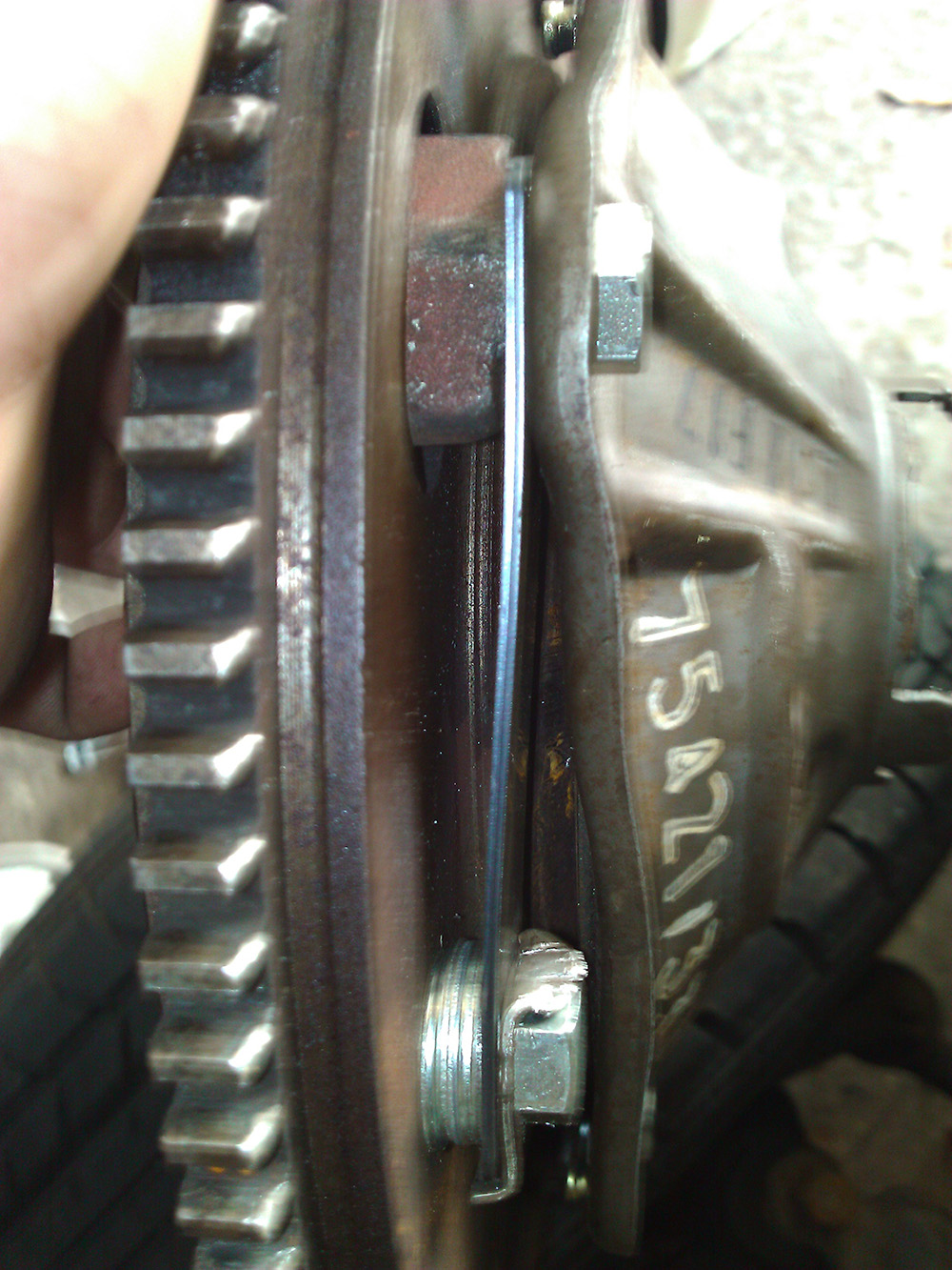

Colin, pictures here, it all looks good to me and clamps together nicely.

In the middle picture, the shoulder bolts that pass through the diaghragm into the posts of the backplate don't look like they are fully seated properly? The head appears to sit too high. The cone spring also looks to be little compressed in that picture but doesn't look too bad on the third picture (it could still be better).
The shoulder, Not just the threaded part, on the bolts all need to pass through the diaghragm, the straps and then into a recess in the posts on the backplate, the hex head should seat directly onto the diaghragm. Since this flywheel looks to have been lightened, is the main reason there is no recess in the flywheel for the shoulder bolts and why a stack of washers or a spacer is required. Basically you should have the hex head of all those bolts seatig on what ever part they are being tightened up onto. There is no need for any washers under the heads of the bolts.
I am also thinking that the friction plate is thinner being the solid center type, compared to the sprung center type, which would have likely been used originally, and, that there is now two straps per corner rather than the standard one. What this may have in advertantly done is reduced the compression on the cone spring, and likely reduced the clamping force dramatically. Clutch slippage is inevitable on a high output motor.
If you are looking for a reliable clutch that is less likely to slip within the limits of the diaghragm rating (green, orange, grey, double grey) you need to assemble the clutch so that the come spring is either flat or just over center, since that is the point that the spring is excerting the most clamping force it will ever do. Having the spring under center and off flat is only reducing the clamping force and increasing the pedal effort to dissengage the clutch.
To be able to achieve this flat spring situation, you need to carefully remove material from the posts of the backplate. A good start would be to work out the difference in thickness of a solid center friction place and a sprung center one, then add that to the tickness of a single drive strap, thus bringing you nearer to what it would have been in a standard un molested condition.
Simply bunging it all back together and hoping it will cure you clutch slipage issue, is not going to get you anywhere really fast.
