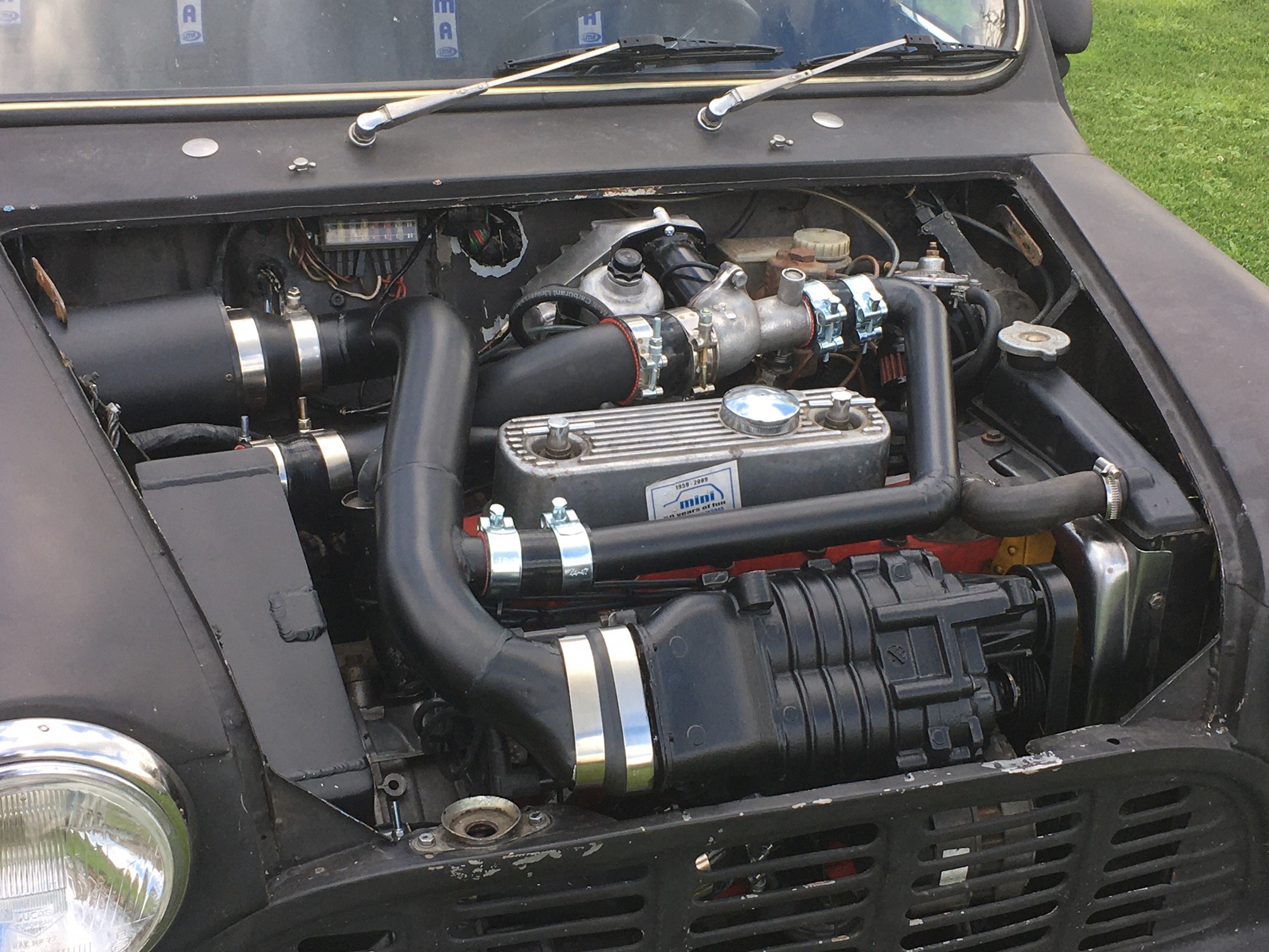

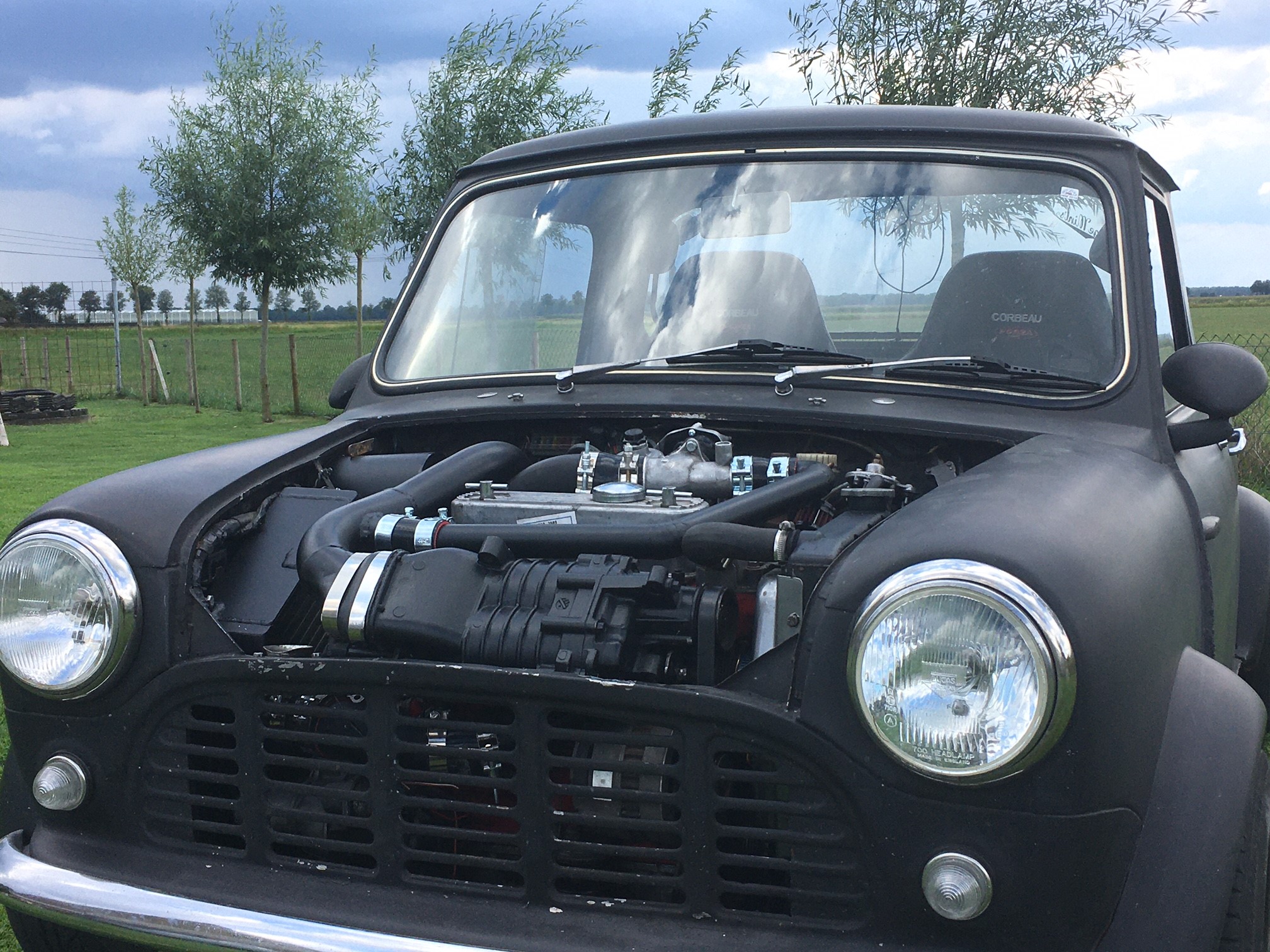

It's been a while since I updated this post. I changed the setup since last post. Removed injection, went to more retro Hiff44.
Current setup is as following:
1275 with flowed head (35.6 inlet, 29 outlet) and Kent 276 camshaft
Front mounted supercharger (0,5 bar / 7psi)
Side mounted Toyota MR2 intercooler
Volkswagen G40 recirculation valve
Blow through Hiff44
DIS coil
KDFI ECU

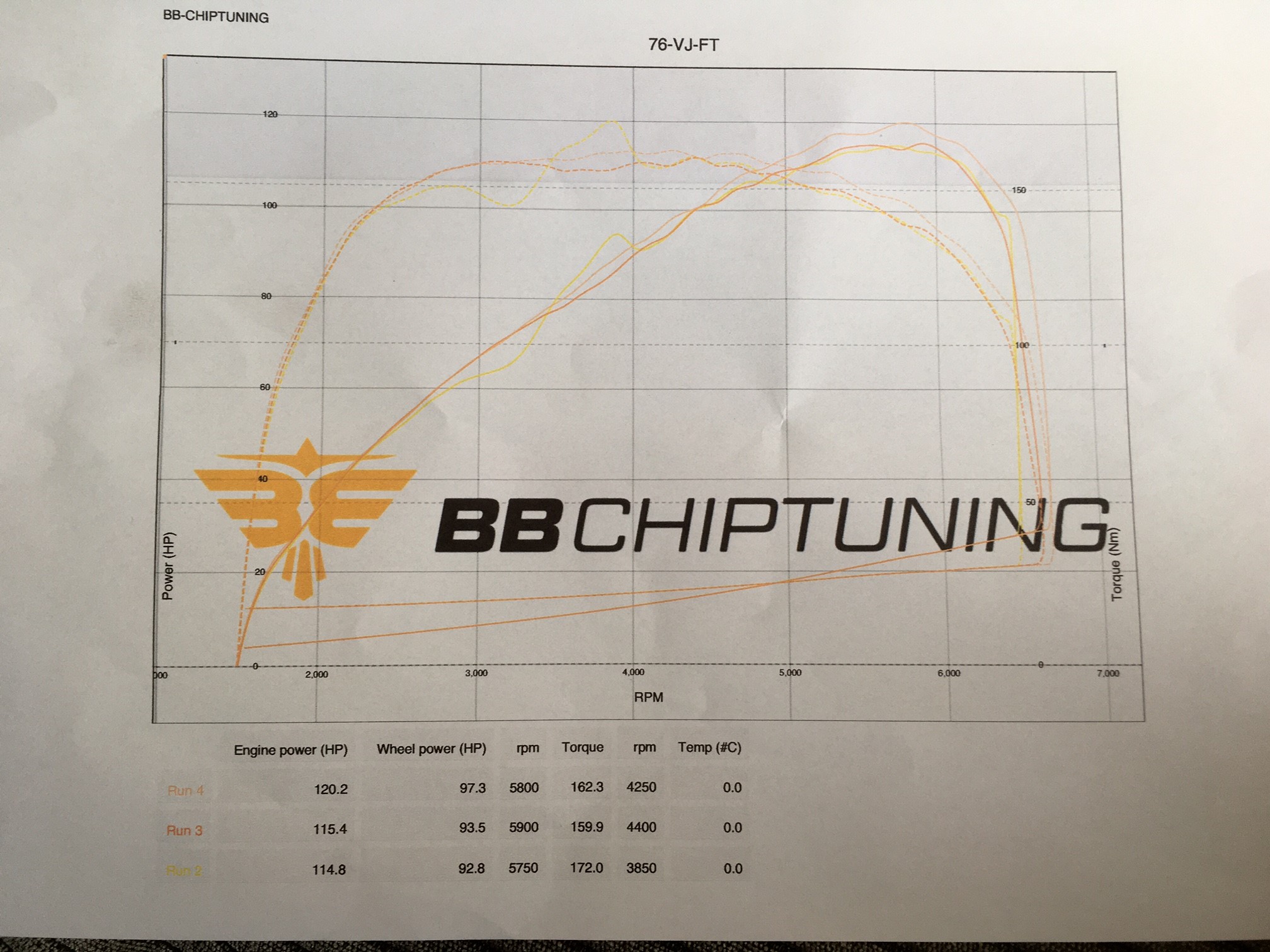

Finally it runs like it should! Loads of torque, perfect drivability over total range and full throttle power is great! *hehe!*
Have been on the dyno last weekend to optimize spark advance. Result: 120Bhp and 160Nm. Torque curve very flat from 2500 till 5500 Rpm. Very happy with this result!
