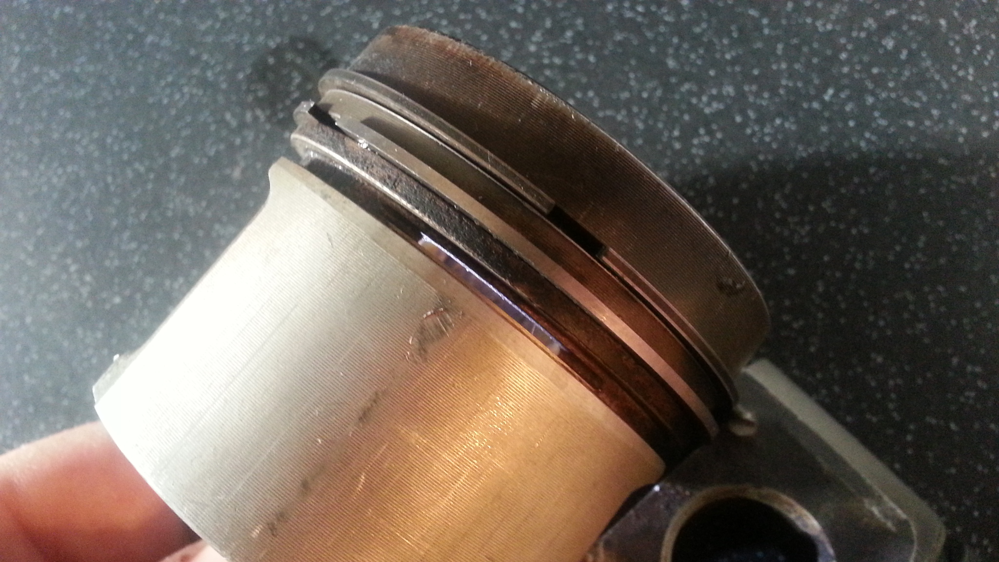

looks well built mate, have you by any chance seen an spi piston out the engine? the oil control slots are huge, i would be cautious with the boost ( is that the right way to say it? )
edit: im asuming there all the same casting tbh..
these pistons 21963
Edited by Brett on 16th Oct, 2012.
