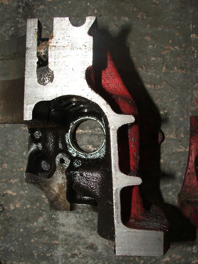

matty, by the sounds of it, its not broken into the coolant jacket, which means the drill bit has wandered downwards a considerable amount. also if the piston does not interfere with the hole, the hole is not in the bore wall, since most engines I have built, the skirt reaches the very bottom of the bore. Of course if slipper type pistons have been used, the hole could be along side the narrow part of the skirt.
either way, to miss the coolant jacket altogether, the rdrill has wanderd downward considerably.
Check the pic below. The knoby bit that has been drilled is in the shaddow, you can just make it out.
Edited by Sprocket on 22nd Oct, 2012.
4310 Posts
Good shout sectioning that block, those pictures have proved useful over the years. *Clapping*

hang on... after seeing that pic and not being convinced I drilled it on that much of a piss. I have just being to double check. I have only tested the hole at tdc and bdc not actually had the probe in the hole while rotating. and the piston does pass the hole. at bdc the hole is in line with the notch in the piston.
sorry for the confusion *frown*
