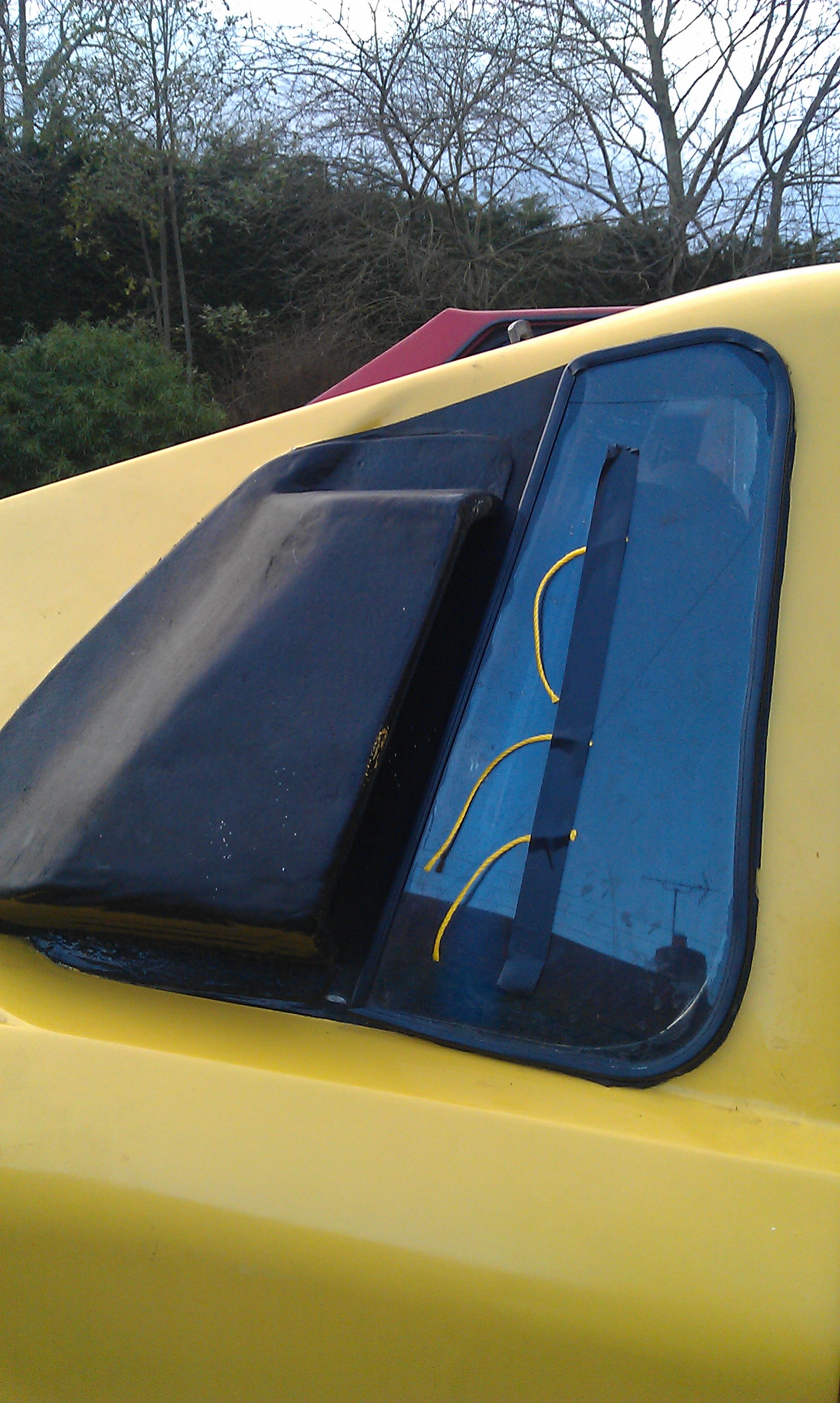

That looks like the Avonbar intercooler kit for the Metro. It sat the intercooler under the normally blanked off bonnet vent on the drivers side.

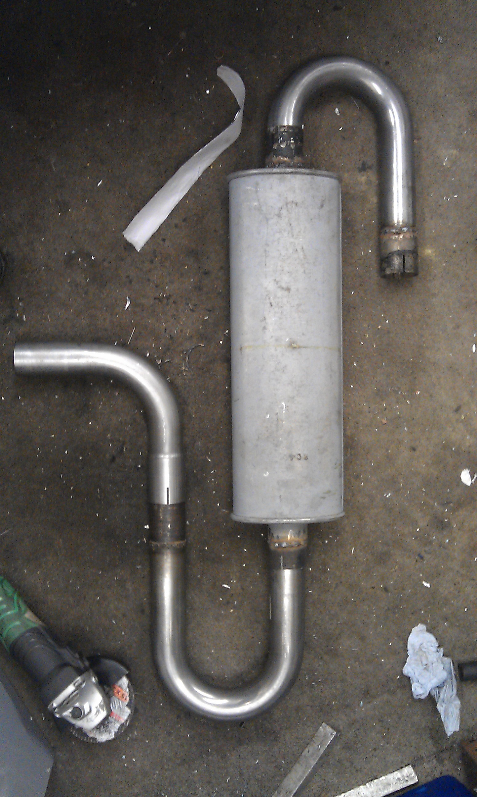

Well it now has a new exhaust, just needs fitting.

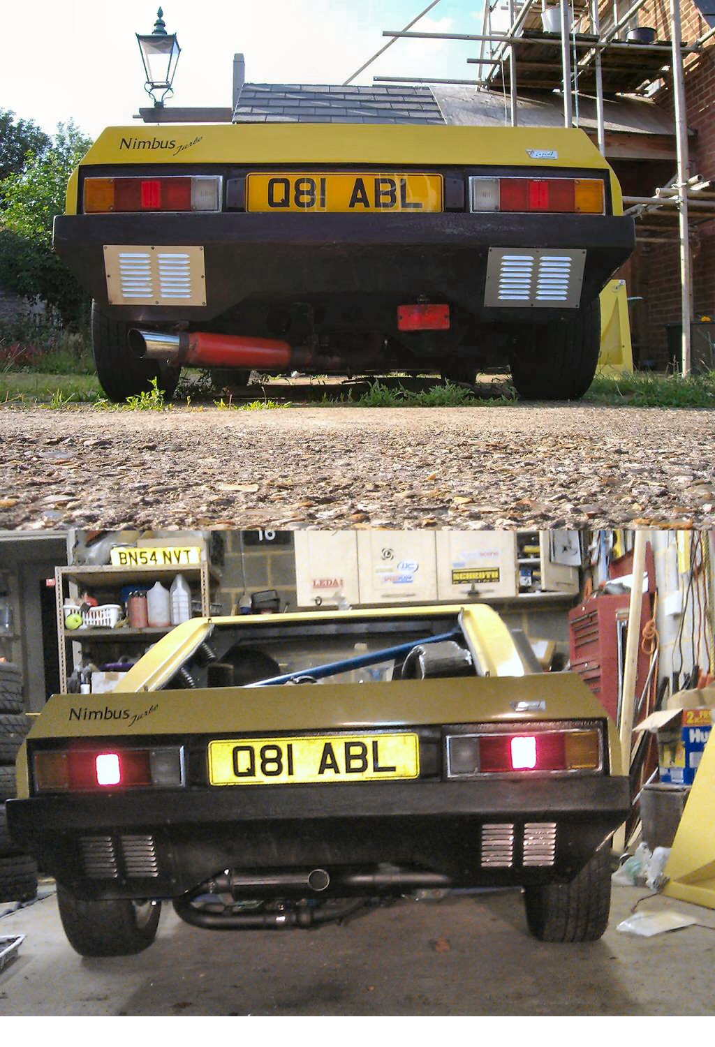

And now a before and after of the fitted item. Note that the foglight is now one of the reverse lights.
www.twin-turbo.co.uk
The downpipe knuckly bit looks quite low. Is there anyway you could cut and shut that to get more ground clearance? Or is the subframe in the way.
I recon it's the angle of the pic?
It's a bit of both. It's excayly the same height as it is on a mini, you just never see it from that angle. Not much you can do really.
It's the same height in both pictures BTW

Well I wasn't convinced that much air was going in through the sidevents to the IC. So in true F1 style...........
And this is what they do on the move
http://www.youtube.com/watch?v=UNk2bQ3NMMo&feature=youtu.be
I think the best way to make it work well is going to be to add a duct on the bottom of the IC and vent it to a low pressure point on the back of the car,

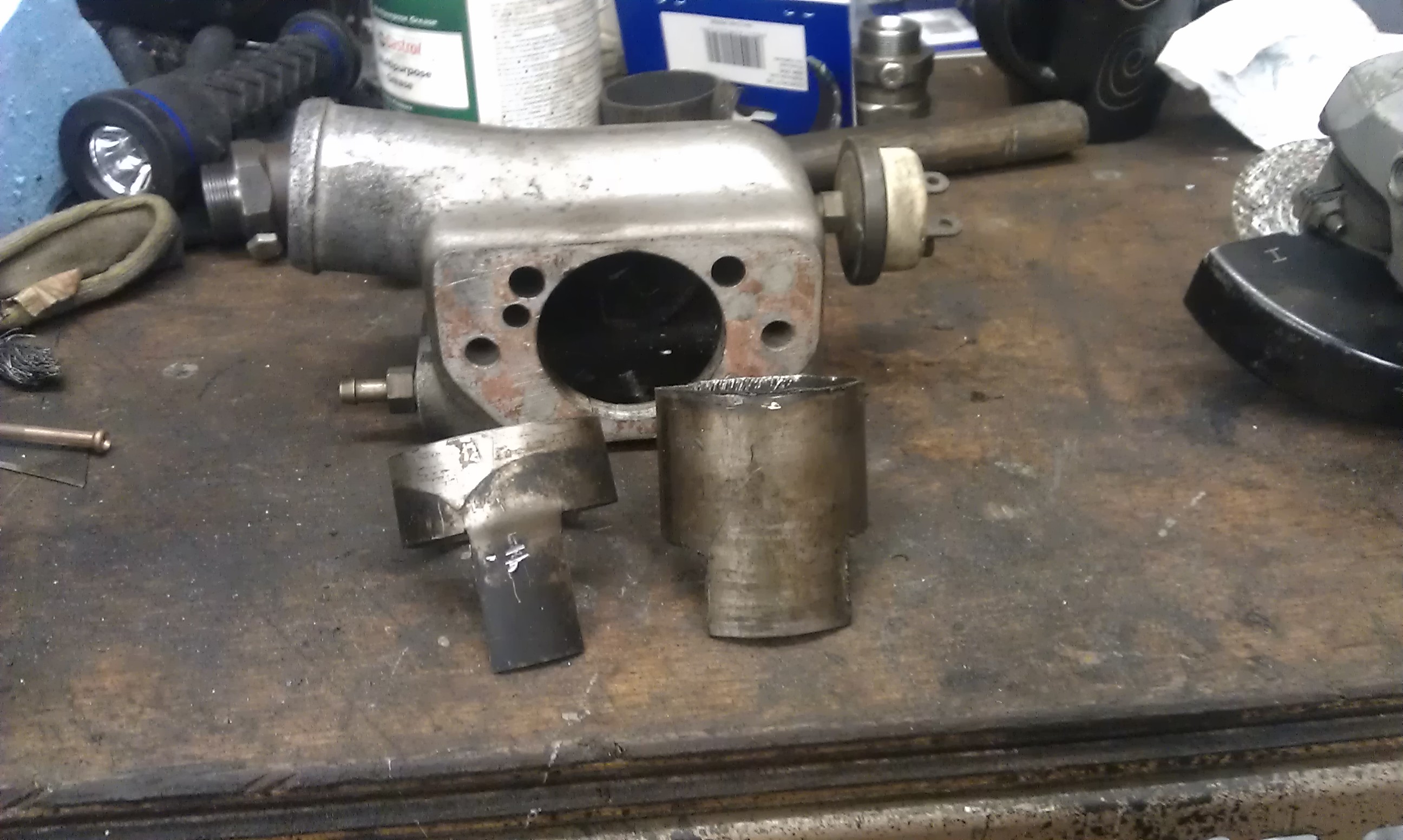

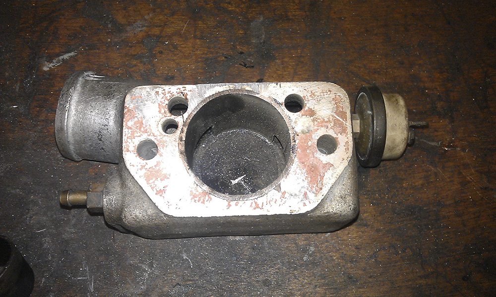

I took it down to Ben's on Wednesday, and the fuelling was shocking. 12:1 on cruise and off the scale lean on boost. A quick check showed that it had a standard BDD. I reckoned that the float bowl wasn't pressurising as the fuelling went so lean.
So I inspected the plenum restrictor. This is what I found - One fitted on left, new one on right.
The guy who made it obviously understood that the restrictor was important, but failed to make it to the correct dimensions. So it wasn't really a restrictor. The new on is a copy of an original, but a bit longer to fit this plenum.
Not tested it yet, but hopefully this will do the job.

That would defiantly explain the symptons. Interested to see the results.

Well that worked a treat.
Problem no is it's 17:1 on tickover, 12:1 on cruise and 10:1 on boost.
New needle time.
