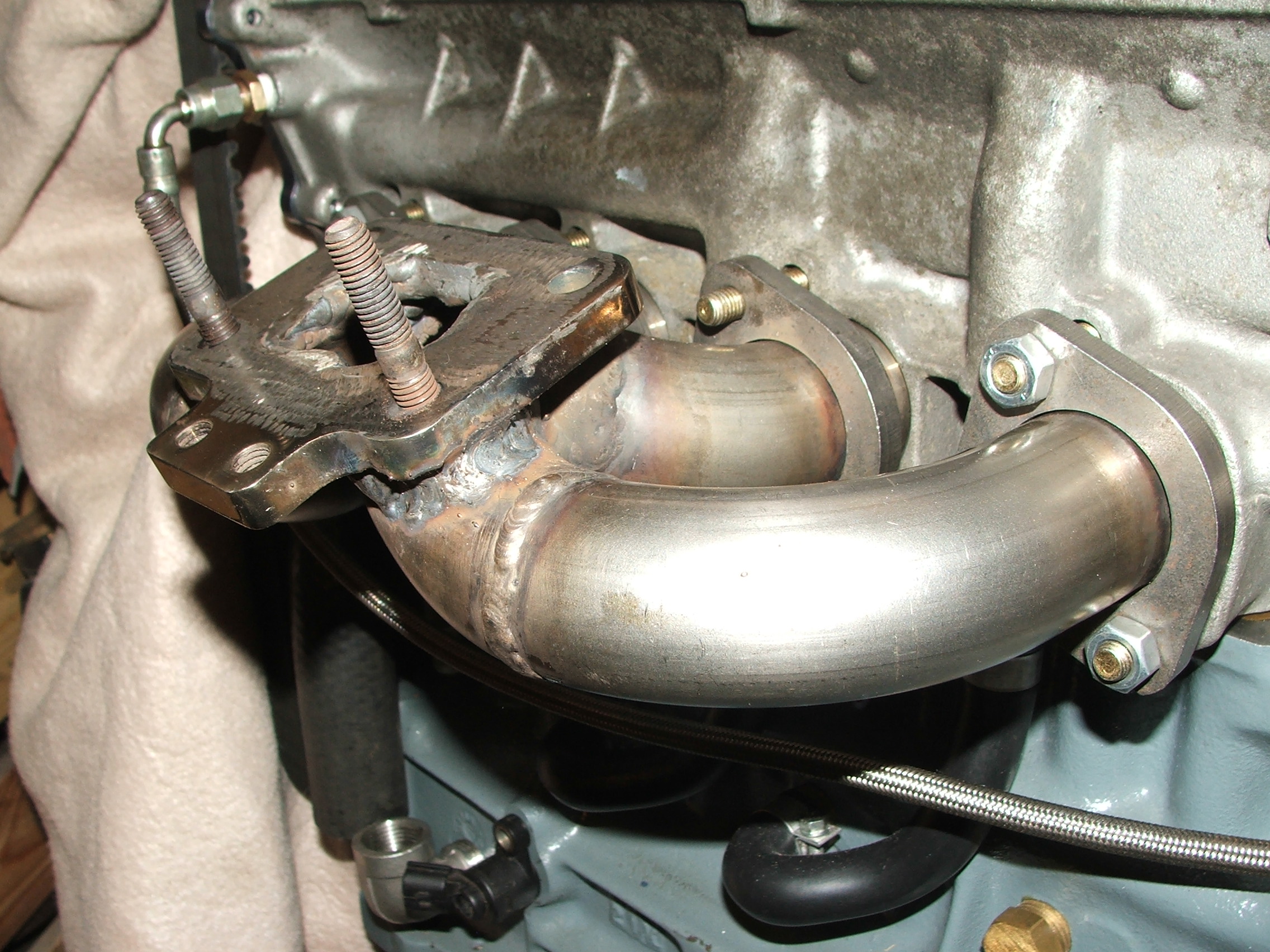

A few updates. Have cut and welded the manifold (just need to cut down to size. Wedling is not pretty, but is plenty strong i hope!
Have also fabricated the downpipe using Saab elbow and some SS bends.
Next task is to split the pistons and rods and go about increasing the dish to get compression down. Then work out dumpvalve, plenum, intercooler pipework and finally rebuild the engine!

Bit more progress today. Manifold cut to size, flanges attached and bolted up to the head, it fits!
Also, Weber box chopped out and extended for cold air box. No going back now!
Nice. I was wondering how you where going to clear the master cylinders with the inlet hose...
