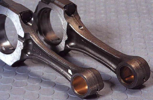

Found this on a toyota web site.
Grooved big end housing looks good.
Back rod is drilled.
Take your pick
Take your pick
Regards
Dave
my isuzu TD engine uses this method :)
