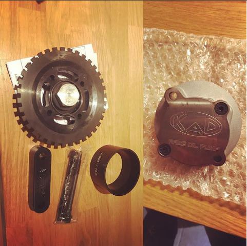

Interior wise it will be pretty minimal, fitted a KAD internal linkage that I stripped and sprayed satin black. Steering column will mount to the cage via an owens bearing, currently working on a second support and the rest of the column.

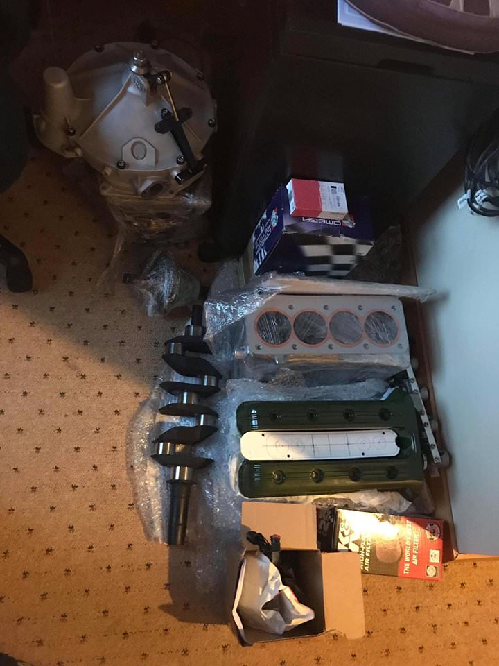

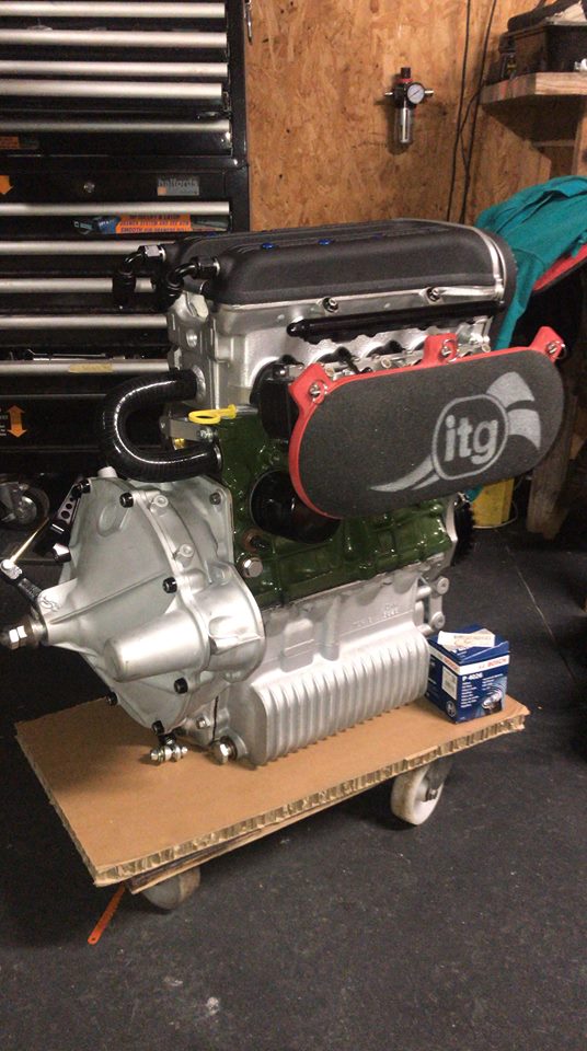

With my shell being at my mates workshop for paint I decided to dig all the parts I had out of the boxes ive been stashing for the engine and gear box, currently the engine parts are with SC so this gave me time to build the box in advance.
Firstly I had all casings vapour blasted before giving them a coat of some paint o keep them fresh looking.
Then everything was set out for a final inspection
and a few hours later I had got as far as this
Ran into some issues with diff bearings, first went on as id have expected, second felt a bit tight. When I got it on it had a notch almost as if there was flat spot. Have a new one coming so will see how that goes.

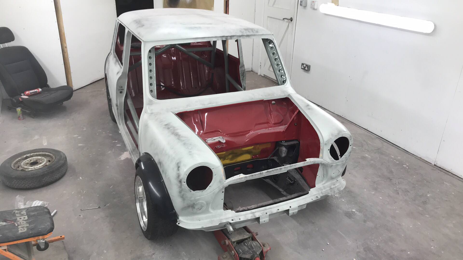

Got a few photos sent through on Friday night of the shell in primer, hopefully have it home in few weeks.

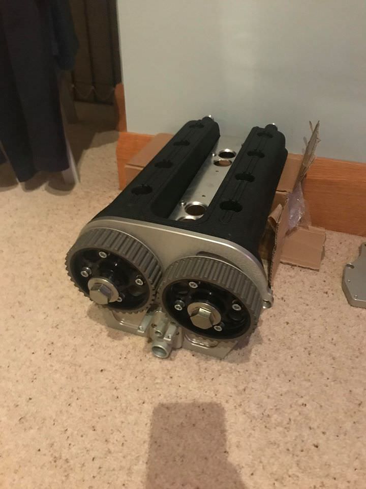

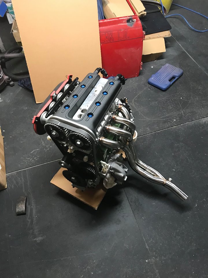

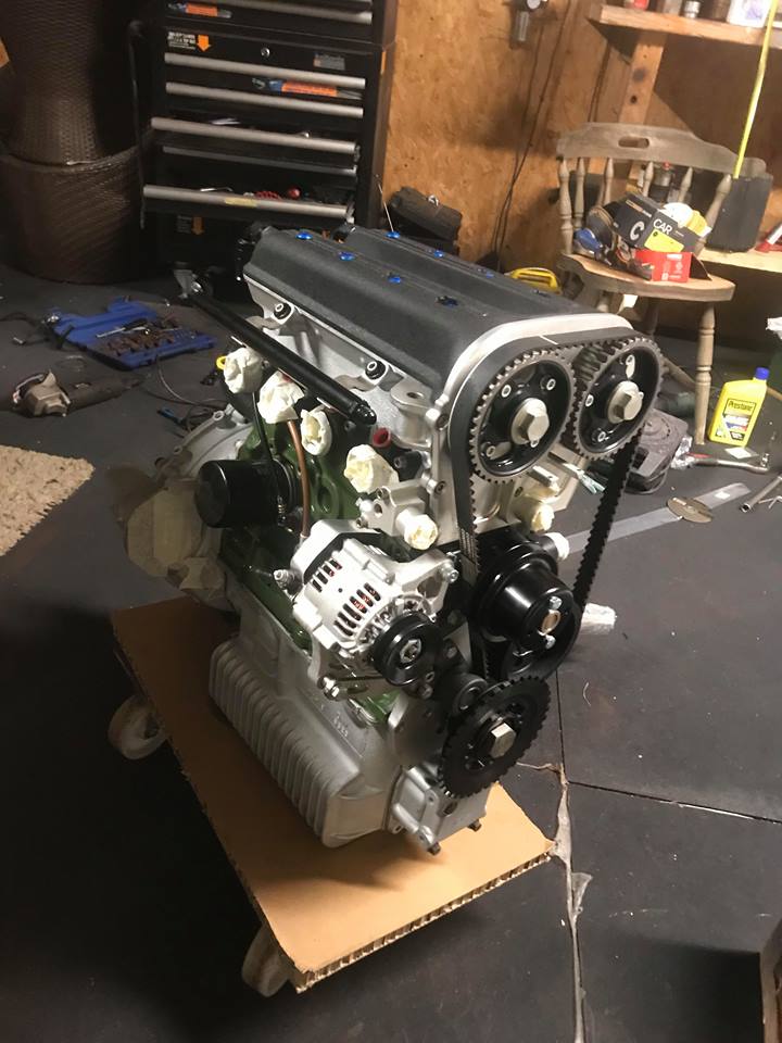

Few photos from SC of the engine
Hope to have it back with me for Friday along with few other parts for the build, all being well I hope to have it all together by end of the month.

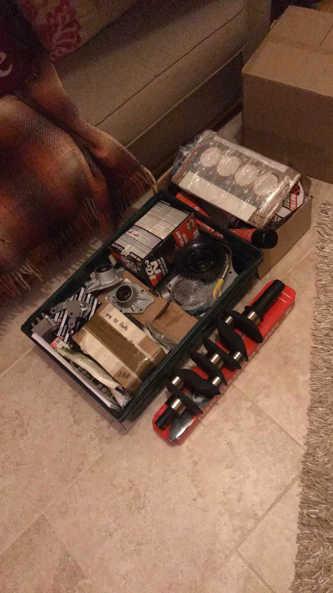

Engine wise I've been collecting some of the smaller bits to finish the build, left to get is an oil pump and a centre main strap

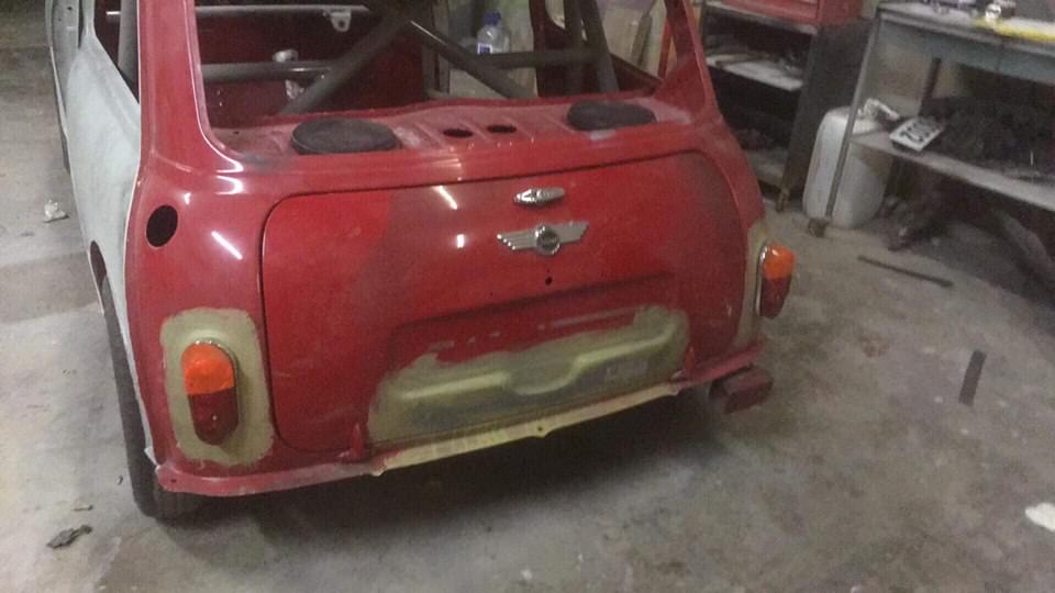

Shell wise I have been waiting for a fella to do a mk1 conversion on the rear, This guy is a bit of a mini legend and metal work genius so I had to wait on him to have some free time
Left to do is remove the late badge, and weld up the final holes.

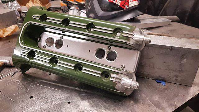

Also took the chance to have the rocker cover modified for some extra breathing, had a buddy weld some an fittings into the end, the cover will get powder coated and the fins polished. As a final detail I wanted a spark plug cover made to mount a plaque to thank my mate and his company for all the support, it will be mounted in the middle.

Got my rocker cover back from powder coating, all i need to do is polish up the fins on it.
Some of the final engine bits arrived
Just waiting on another set of mains bearings, last 2 sets have turned up new in box with marking. Anyone ive spoke to has said they have never saw it so I ended up ordering another set as im getting a bit fed up waiting. All being well we can bolt it together Monday.

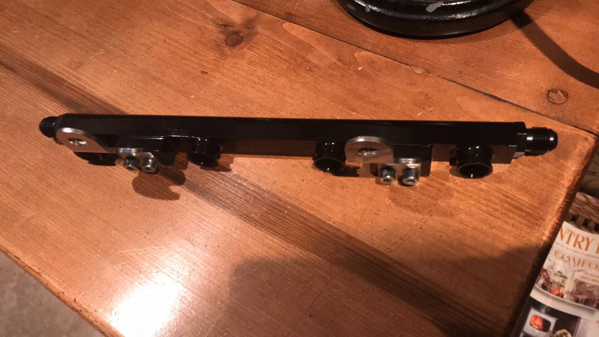

Also opted for a billet fuel rail, I will run this with black fittings and line for a nice tidy stealth look

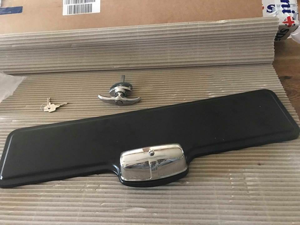

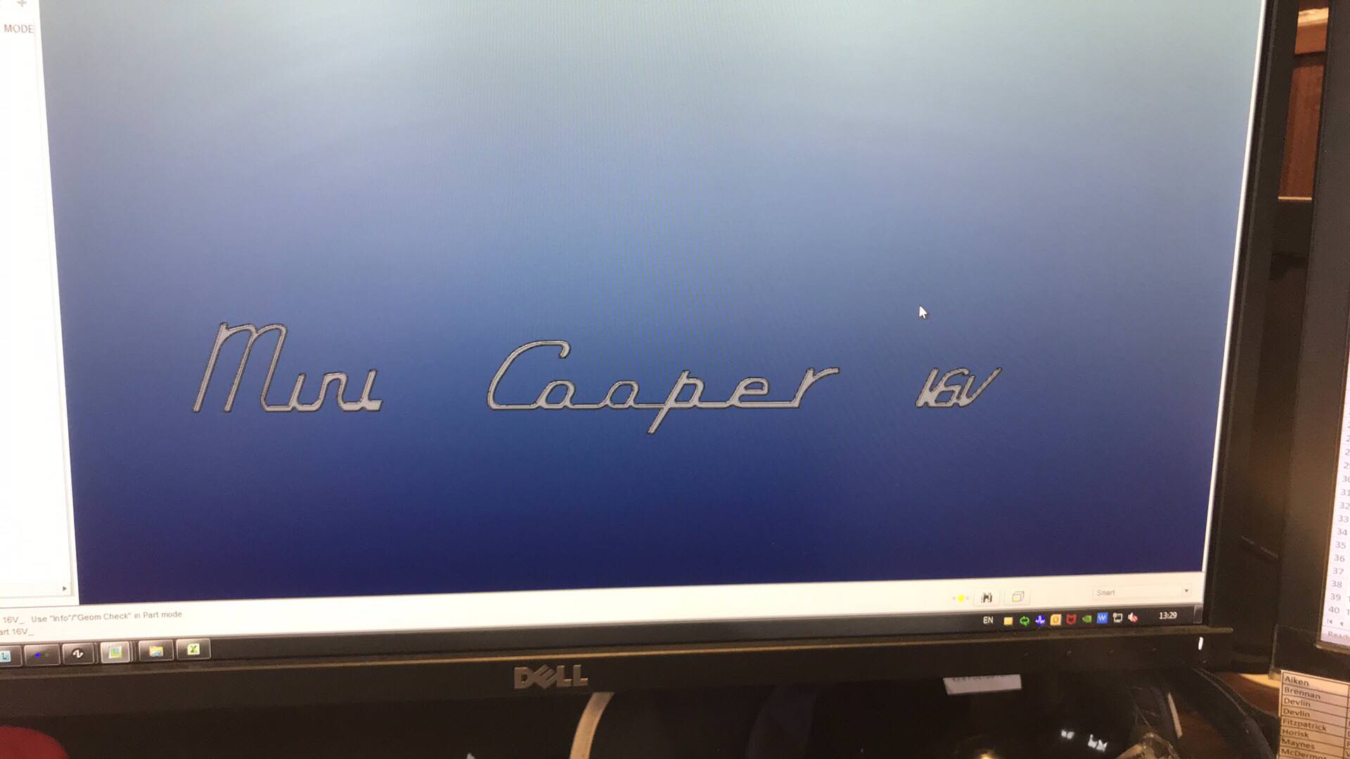

And lastly a wee side project I have been working on to add a finishing touch once its all done. Im going to have a friend 3d print this for me to mount on the boot as per the original austin cooper badge was.

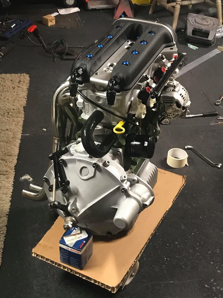

Been a while since my last post, now have this finished waiting to drop in. Few things to finish off but im most of the way there
Cheers for looking

I hope it goes as well as it looks anyway, have a few things left to make for it including a fill point/breather and a second mount for the alternator to suit the mpi block.
As for radiator, once I get the engine back in the shell for the final time with all the aux parts on I will confirm how much room ive got then most likely have one made to the max size. I did mock a fiat cinq on up before but its not going to fit well so it was binned after i tried to curve it to sit closer to the front grill.

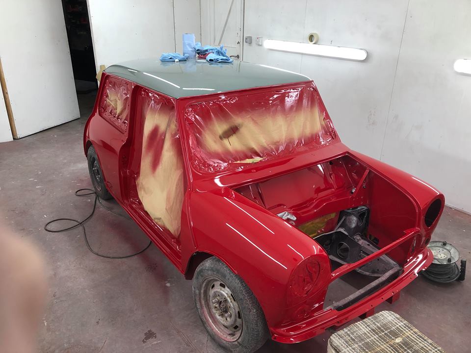

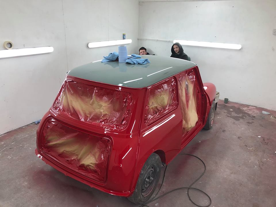

After a long wait my shell has now been painted, wanted to do something a little bit different so instead of a white, silver or black roof I opted to go with BMC Tweed grey hoping it would look a bit more retro
Personally im over the moon with the outcome, my mate made a brilliant job on it. Should hopefully have my doors and boot by the end of the month also.

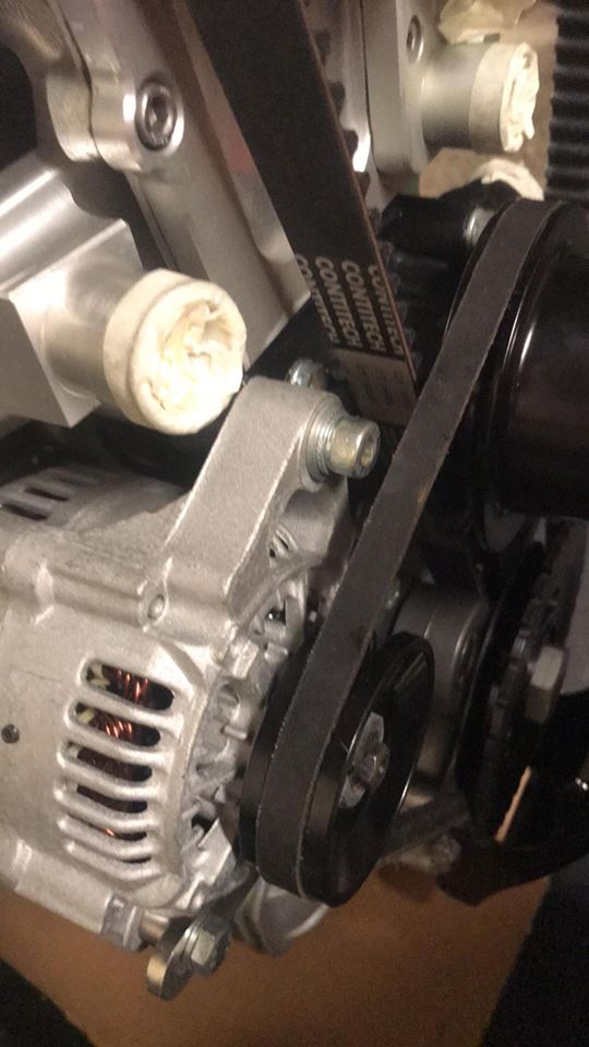

On the engine side of things I had to have some parts of the belt drive side of things machined to solve the tracking issue, I also fitted up the alternator etc to check it.
Its not far of being ready to drop in now, few small blank plates to make to block of old sensors on the mpi block, Also need to get a small catch tank made to fit above the transfer case and plum the cam cover breathers to.
