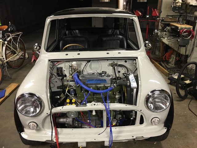

With this help of my GF I got the engine in last night and was really happy to find that there was PLENTY of clearance for the GT1548. I'll still run a longer engine steady but it doesn't seem like I'll really need to push the whole thing that far forward. Sweet!

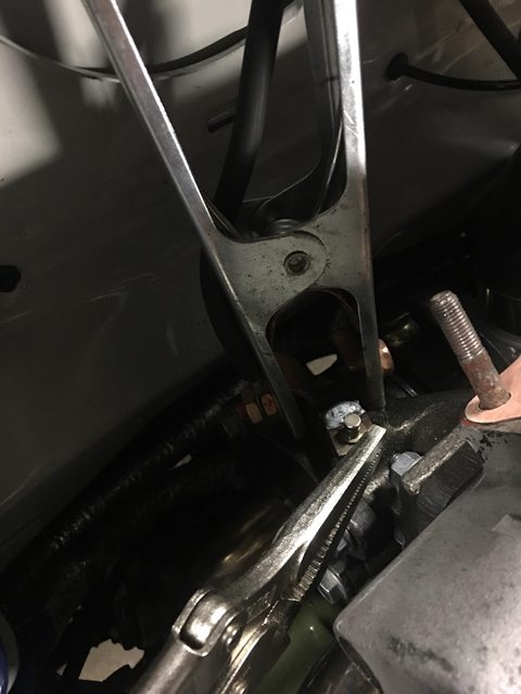

I did find that I needed to adjust the bracket for the actuator and in messing around back there I broke off my welded on tab. Definitely a bummer since it's pretty hard to access with the engine in but I was able to get in there with the MIG and weld it back on. Hopefully this holds a little better.

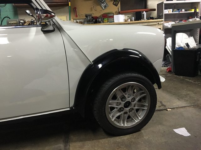

One thing I noticed is that the front end is sitting pretty high. I've got new cones and hi-los fitted with the adjustment all the way down but still looks a bit like a 4x4. How much settling is expected? This seems pretty high for the lowest setting even if there is still some settling. Will it settle on it's own weight or will I need to drive?
the new cones will settle in time but I've known a few people that have had to machine a little off the hilo to get it a bit lower. Mine is currently running without the locknuts to get it sitting right
PhilR
696 Posts
Member #: 10034
Birmingham
I had to cut the bolt head part off the hi-lo (keeping the locknuts), then adjust height from the top side. It was never going to settle as much as I needed it to.

Dang! That's pretty disappointing about the hi-los maybe needing some mods to get them low enough. Seems like removing the locknut will get me pretty far. Just getting the engine in and sitting on the wheels seems like it helped it settle a bit. I'll drive it a bit and then lock into taking the locknuts out.
Rear end looks fine. I haven't had the car on the wheels in a while. I forgot how small and low it is!

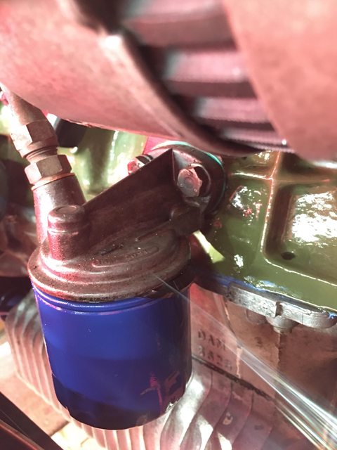

My starting problems largely came down to the plug leads being swapped. Solved that pretty quickly, started right up and then...POP! Filter oil filter seal burst.
Whoops!
Turns out I had plugged the back pressure valve for the pressure relief valve and prevented it from operating. Sorted that out today and got the car started.

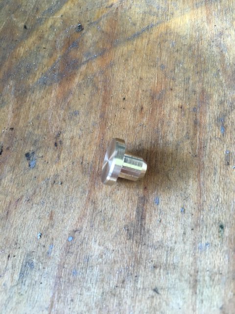

The passageway from the plenum to the carb was pretty junked up so I cleaned that up, put the carb back together and made some new blanking plugs (instead of screws) for the extra ports. No fuel seeping out of the jet and it started up just fine!

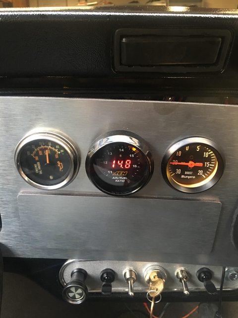

Took a bit of time for the idle to settle down and I had the fast idle set pretty high (just about 2k) which was actually pretty convenient. The fueling was a bit wonky so I had to play with that until to get it to run nicely without choke. The wideband makes that pretty easy! Don't mind the pressure gauge alignment, its only temporary.
