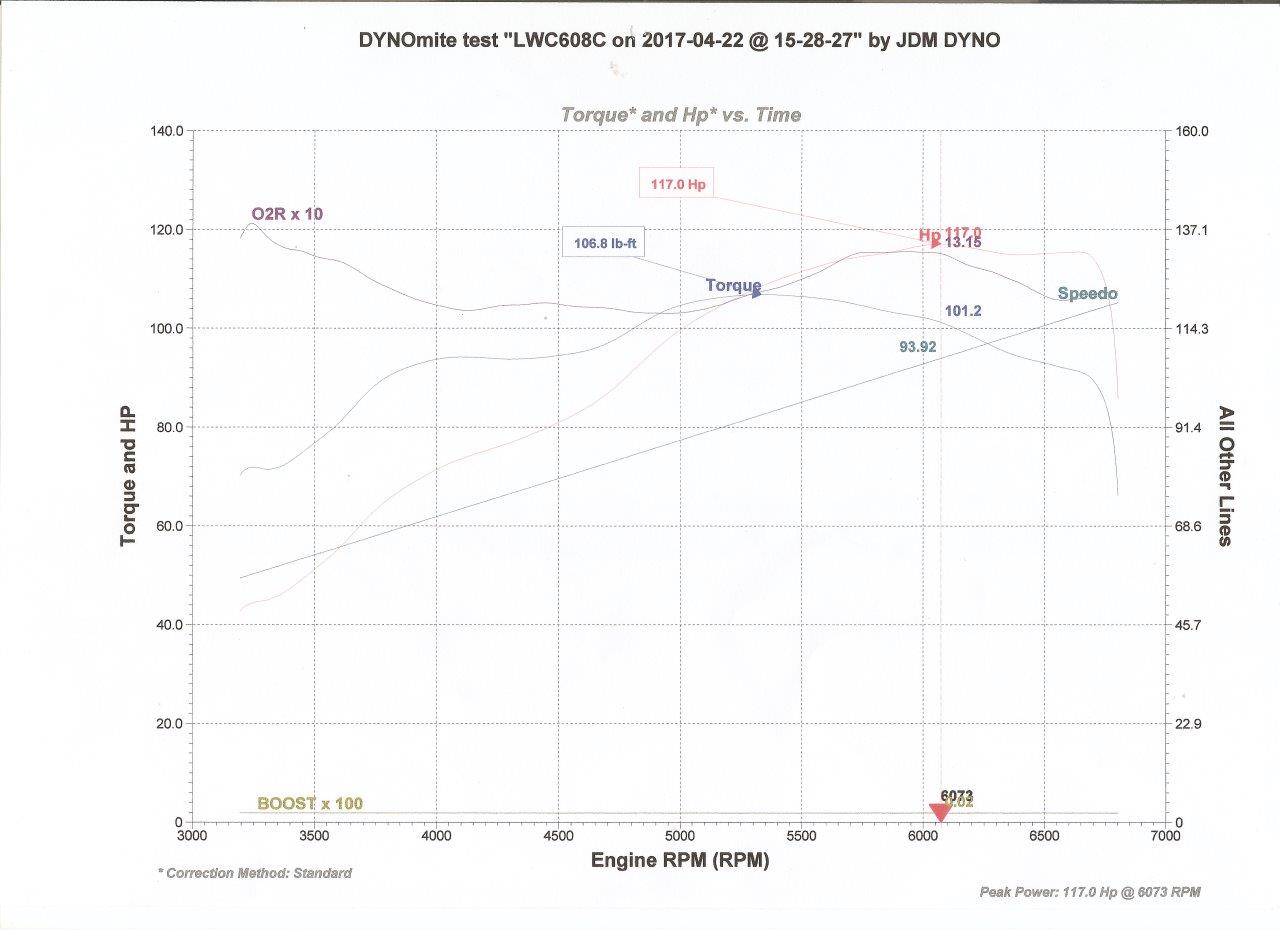

First dyno sesh came to an abrupt halt when the fuel pump failed. So I've fitted a Walbro 255 to replace the original mpi pump, also fitted a new regulator with gauge so i can monitor it easily.
Then back to JDM dyno this weekend gone, I also was paranoid about the injectors being too small so refitted the big 630's, this meant a lot of time redoing all the fuel mapping as the figures were now all to cock.
At the end of the afternoon the figures were 117bhp and 107 lbft.
https://www.youtube.com/watch?v=WYiNOAEn96Q
I've plotted the torque figures onto the minisport graph (I know different dynos!) to see how they compare, I'm up mid range but down at the lower end but both graphs follow the same shape.
Its a good start but i feel theres more to come with manipulating the injection points later in the year.
All plugs are showing a nice even mixture, perhaps looking a tiny bit rich but better than lean!
I'll try and get the graphs on here shortly.
