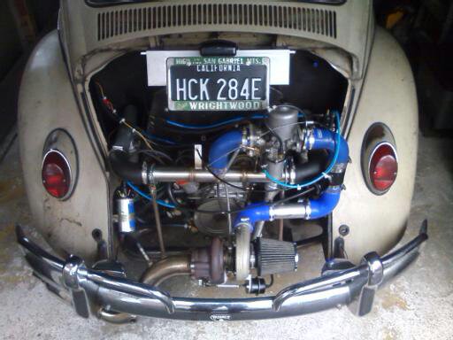

Hi Guys, I'm rubbish at putting up pics, when I do via photo bucket they cover it up with an update message. I could email it to someone on here. I'll take a close up pic of the carb and pipe work and send it to one of you guys on here.
So My reg is a Malpassi FPR014 There black if anyone wants have a look.
Wil. I don't think the restrictor is doing its job. I could be wrong but I think at the moment I have an amount of pressure in the bowl that is equal to the inside of the carb. If I had enough pressure in the float bowl under boost fuel would push UP and OUT of the jet to stop me going lean. My needle has been thinned out also.

Adding images:

Done. I need a close up really

Hey Thanks Dave for putting the pic up. I do wonder if I will ever get it right. At the moment when I drive it I feel that it is close. It takes off from a stand still really good The front rising to the shock limit. Then no more fuel. I'll keep trying different ways for a bit longer ,Then I'll try a different carb.
Is that blue elbow on the vacuum side of the carb a rigid pipe or a soft hose? what about the two black elbows on the plenums?
because if they are they'll probably suck flatter than a witches tit.
I do think it needs a real plenum once you get the fueling right.
also we need close ups so we can actuially see whats going on.

Hi Sprocket. The 90 degree black elbows are fairly rigid, The blue 90 in front of the carb is softer and with vacuum is it goes suck in on itself. I am going to fix this once I get the fuel working. Good spot.
