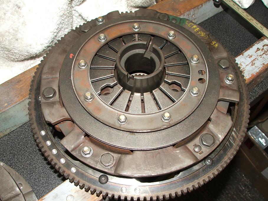

Bumping this as I have a similar issue...well in terms of design, and clutch "specialists" seem totally useless.
My pressure plate uses rivets, and the heads of a couple have started to bend upwards. It's been like that for a while and hasnt seemed to get worse. But clearly it needs resolved. Design is the same.
So are the rivets made of anything special ? Will HT caps be as strong, or stronger ? Where the fixings you guys used custom, or off the shelf ?
Generally speaking, these mostly only see tension loadings and a little bending ?
So cap screws may even be much stronger ?
Did you tap the cover, or use nuts to secure ? I appear to have plenty of room to use this method of repair.

yes steve, just tapped the body, the std rivets were fairly soft, similar to normal bolts at a guess, i think whacking some car heads in yours should do the trick.

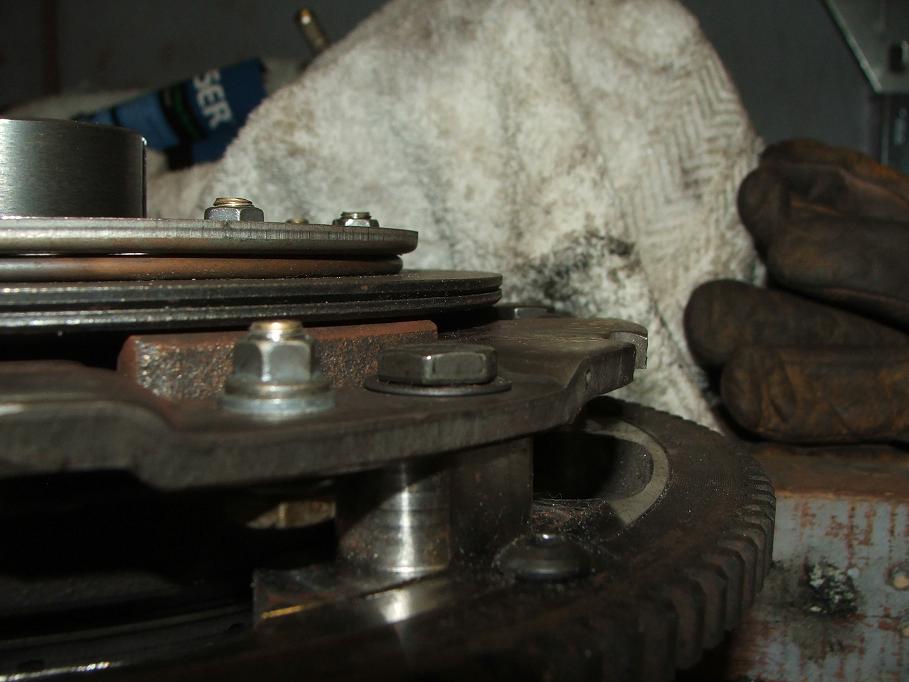

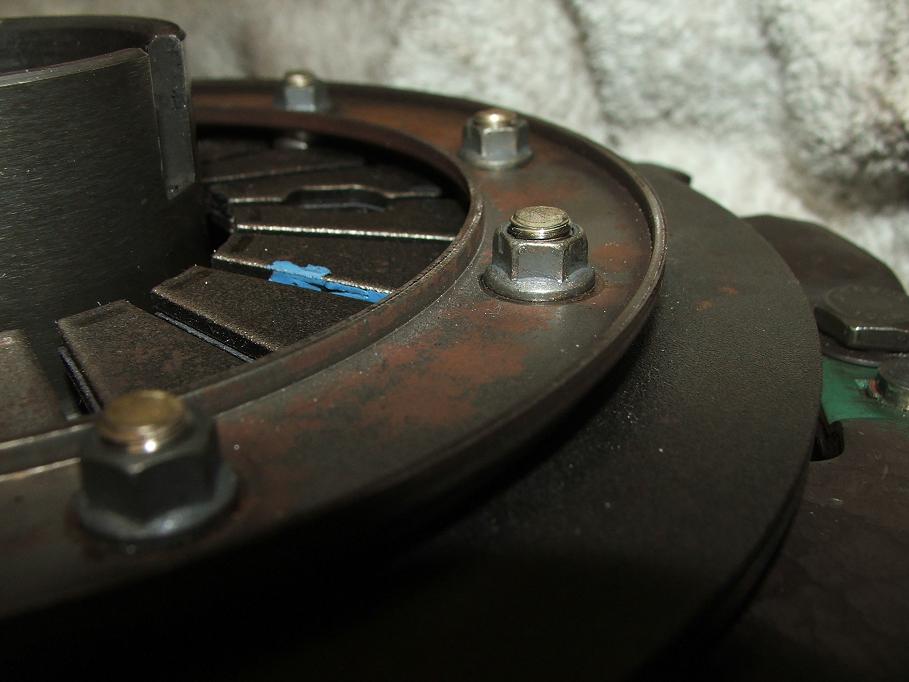

Stevie,
I use Unbrako shoulder screws, hardened steel washers, tapped the cover and fitted locking nuts.
http://www.unbrako.com/standards.htm
There are other ways of doing it.

Looking at it...
it seems the big round head is 18mm diameter. The smooth body where it passes through must be 9mm. That is the gap it has to pass through.
Unsure of actual height yet, as havent removed a rivet yet.
So I think M8x1.0mm with a peened style locking nut on the bottom ?
That should allow it do bolt down tight to a dead end at the 9mm, even if it is only a small step to the M8 thread ?
Ive a contact who can make me some custom bolts to exact dimensions.
Although those shoulder screws look more than ideal if they came in the correct dimensions. I think I'd prefer not to have to use a lot of washers ? Although guess it shouldnt cause any problems ?
What other ways did you have in mind ? I'm open to all suggestions that dont cost a fortune !
Where did you source the bolts from ? That unbrake website direct ?
Both Helix and Superclutch basically said they could do nothing. That I found unbelievable.

I just spoke to the supplier there, and he's happy enough with the bolt repair option. Or he can send me new rivets. TBH I think the bolt repair will be a stronger job, given the original rivets have bent.
As for the friction disc that has rotated on it's rivets. I need to drill them out and see if there is any damaged to the holes.
I can get that riveted locally though. Or if I'm not happy that it can be riveted he'll send me out a new disc. Only 1 disc of the 3 has moved.
All in all, I think I'll come out of it without costing a huge sum of money. Just trying to hunt down some M8x1.0mm locking nuts or K-nuts.
Given the relatively thin metal, I think I am correct to opt for a fine thread when tapping ? I can find normal M8x1.0mm nuts ok. At a push, can use those with a locking compound, but would prefer an interference nut

i think, if you can steve , i'd put a nut on the bolt ,then thread it through ,then a nut on the other side ,so it doesnt tilt .
yes an unbrako wil be far stronger than the rivet .i have around .5.. play on the shank to the diaphragm spring sides ,and its been fine . i prefer to have a bit of play and let the cone spring centre itself .
