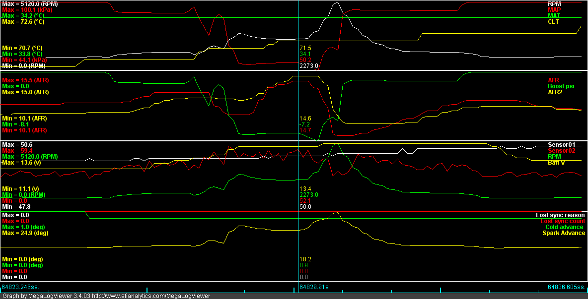

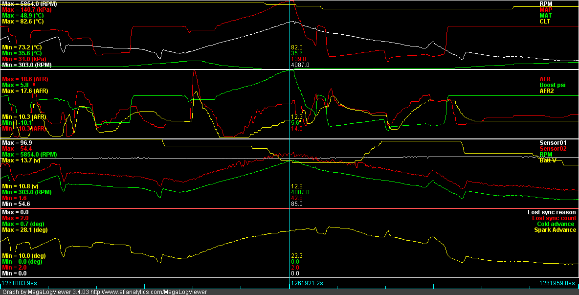

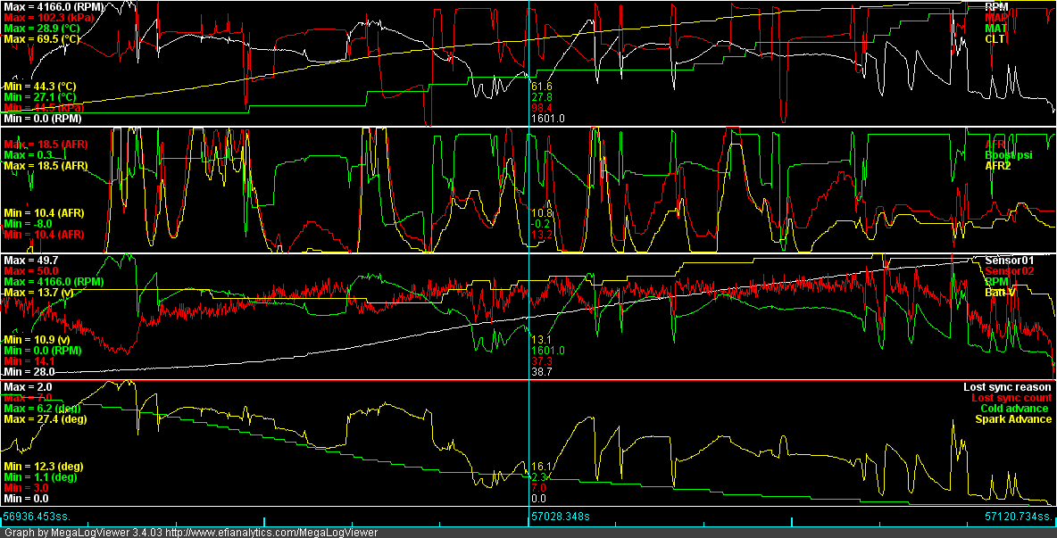

ok so took it for a short road test and well it dies when boost is about to come in it felt like the ignition got turned off so went back home
looked at the log and well the afr is wank its all over the place
its hard for me to tell but it looks like it goes lean before the revs climb i really need to sort a TPS to give a better idea on what the throttle is doing
but anyway i think this is caused by me having the carb bowl vent open to atmosphere now this "should be blocked off" but i did that and the thing ether got zero fuel and wouldn't run and some times fuddled the engine so i un blocked it and it ran fine but seems when boost come in it pushes the fuel back into the bowl down the jet tube?
so what i did was "t" the bowl vent into the plenum/fuel reg signal line now i took a log altho not driving just gave the clutch a hard time with the hand brake on in like 3rd gear not good i know but couldn't go out for a propa run anyways under that little bit of load and rpm it seams its now not going lean like it was but this is guess work really i need to get it back out and go for a roll down the road
not sure i might try blanking it off again like most people do and what is recomended as when i had it blanked off and had the under/over fuel problem i had just fired the car up for the first time and it was all day the lines carb litrialy just put fuel in the tank set the regulator and turned the key so maby there was some stupid air lock going on it the bowl as the jet is submerged in the bowl and i think the fuel pumped in untill the jet was covered but because there was air traped in the top the fuel just pushed out the jet tube and didnt fill the bowl to lift the float?? just by theroy that the air got traped in the top and wouldent let the bowl fill to lift and close the needle and seat but the float stayed down and pumped fuel out the jet tube
maby now its full and the float is where it should be it maby be ok to block the thing off? donno
i wana try the T as i think the bowl should beable to vent so if it works ill run it like that
edit actualy i think i might try a run down the road with the boost pipe disconected to rule out the fuleing over all and see that it is caused but the effecs of boost comeing on

well we have boost *Clapping* only 5-6 pound (current Watergate spring) cant wait to get this cylinder head finished and get the thing tuned up and add some more boost
seems i might need to rearrange the charge cooler rad or make it so either MAT or CLT can turn the fan on and pull the temp down it dose lose MAT in a reasonable time when the car gets moveing it drops to with in a few degrees of ambient so pleased with that i guess
need more road testing really to say if im going to change it or leave it
for now ive just set the MAT ING curve to pull timing out when the MAT gets hotter than id like so just dosent make as much power when the MAT is up
AFR is still all over the place but that could be partly the oil there getting from the shit valve guides and seals
going to work on the head for the rest of the day and maby get it dropped into the shop for guides, seats and a face cut later in the week
seems the old T3 might get thrown in the bin for favor of a nice ball bearing one we will see
i need to learn a bit more about tuning with MS3X before i go fooling around in it anymore lots of fun but i dont want tears..
Edited by Turbo This.. on 16th Feb, 2015.
Good progress.
From the previous update (which I missed) you really do need to get TPS on the datalog.
From the very limited tests I did with a carb and dual widebands (a long time ago) I see pretty much the same, AFRs generally 1 - 1.5 apart one way around but occasionaly they converge or reverse.
In my case it was when the throttle was closed - which implies "sucked off wall" (the opposite of wall wetting) - but trying to guess what was happening to your throttle from RPM and MAP alone isn't easy.
Also, once you get the carb better setup the steady state offset should be easier to see which will make it easier to dial out once you switch to injection.
