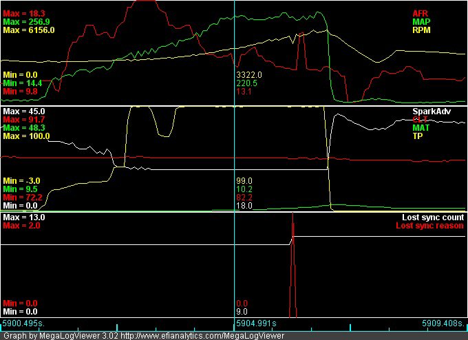

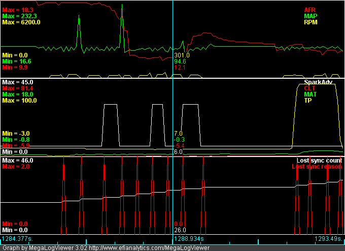

i have counted the gaps and peaks, it is counting every tooth however on he composite log it shows a few of them paired up

256Kpa !!!
7th Feb, 2012 at 03:56:16pm
I get 22.5psi If something is worth doing, it's worth doing half of. |
![]() 9502 Posts Member #: 1023 Post Whore Doncaster, South Yorkshire |
7th Feb, 2012 at 04:00:52pm
On 7th Feb, 2012 tadge44 said:
256Kpa !!! I make that 35psi+ - and it sounds very scary thats absolute so less about 14.7psi or in this case 103.7kpa as thats what the ambient pressure was Edited by Brett on 7th Feb, 2012. Yes i moved to the darkside |

Hey Brett. The jumping out of gear when agressively closing throttle could possibly be down to the engine rocking? If the engine is fixed well with lots of steadies (all with good condition bushes ect), it could well be in the gearbox. its got a solid rose jointed top steady, standard mounts, and mini spares gearbox steadys on the bottom both sides, although these will be replaced by some rose jointed ones as soon as i get spare cash, it does not have the one on the front that extends out to the subframe as i dont like it
im also thinking up something for the water pump side but its a little busy on that side of the engine bay it needs to be held in there tight when the inboard gear change gets fitted Yes i moved to the darkside |

Keep batting on Brett I'm,sure you ll sort the misfire, you going to York this easter? Audi s4 b5 - 470bhp & 486ft lbs

25th Mar, 2012 at 09:39:12pm
Have you tried just plumbing the actuator straight into the snail with some 6" long pipe? Just to eliminate the chance of kinked pipe/faulty valve?

On 25th Mar, 2012 bennyy said:
Have you tried just plumbing the actuator straight into the snail with some 6" long pipe? Just to eliminate the chance of kinked pipe/faulty valve? Ps the log goes straight over my head yep done, im going to plumb it too the same take of as the megasquirt tomorrow so i can be sure the snail port isnt giving a dodgy reading and try rig up my camera on the actuator so i can see whats going off dont get me wrong it will be running 20+psi boost eventually but i want that choice... also i cant exactly tune the needle to fuel for both 10 and 20psi... hence it gets leaner and leaner as the boost rises Yes i moved to the darkside |
