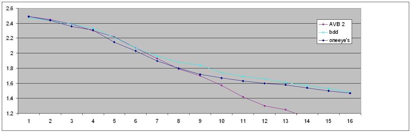

oneeye what needle are you using, or any idea of its curve?

Mines a modified standard needle. I could measure it if you like. 20/50 in the dashpot and standard spring.

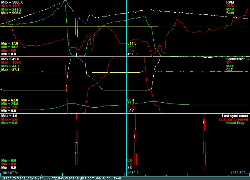

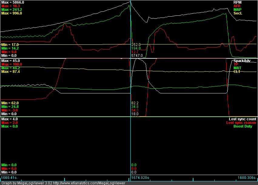

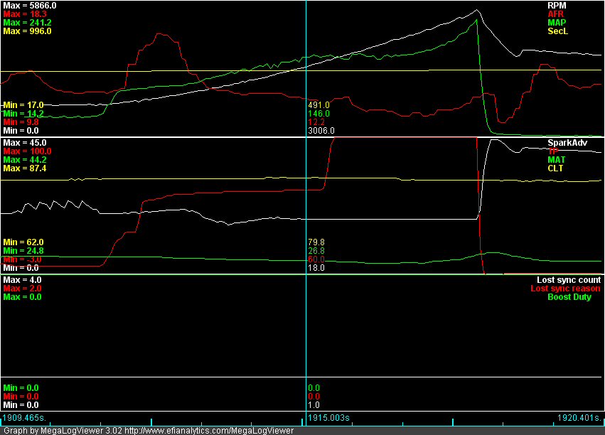

i have a half decent video being uploaded right now, shows gauges i managed to stick a couple boost creeps in there too and interestingly it shows up a revcounter problem i have never noticed
right here is the video,
http://youtu.be/hl-I2qYmYvQ
i am going to pick out some screen shots of the log, with a video ref so you can see and hear whats going off
this way you can share the TM experience *happy*
if you watch the rev counter closely it randomly flickers down, now im unsure if this is because of the sync loss or the cause of it but on the 3rd and 4th sync loss in that log the rpms dont fall to zero but the gauge does watch the video from 4:50 on... 5:00 is the 3rd sync loss and 5:03 is the 4th
however at no point in this video did i feel a misfire (or hear it)
and also show quite well the boost creep
starts from about 0.02s
from about 4:04 just after that corner

I'll have a measure of the needle tonight if I get a chance.

Measured at from top to bottom at 5mm (ish) intervals...
TopĀ - closest to carb
0.099
0.096
0.093
0.091
0.085
0.080
0.071
0.068
0.066
0.063
0.061
0.058
Bottom
Measurements in inches.

ive added your needle in and scaled it as best i can

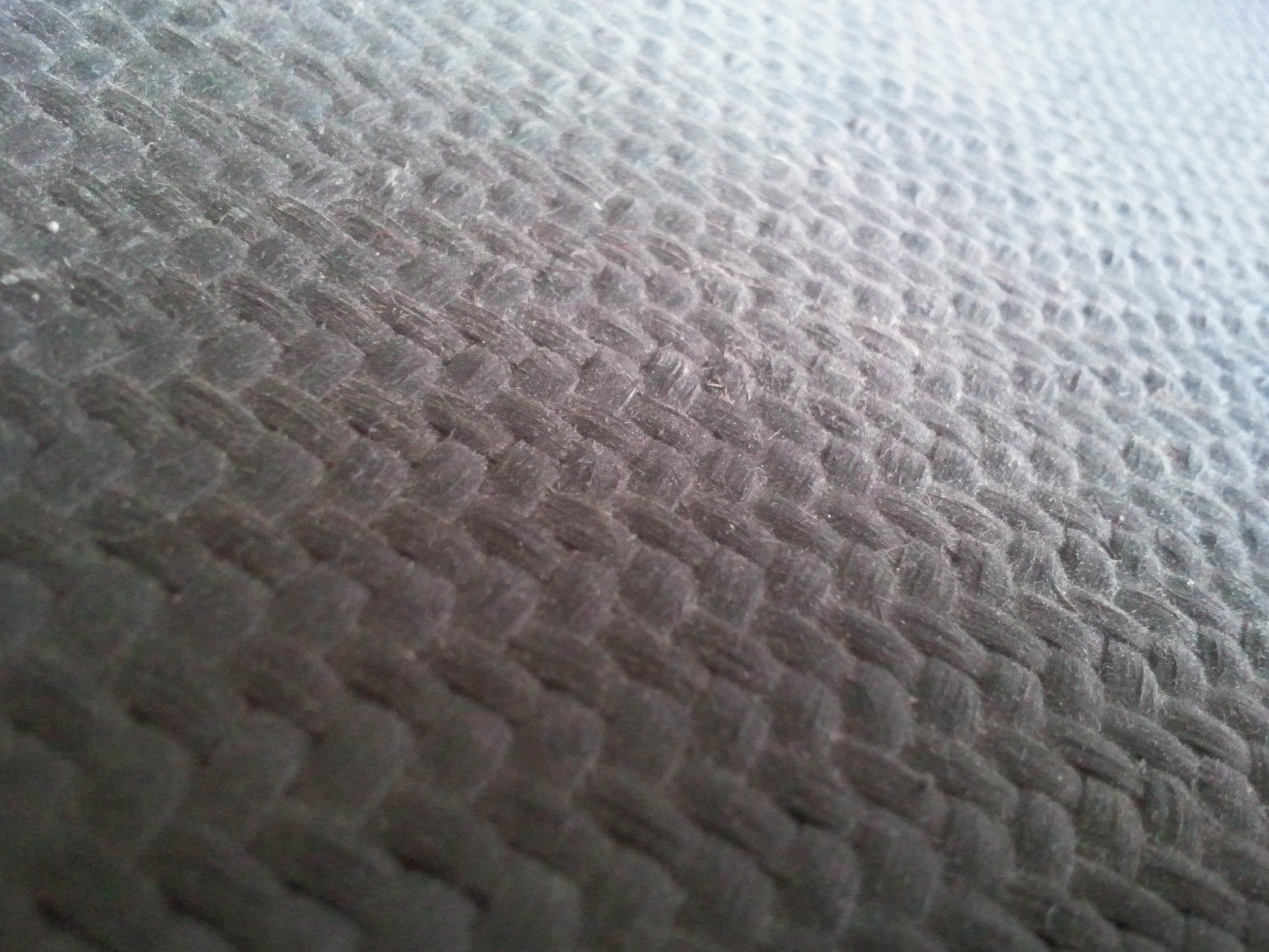

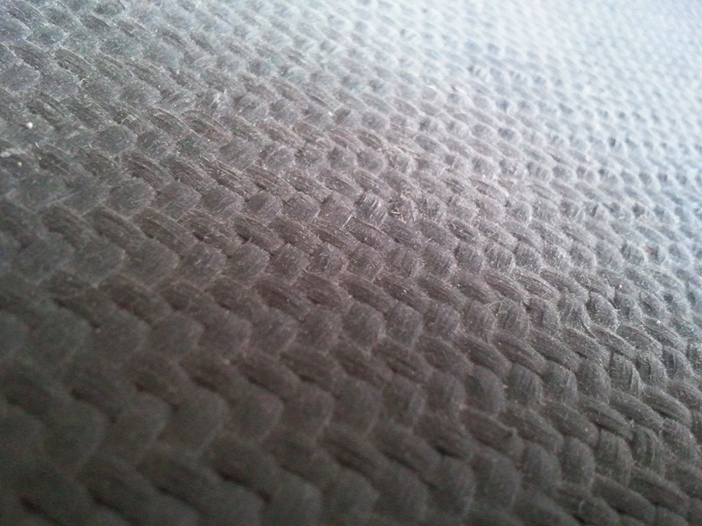

its the inside of my carbon boot lid, not sure how to seal it, looks like it will soak up water :/
it should be fine, but you can mix up a thin resin mix and pretty much paint it on.
